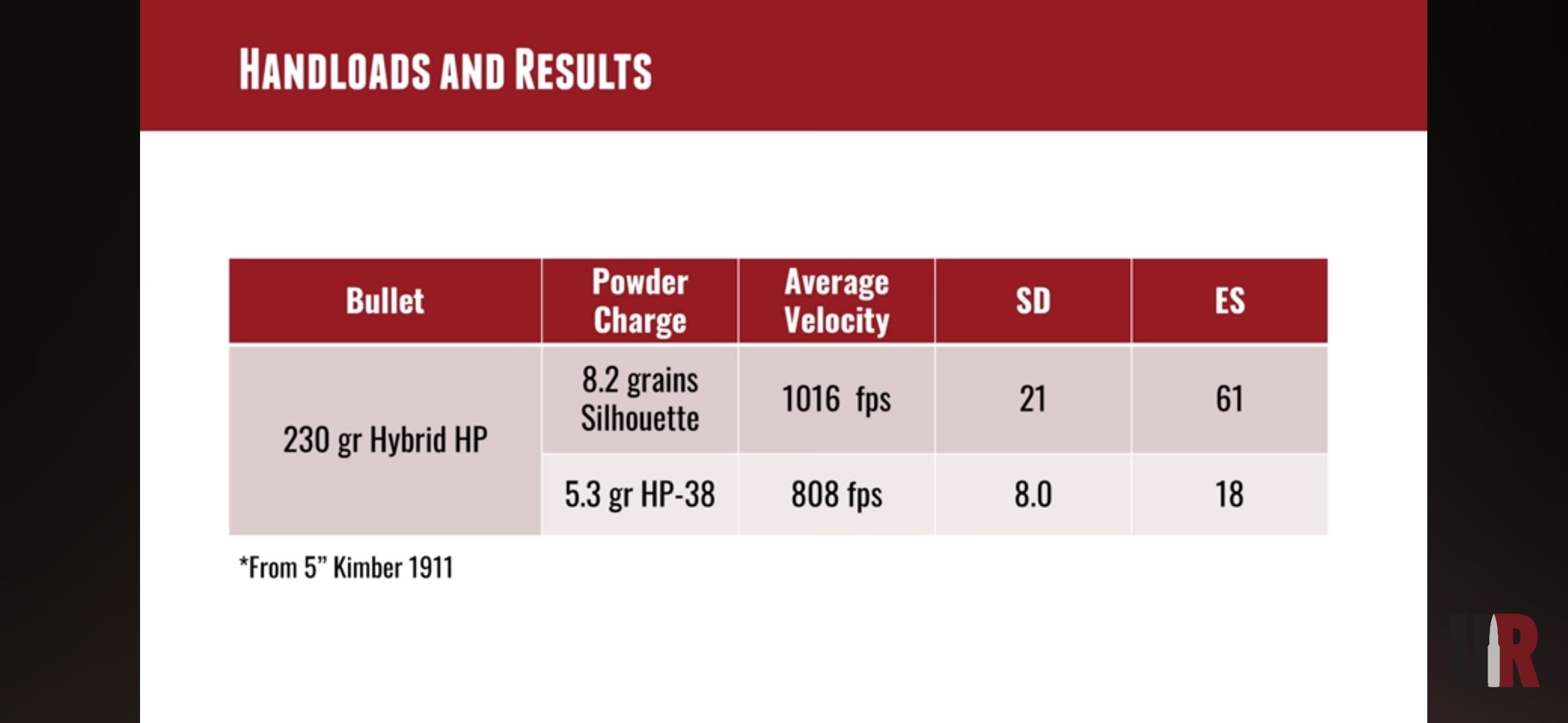

FHBrumb Bearcat Joined Sep 25, 2012 Messages 96 Jul 5, 2026 #121 I like the Silhouette load here: I use that one under the 230gr xtp. The Silhouette is my favorite. Mid 1100s, creeping up towards 1200 on a few.

FHBrumb Bearcat Joined Sep 25, 2012 Messages 96 Jul 5, 2026 #122 My next experiment will be Enforcer:
FHBrumb Bearcat Joined Sep 25, 2012 Messages 96 Jul 6, 2026 #123 In my carbine, five shot strings: 230gr XTP- Bullseye 6.0gr 950fps Silhouette 8.2gr 1150fps Enforcer 14.5gr 1285fps 230gr xtp 45 Super- AA#7 13.5gr 1441fps (In 45 Super brass with CCI #350) Thats about 1061 ft/lbs from this small carbine.
