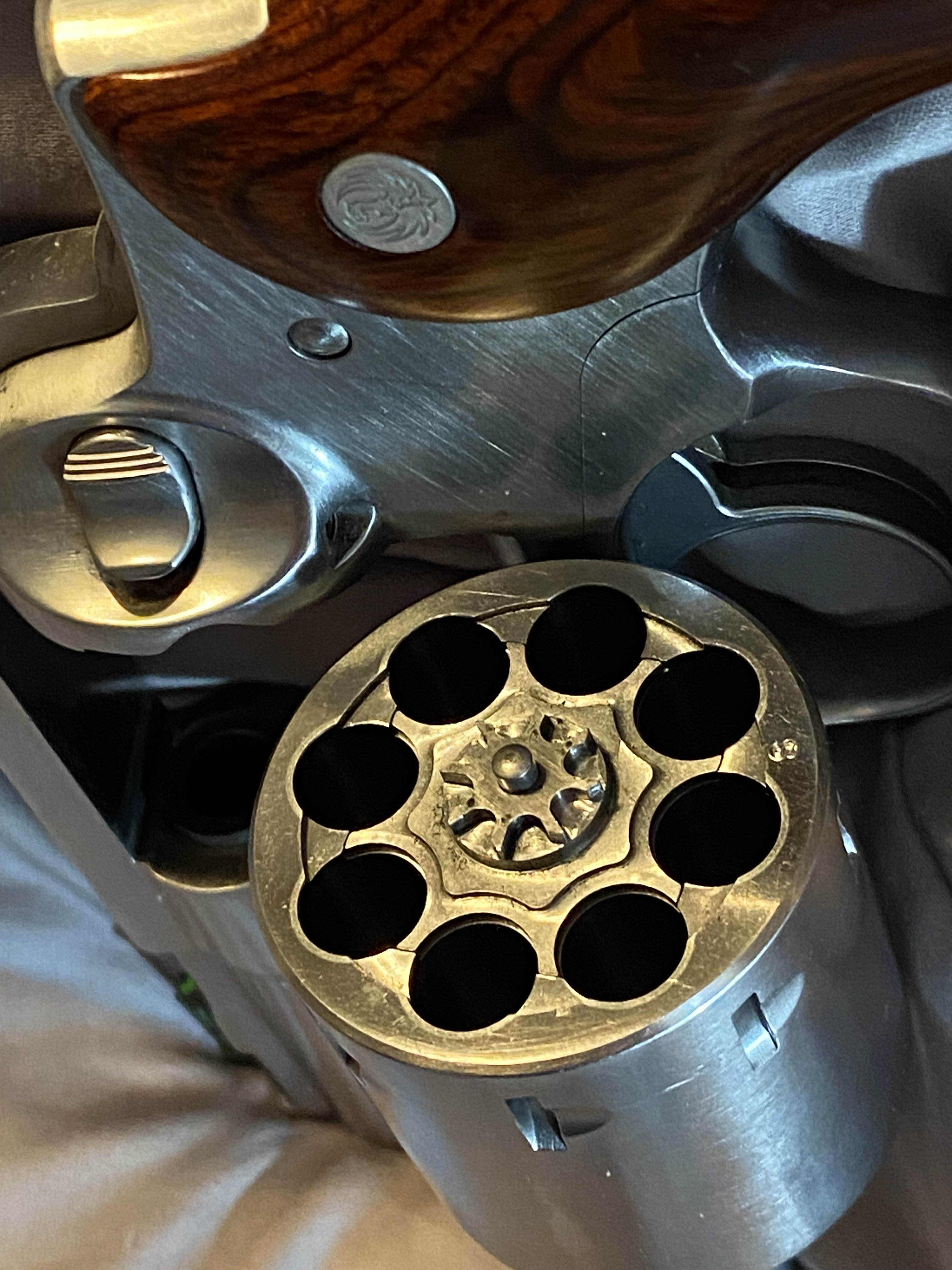

Have a question for any owners of a Redhawk 8 shot .357. I got a new one and the machining of the rear of the cylinder just doesn't look correct to me. Would like someone to take a picture of theirs to compare mine to.
Here is what mine looks like:
Notice the cartridge head is not completely supported. Almost looks as though the rear of the cylinder wasn't milled correctly. I sent an email/photos to Ruger after talking to customer service but haven't heard back from them yet. The end of the ejector rod (where cartridge is sitting) doesn't look quite right also.
I didn't think about that and now I'm thinking that is what Ruger will tell me. Plus I'll go on the Ruger site and see what is shown (DUH!, should have done that first, just wasn't thinking)
Thanks.
Just looked at the spec sheet on the Ruger site and it said nothing about moon clips for the 2 3/4" model but it did (last entry) for the 4 " model. Guess they forgot to put it in the specs for the short barrel. There were NO moon clips in the box with mine so I'll call Ruger CS back and say sorry, I screwed up.

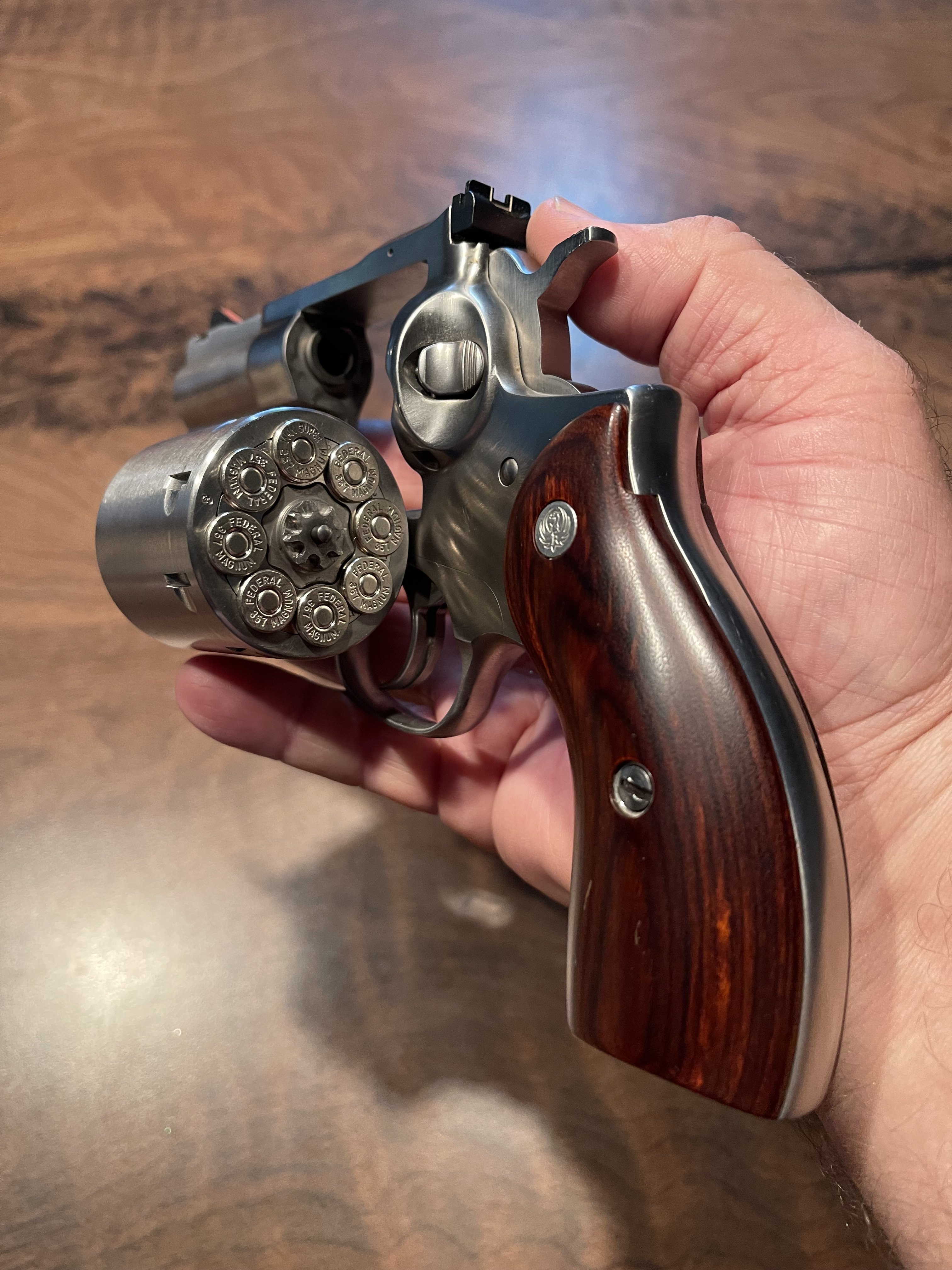

Mine does not have that, but I bought mine as soon as I heard about them, so it's gotta be a newer development.
Interesting..🤔
Obviously some of the earliest production weren't machined for them.
A friend of mine has one that he purchased within a few months of release, and it's cut for the clips. He's brought it out to my place to shoot a few times, and it does just fine with or without them.

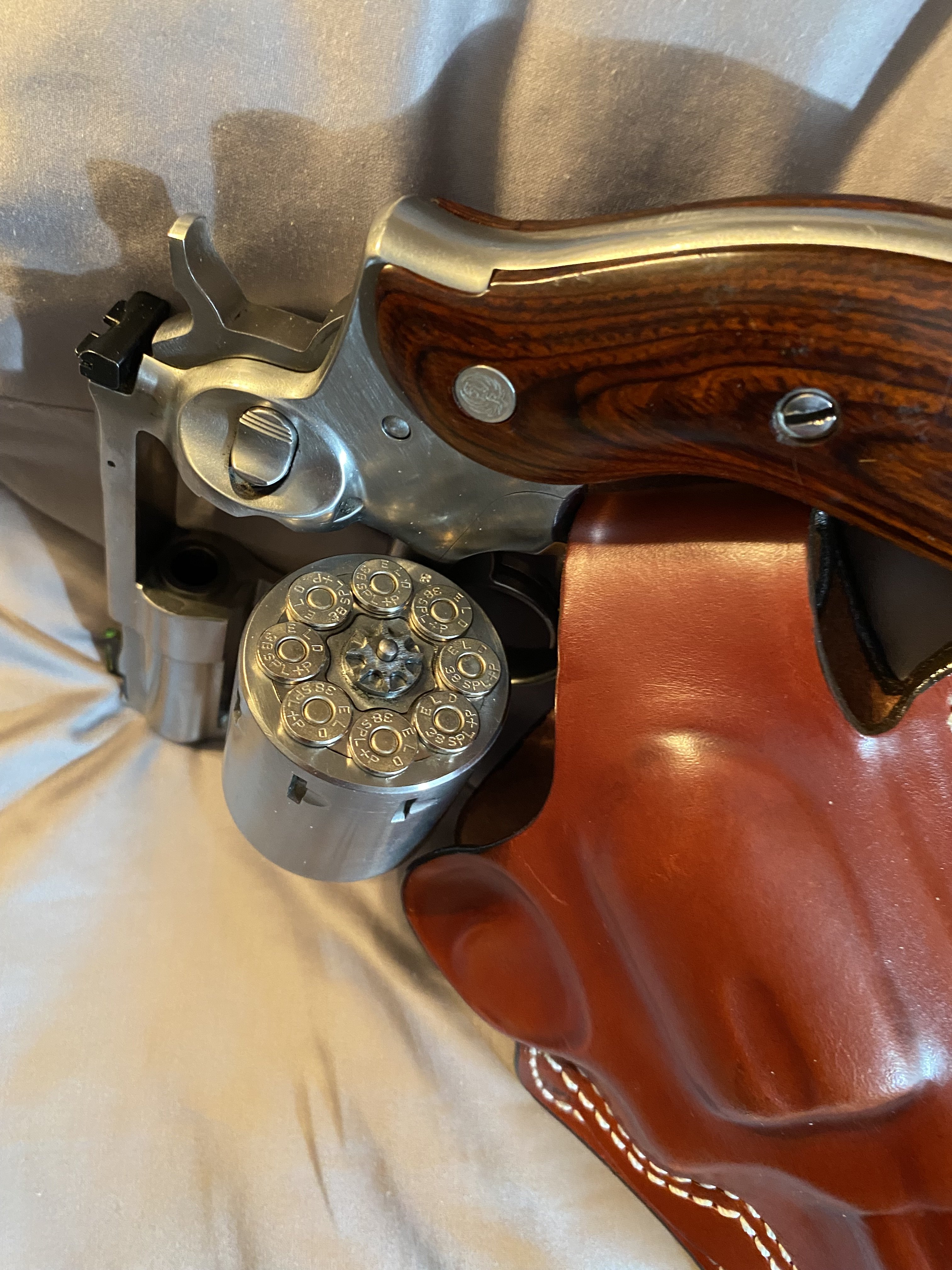

Mine has the cut but I primarily use speedloaders. Its never been an issuse....I too had the same concern. My smiths with moon clip cut do not protrude like that

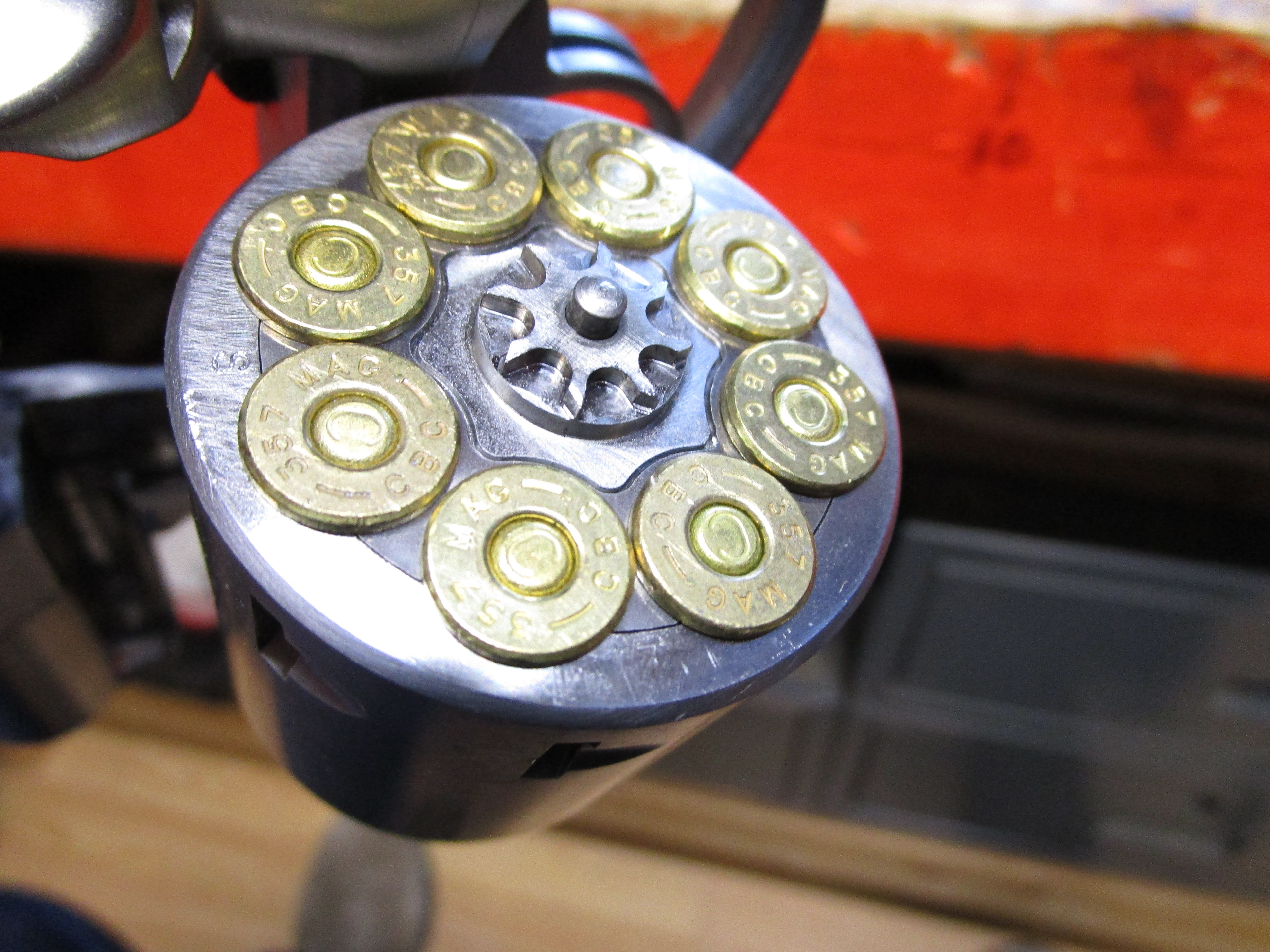

    1.7 MB

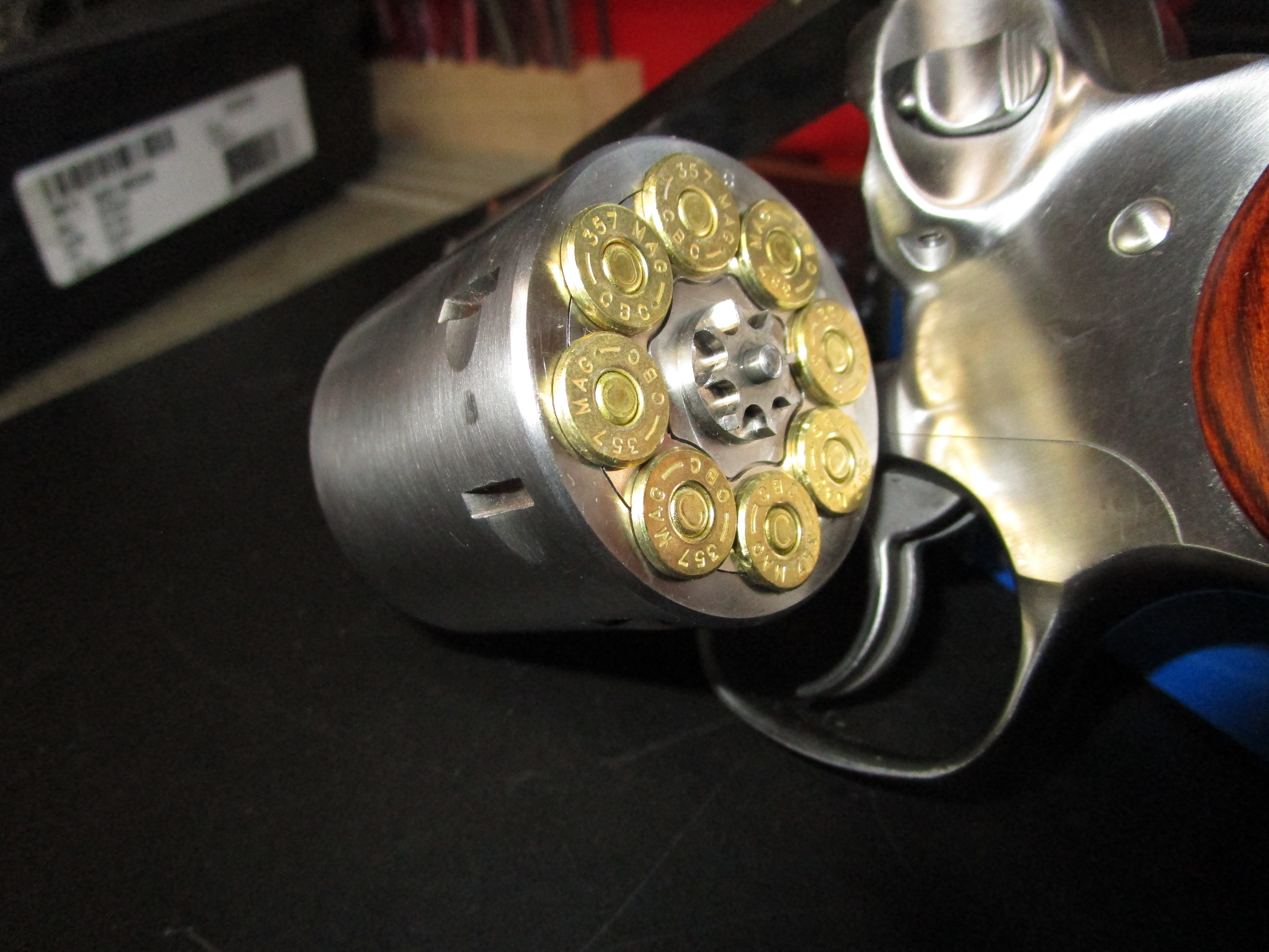

It’s all of them. The star doesn’t sit flush. The cylinder isn’t machined deep enough
I called Ruger. They won’t send a call tag. So shipping is on me. I’m not sure its worth it. I use speed loaders anyway. Still mulling it over.
Your picture was helpful to me. See how there is a space between the rim and the star? Mine doesn’t have that space.
I used to think moon clips were a PIA to load. Then I got the tools to do it correctly. Now,, it's easy & NO WORRIES! And de-mooning the clips with a tool makes that easy too.
eveled,, are your moon clips Ruger factory or another brand? Some brands are "thicker" than other brands.
They are Ruger clips it came with .025” thick. Which is what shopRuger says they should be. I tried my S&W ones they are the same.
I think I have it sorted out. Took a magnifying lamp and some diamond files to get the star to sit more or less flush.

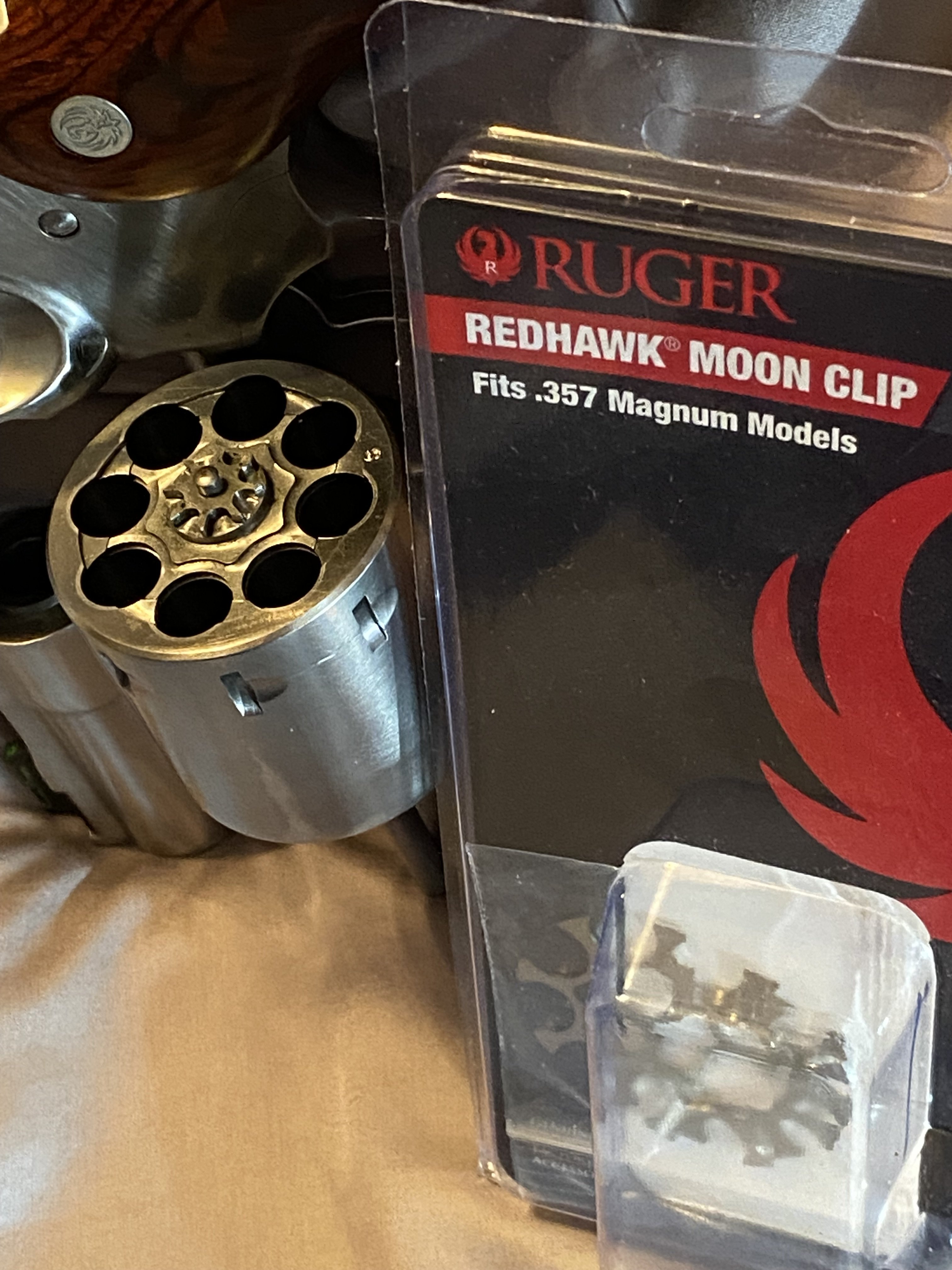

Well, the moon clips that Ruger said they'd send arrived this morning. They sent me 2 packs of 3 each. That was a nice surprise, was only expecting one pack of 3 as that is what comes with the revolver. Just now loaded one up with 8 rounds and it was easy to load and unload (I could unload with my fingernail but they were loaded rounds.) We'll see how it goes once I get out and shoot it :) . I'm quite happy with it.
