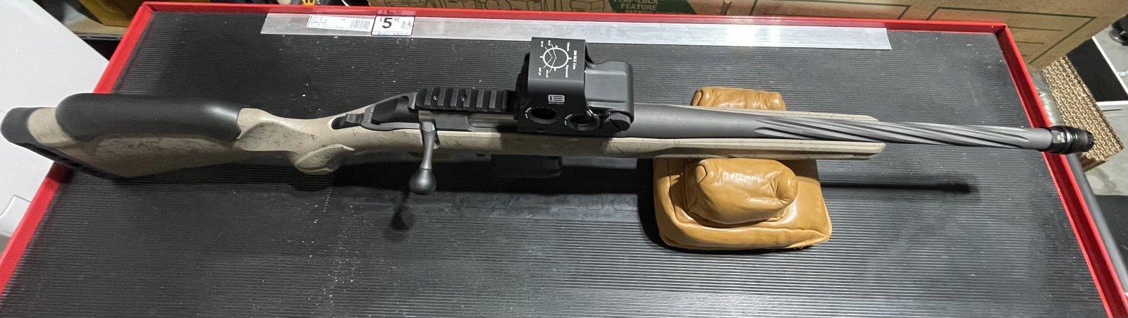

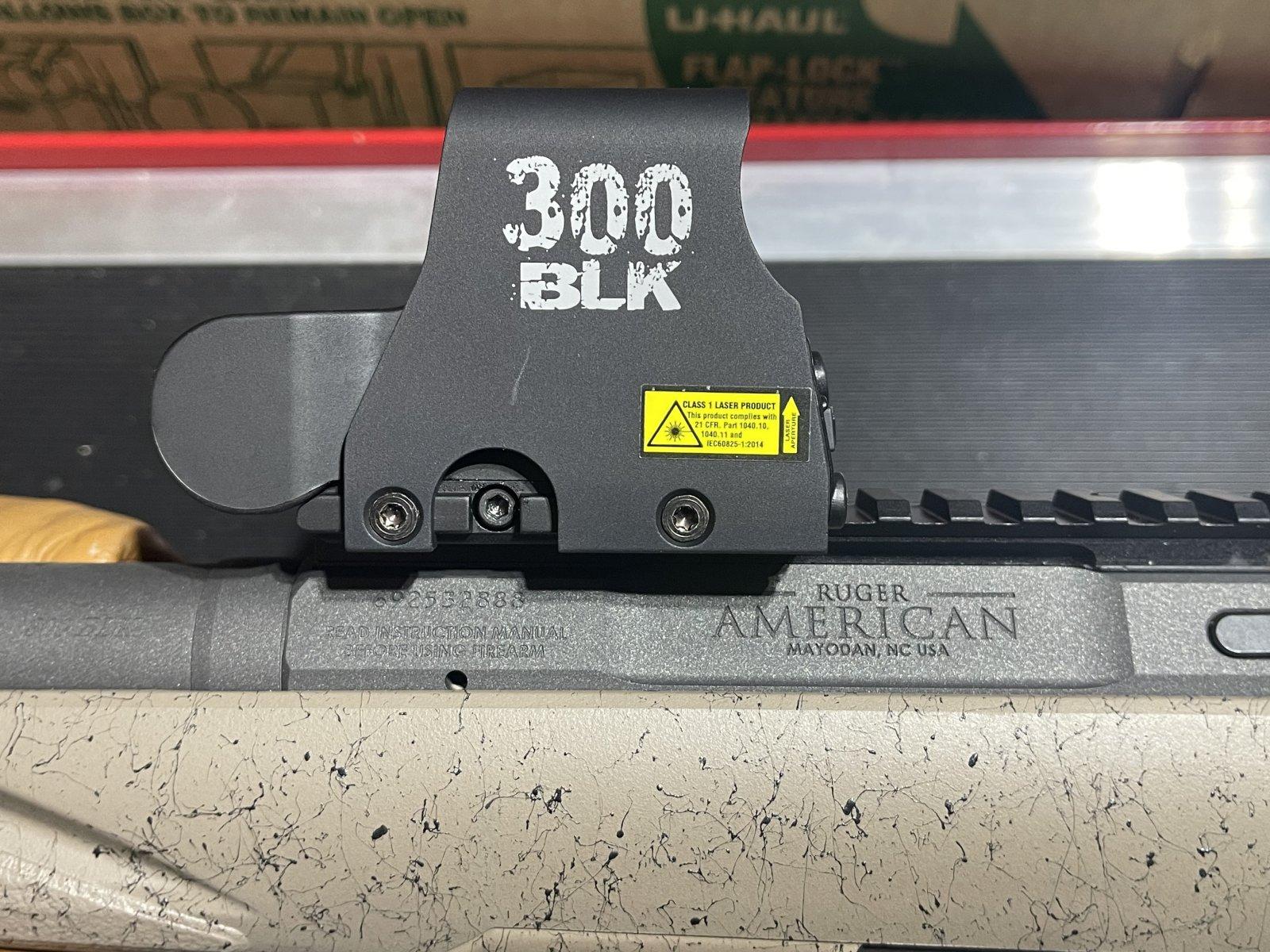

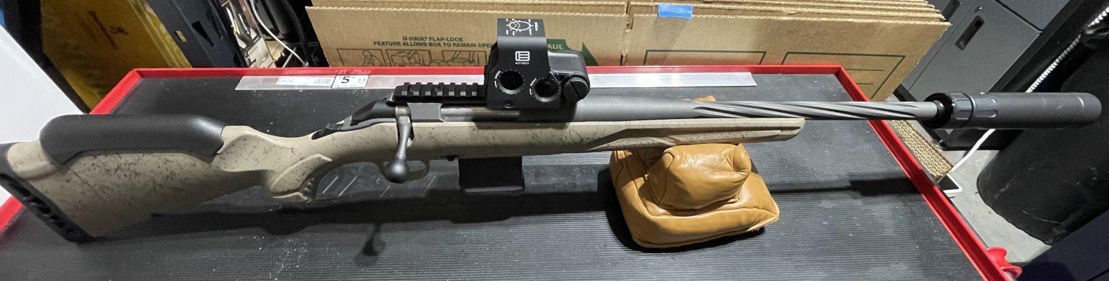

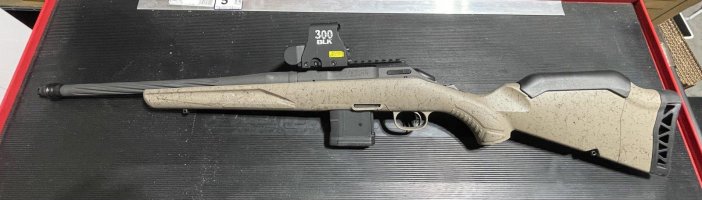

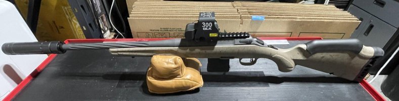

Anyone else have a Ranch Gen 2? Here's mine. Swapped the muzzle brake for a Rugged brake / mount. Just mounted the Eotech XPS2 300 Blk optic. I am hoping the ejected brass doesn't beat the piss out of the eotech that is considerably wider than the pic rail. I need a touch more height on the cheek riser for a good weld. Instead of buying more ruger stock risers I am strongly considering swapping to a Magpul stock. Reviews are very good and it has a lot of adjustability and a more solid bedding to the action than ruger factory. My issue is that it's $300 which makes what was supposed to be a budget built not so much. Thoughts?

Accessorize. My apologies. It's a factory rifle I swapped muzzle device on, added an optic and now consider a stock swap. I never would have started with a ruger ranch rifle if a true custom build was the plan. The rifle is super handy with the 16" barrel. Obviously the suppressor adds length and weight all at one end. Still not bad by any means. Suppressed subsonic 220gr outweigh any downside. I wanted something relatively cheap that I could thump things deer size and smaller inside 100 yards with. The eotech was appealing due to the 2 dot reticle and being designed to 300 blk. I may shoot some supersonic rounds thru it and not having to Jack with the optic when switching back and forth is a nice benefit.

The shell casing may well make contact with the Eotech sight, but most likely will strike the protective steel cover and not harm anything. Put a shell casing in the chamber and see what happens when you extract the casing. Just a suggestion.

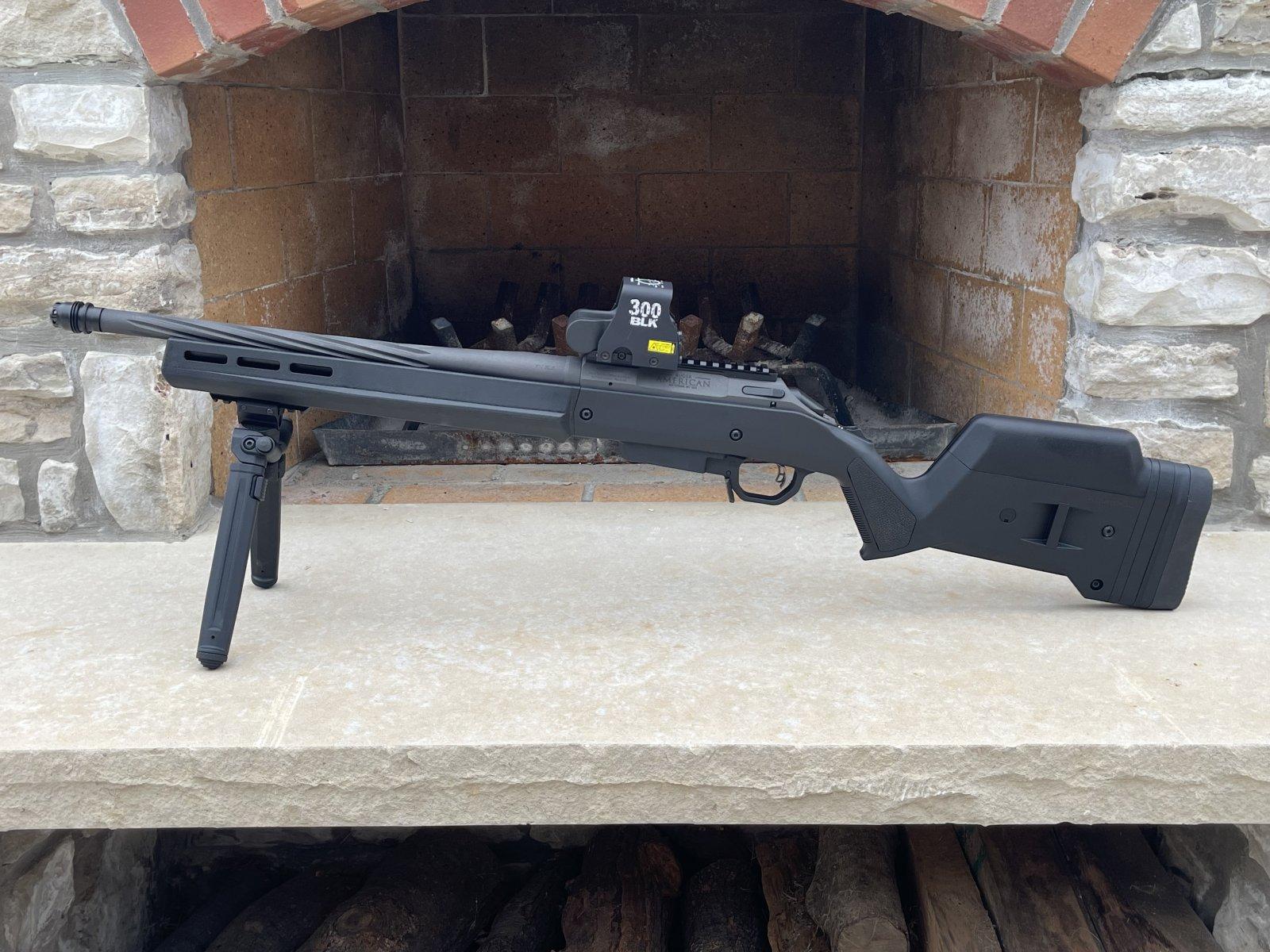

Magpul Hunter stock installed today. Needed the .5” higher cheek riser for the eotech. Also added the M loc pic rail upfront for the bipod mount. Only down side is you cannot remove the bolt completely with the aftermarket stock with any cheek riser. Not a big deal. Also tougher to seat mag on a closed bolt. The adjustability, flexibility and appearance of the magpul stock over the factory unit.

Fianlly got out to the range today and generally things went well. The rifle was on paper right out of the box with the eotech. The Magpul Hunter stock was very comfortable. I quickly moved from 25y to 75y and finally 100y. Initally zeroed with 147gr FMJ which I had no issues with. When I switched to 220gr Ammo Inc Subsonic load I began having feeding issues. The cartridges often got wedged nose up going into the chamber. I wonder if the 220gr is just too large to feed reliably out of the magazines. I was using Lancer 300 BLK specific 10 rnd mags so I know they are quality. I should have brought some 200 gr subs to see if they feed easier. Next time I definitely will. As far as accuracy, at 100y I fired three 3 round groups that measured 2.933" , 2.1835, and 1.0895 for an average of 2.06" which I am thrilled with. I hadnt been to the range all year so I know my technique is lacking. Not to mention with an unmagnified red dot at 100y the dot covers most of a 6" target center. For what I plan to use this gun for the accuracy appears to be plenty good. With the subsonic ammo and a suppressor the noise was minimal and you could easily hear the round impact the berm. Very pleasant shooting experience for all involved. The spent cases do not hit the eotech when ejecting.

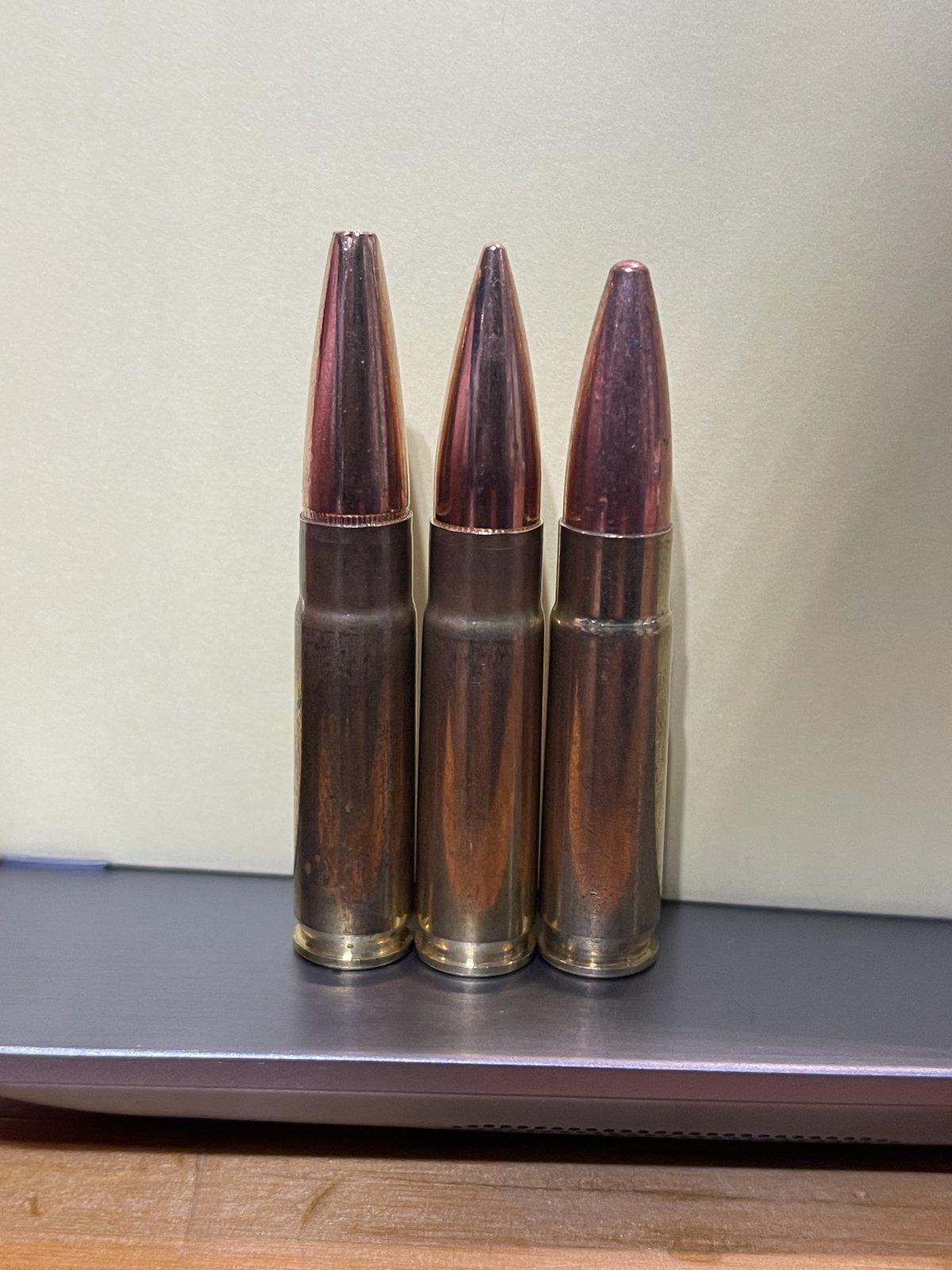

ETA: Measured some different ammo COAL and the 220gr are the shortest at 2.08". The 147gr FMJ are 2.12" and some 200 gr Open Tip subs I have are 2.14". Could the fact that the heaviest ammo I have is also the shortest be giving me feeding issues? The ogive on them is also much more rounded than the other longer ammo. Pic below ammo is left to right: 200gr Winchester open tip subsonic , 147gr Winchester FMJ, 220 gr Ammo Inc TMC FMJ subsonic

Tried this over the weekend, still had issues. I think it’s the short heavy bullets that cause it. No matter what speed I worked the bolt I still had issues. Too slow and it wouldn’t cleanly eject the spent case. I tried some mag tech 200 gr that were noticeably longer and they feed perfectly and were more accurate. They are going to be my go-to subsonic ammo for this rifle.
