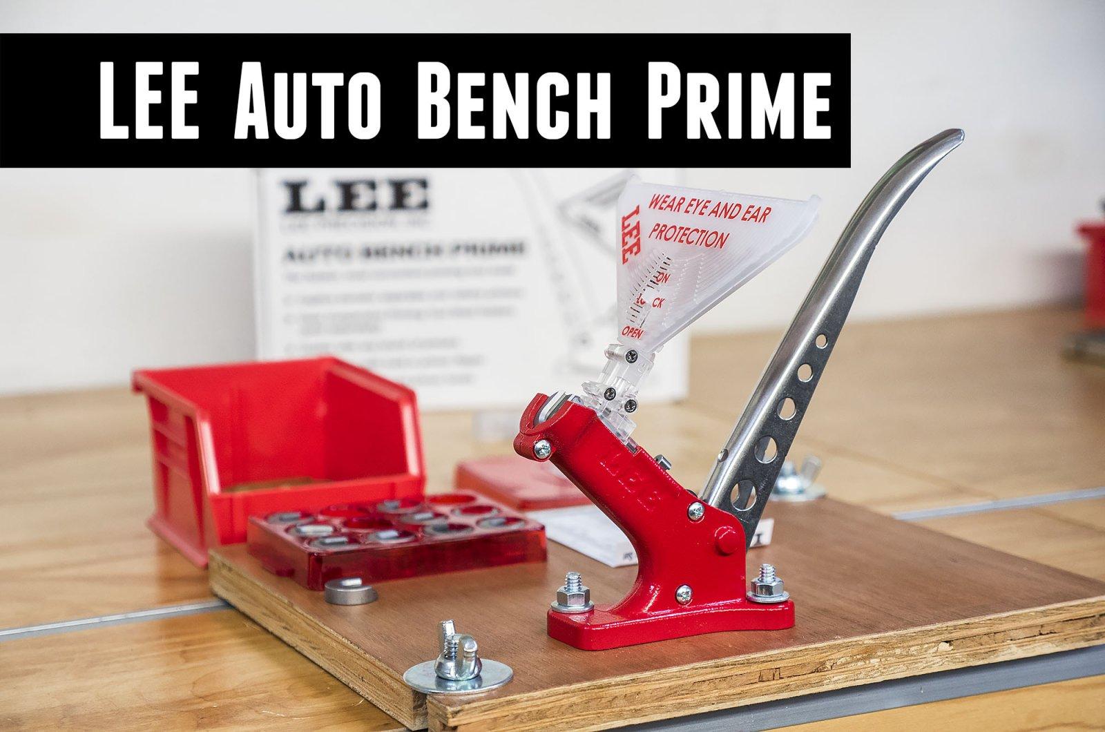

I use Lee precision auto bench primer to prime my rifle ammo but running into an issue I need advice to address.
The Lee shell holder for the auto prime will let the 9mm Luger tapered cases slip past and hang in the shell holder, endangering my life with broken and bent primers.
Any advice is met with critical-thinking. Thanks,
It works magically well on 300 Black Out....
Correct. I think I have four of them. It would take some very odd circumstances for a crushed primer to be deadly but with some people paying $0.10 per primer, none need wasted. I hand prime with an RCBS unit or prime on press with my Lee Classic Turret.
I have lots of Lee machines and tools but not that one. I just went to Lee's website and watched the demo video. Are you using the Lee PRIMER shell holder? It's not the same as the shell holder used on a press. Might be a dumb question but I have never seen one in person and don't know if they could be swapped by accident.
No, The Base Is Different .. On The Primer Holder It's FLAT. No Way To Mix Them Up. Even With Your Eyes CLOSED.

With several of the Lee priming tools, setting off the primer that's being seated can theoretically set off other primers in the feed chute or tray:
Lee has specific recommendations for which primers to use, and (for some types) how many to load in the tray.
The off press shell holders for your priming tool are different than the on press shell holders. You probably need to get the right shell holder for your priming tool. Lee catalog specifically says this.
