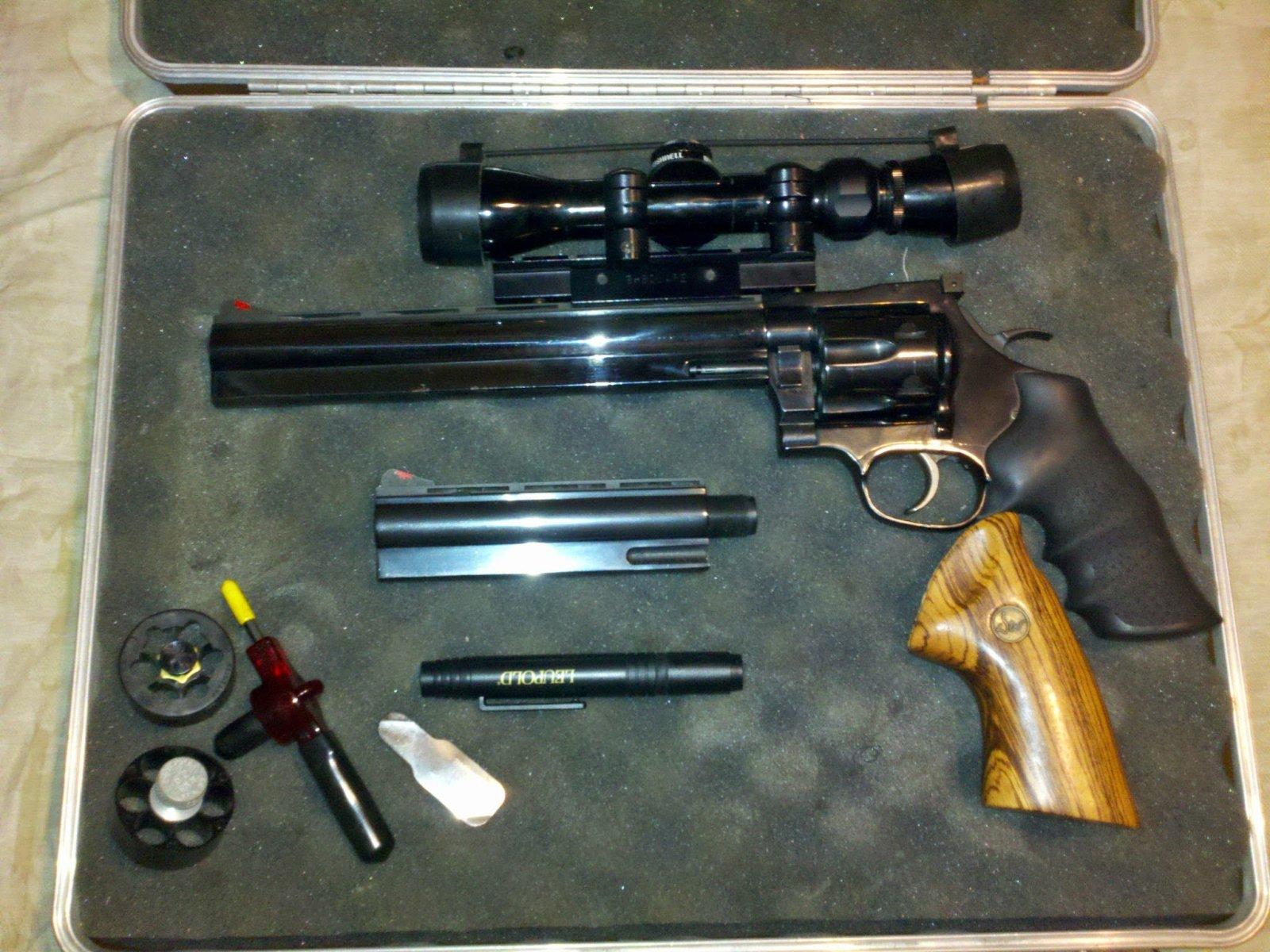

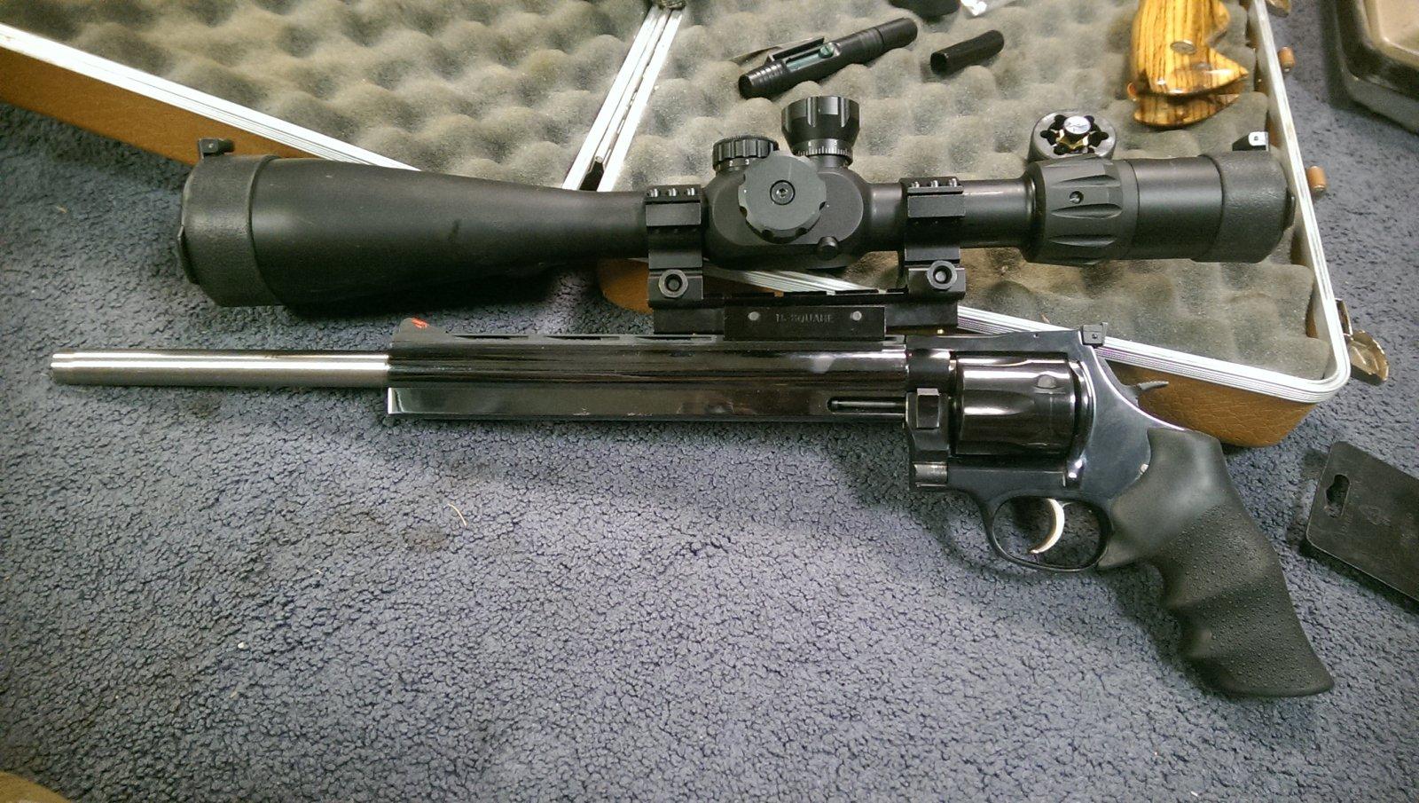

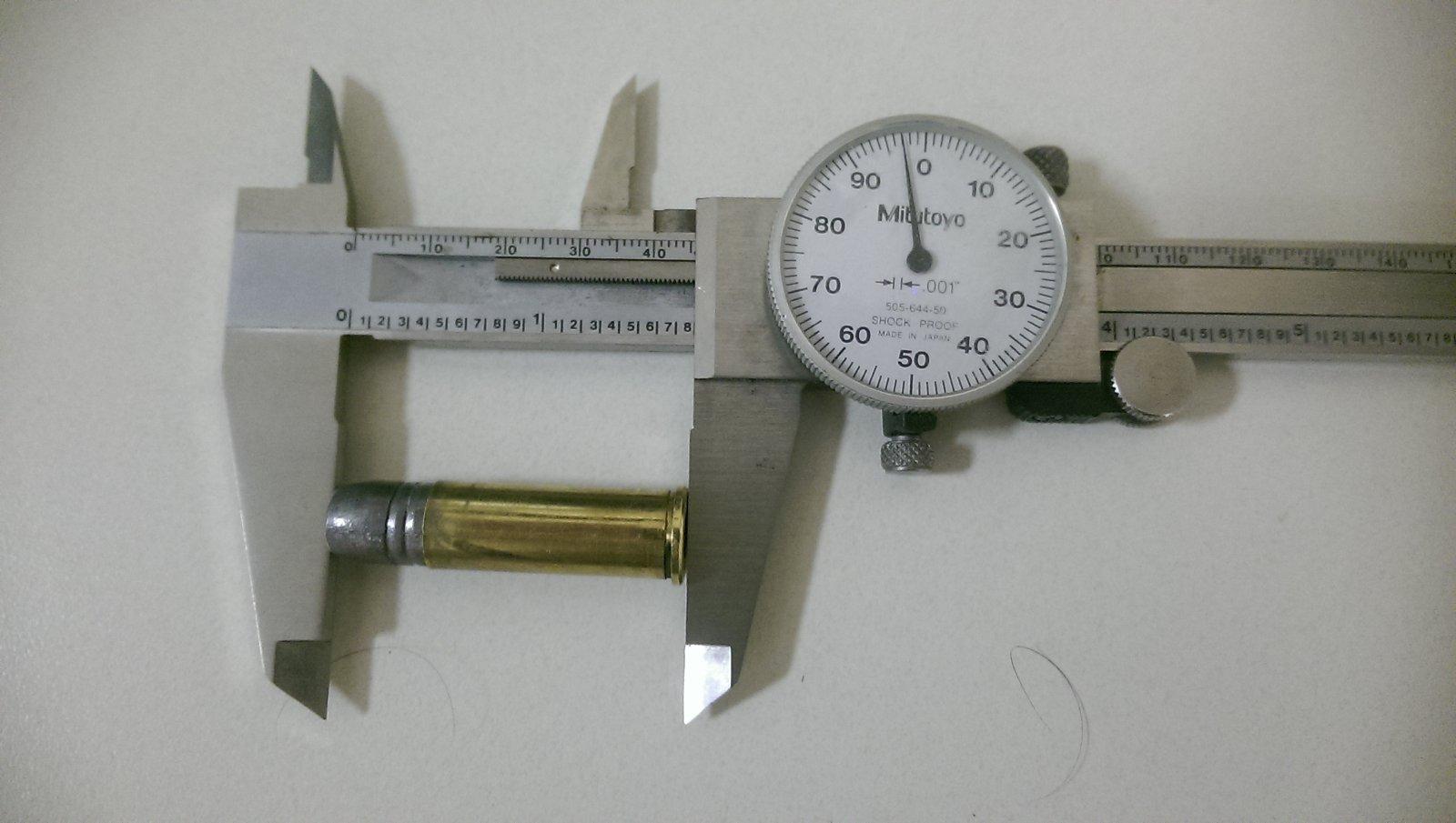

I was shooting IHMSA back in the 80's. Dan Wesson's were the Mad Scientist platform of the day. When I started pushing 300+gr bullets past 1,200ish fps accuracy began to suffer. I finally had to settle for 330gr cast linotype with a gas check going around 1,400 fps through a Douglas barrel with a rifling cut that kinda looks like Marlins Microgroove. We even milled our own bullet molds. Lesser Competitors were limited to what factory guns were available.
I would spec out 2-3 custom cuts and twist rates, turn and thread the barrel blanks and get to work developing loads.
Using the Betamax I settled on a forcing cone design I called the Spade and ran .002 cylinder gap. The Spade started as .004 larger than the cylinder face bores, opened up before tapering back in to the bore in about the same space as a normal forcing cone. I was doing it by hand on the lathe. I don't remember the exact specs for the muzzle crown after 40 years. I would start with the blanks a few inches long for experimenting for the camera before trimming and recrowning to match the barrel sleeves. Mad Science not limited by what normal people had to settle for. Kinda like having a friend at a machine shop to build your High School Racing Engines. On a whole nother level from the normies.
