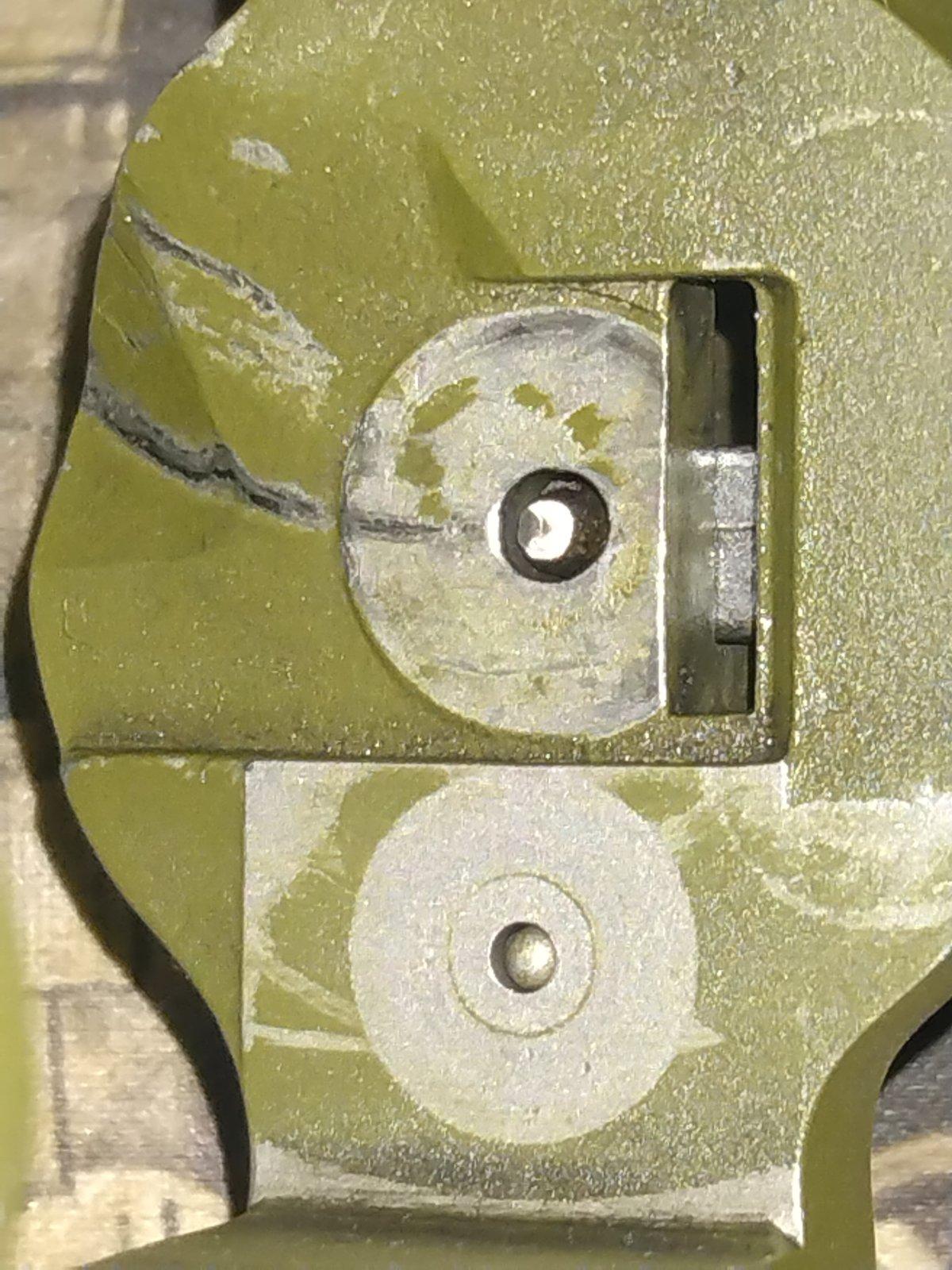

Do you see signs of binding on the recoil shield or cylinder? Rattle can as in it was painted? Pictures would help but as Ron said without seeing it in person, it's a guessing game. Welcome & good luck.

@stonebuster Yes. It had been painted. Forest/OD Green. And the way it's coming off would indicate to me it wasn't a baked on Krylon job.

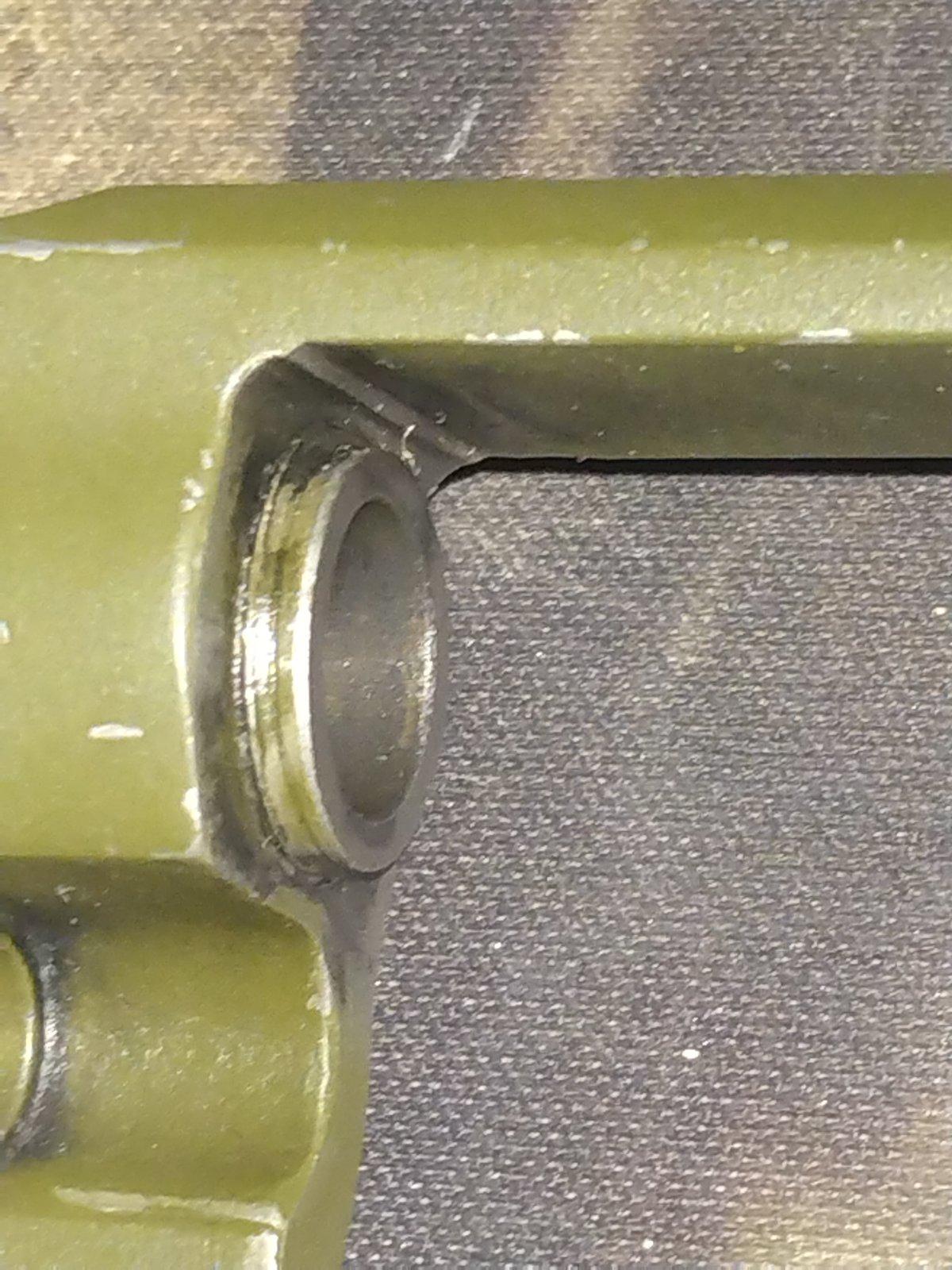

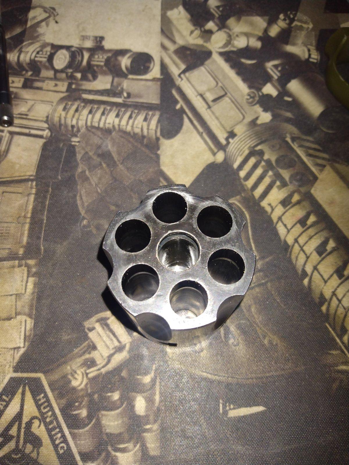

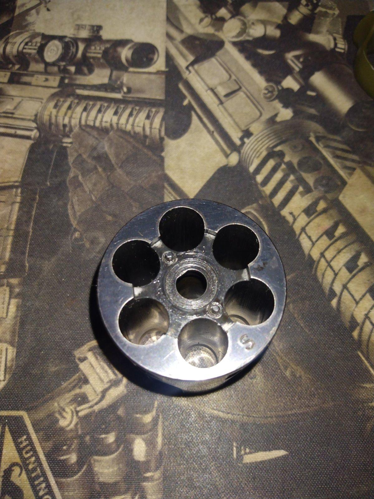

Three shots of the cylinder. The front doesn't look (to me) like it's dragging too much. I've noticed that (at least) two models of this cylinder exist. This one has the flat side of the ejector aligning with the alignment rods on the cylinder (and seems to come with the "S" proof mark, picture 2). The other type, that I got from Classic Firearms, has the alignment rods 1 tine over.

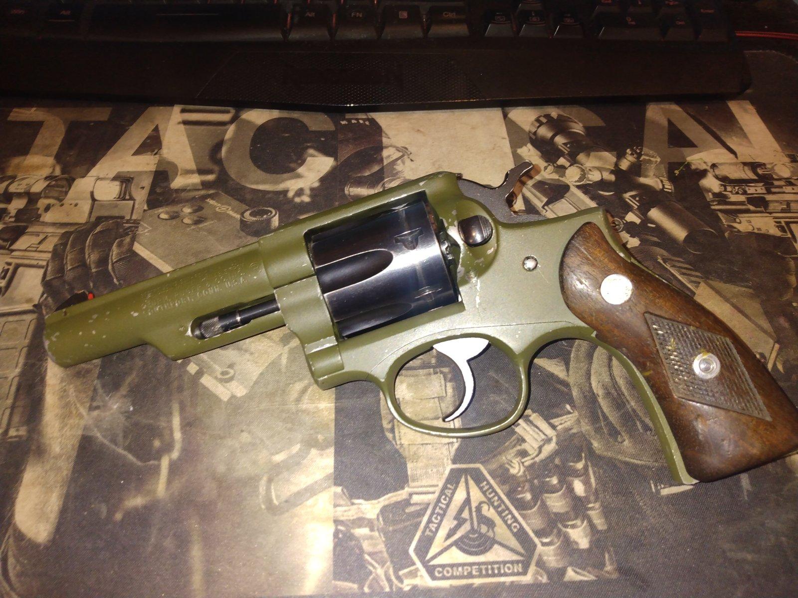

When it arrived, it also had some Vaquero wooden grips on it. Pretty much a mess, all in all.
Vaquero gripps???? How were they inletted to fit the frame??

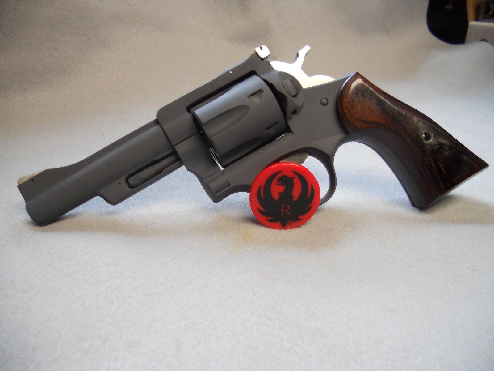

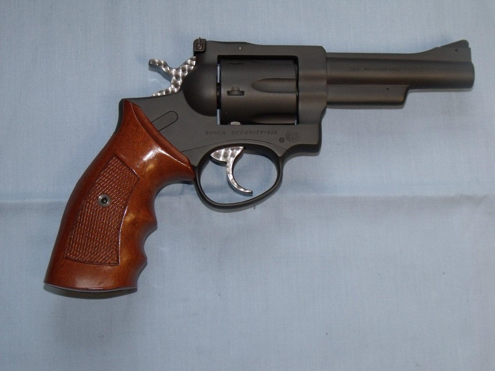

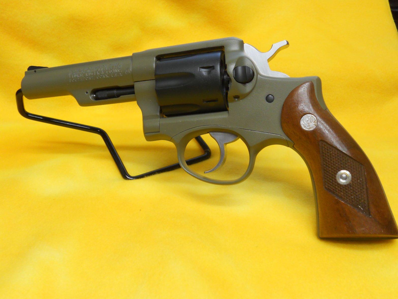

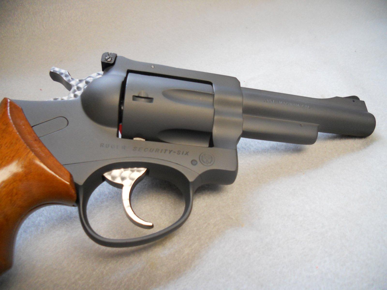

My personal opinion, I would remove all the paint on the gun and start over. I would take it completely apart and evaluate each and every part (including the front sight, all the trigger and hammer parts, everything). If metal is good, maybe reblue, if not then Cerakote (a ceramic based, baked on coating that adds very little dimension). Here are a few that I refurbished and they were basket cases, badly rusted/pitted and the internals were in pretty bad shape also. Just a note: Ruger WILL NOT service these firearms, to include rebluing, because of how long they have been out of production.
The owner of this one (and the next picture) wanted the hammer and trigger jeweled)
This one cost me less than $100 because of the condition. So I decided to do somehing a bit different with the color scheme.
You can make the DA Six series guns look really good or really different if you want to, especially id they are really in bad shape.
Vaquerro grips may have been mildly hyperbolic. I think they're SP101 grips, or something of a similar size.

The guy that did this one may have been inspired by your work, because this one looks like yours, but if it was your drunk/blind cousin from Scranton that did it.
If the frame looked as good as the cylinder I'm surprised he painted it. Looks like round butt grips on square butt. The backwards front sight is a nice touch.:)

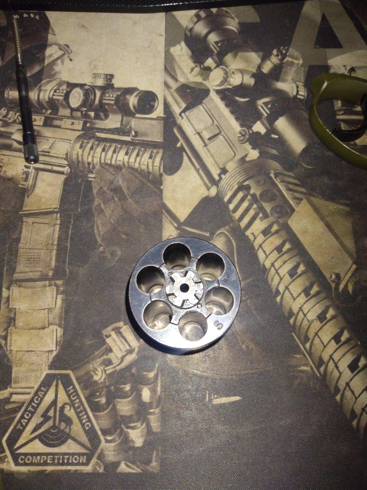

As for the orientation of the locator pins in the cylinder and the holes in the ejector stem star: I checked 12 cylinders that I have in my parts box and setting the flat part of the ejector stem and cylinder at 12:00, I had locator pins at 10/4 (6), 8/2 (4) and 12/6 (2). And looking at 3 ejector stems the pins on 2 were 8/2 and the other was 10/4.
I do not know (have to do some research unless someone out there knows) how the ejector stem and the ejector star were machined (or mated together), or how they determined where to drill the holes for the locator pins (they are removable/replaceable). I suspect that the cylinder and the star were orientated to the 12/6 position so the holes were drilled in the same place each time. This is easy to do on a machine.
I also found that the proof mark on the cylinder has no relationship to where the locator pins holes are drilled. Also, I don't know how they determined the position to mill the flat part of the ejector stem and the flat part of the ejector stem hole in the cylinder. It is obvious that they did not set up a fixture to orientate the same way each time.
