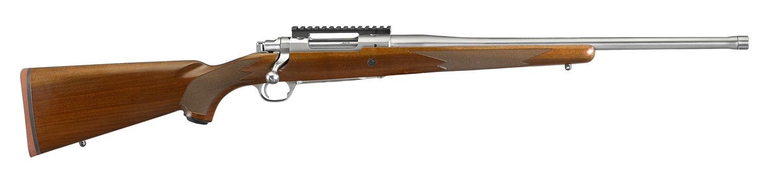

This thread caused me to look at the current lineup. Yes, they are threaded with relatively standard thread pitches. They've also changed (thickened) the barrel profile at the end to allow for threading and a shoulder. To my eye, it looks pretty ugly; I'd want to see one in person before I bought one. Doubt that will happen in the current market anytime soon.

Look at the muzzle end of this current 77/44 from Ruger and tell me that it isn't ugly. Looks to me like they added an unnecessary muzzle weight. There were a lot of options to configuring this "TOOL" that didn't include a sudden transition to a thicker barrel at the muzzle end.
rugerjunkie
Mar 15, 2005
1,972
Kansas
There isn't a lot of meat on a standard barrel in the first place. Cut some threads into it and I'd think you would be getting pretty thin. Do you think for just a second that is why they had to do what they did?
I'd be curious to hear some of your ideas on how to accomplish the threading without bumping up the barrel diameter…
