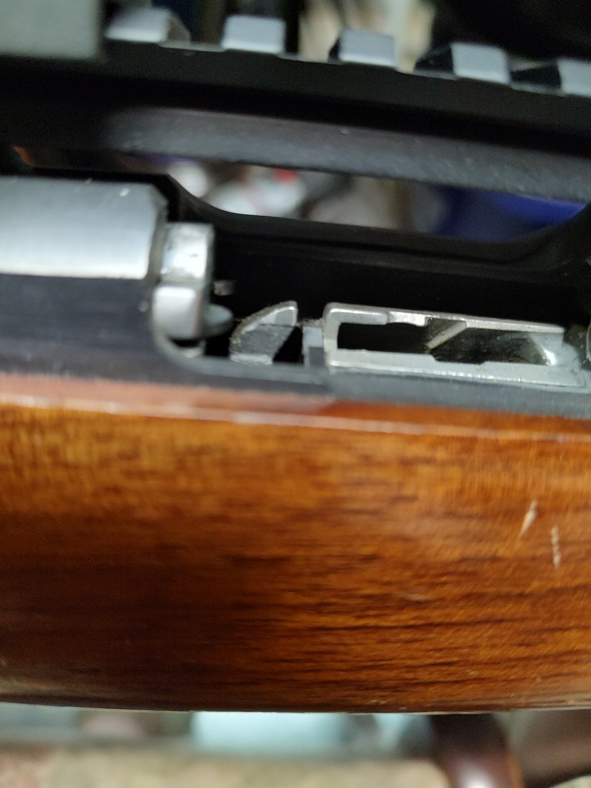

My old 77/22 has generally been very reliable but occasionally does not like to eject the spent cases very well. It extracts as it should but does not kick out the case. I have only used Ruger factory magazines, the flat bottom ones designed for the 77/22. I have not taken the time to test to see whether the brand of ammo makes a difference. Is this a common problem? Should I get new magazines? Are certain ammo brands better than others?
I bought the rifle used many years ago and have only used the magazines that came with it.

Extraction is fine. Ejection is the problem. It does eject better with the magazine in.

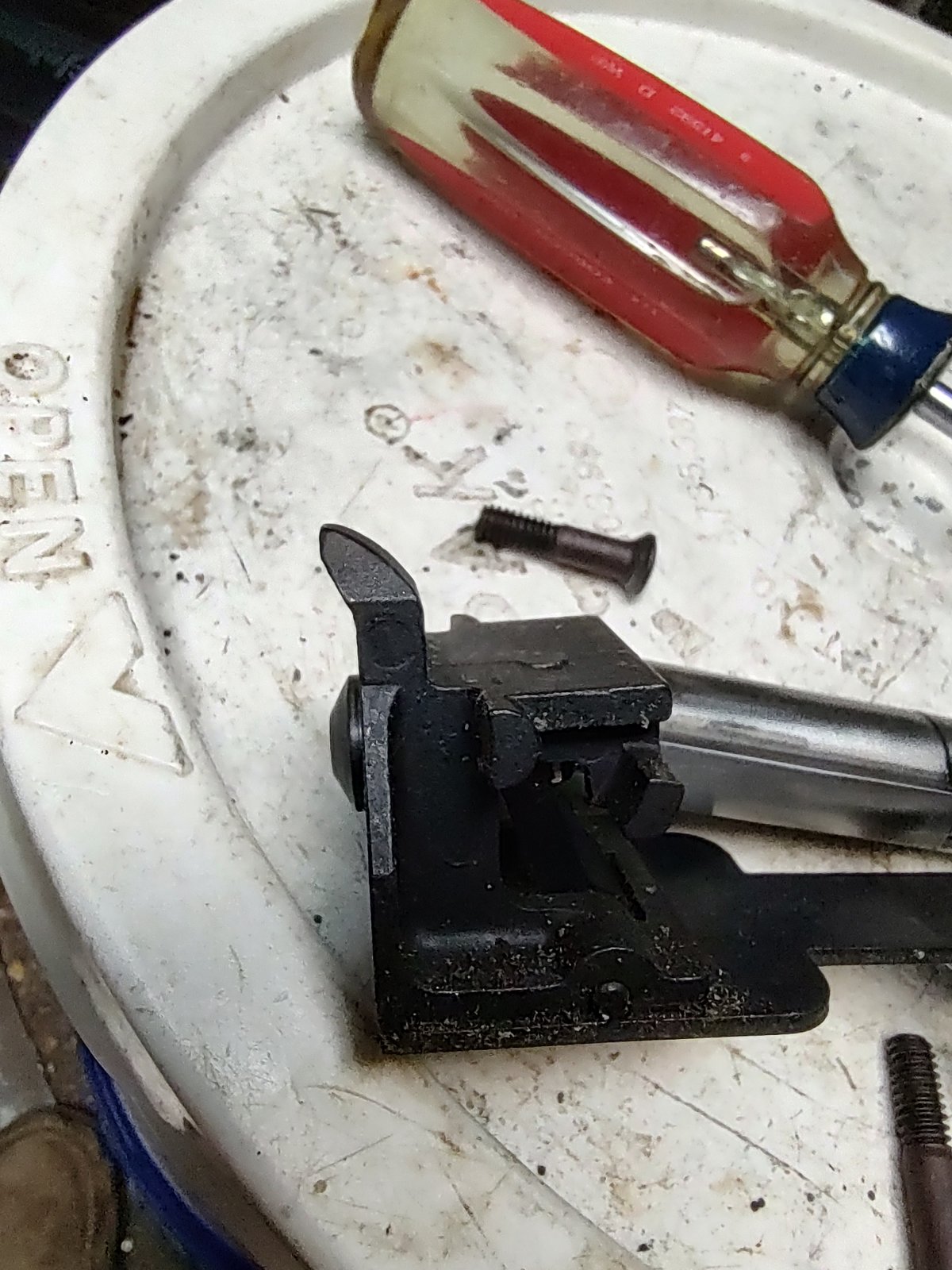

I am not sure how you replace the ejector and do not see any type of ejector spring. I always assumed the little notch in the magazine lip was the primary ejector since it rides in the groove in the bolt and because the solid piece mounted on the floor plate that rides in that same groove is lower than the lip of the magazine. I will give it another good cleaning and then try several different brands of ammo.
Clean the bolt,, especially the extractor area. Also,, clean the area around the bolt channel. I do not think the ejector is part of the magazine. I'll look at one later to determine if I'm correct.
I just took a look at my old, well used 77/22's extractors. They're filthy and covered with bullet lube and burned powder residue but were working fine last November. Hose out the bolt with 'brake cleaner' and blow it dry with compressed air. Make certain all the extractor bits are present and the 'points' of the extractors aren't damaged. Put a drop of CLP on each extractor pivot & spring. I'll bet all works fine again. Contender is correct, the ejector is NOT part of the magazine and the one pictured does not look damaged.

I have been tinkering with it trying to get a handle on what is happening. I am using Federal ammo and may try others later. I limited the rearward travel of the bolt and found that it would eject the live round before the front of the bolt face got to the rear of the magazine lips. That indicated to me that the little notch on the magazine lip can cause ejection. I tried working the bolt with the magazine removed and was only able to get the round to eject by very rapid movement of the bolt. That showed me that ejection can occur without the magazine being present.
