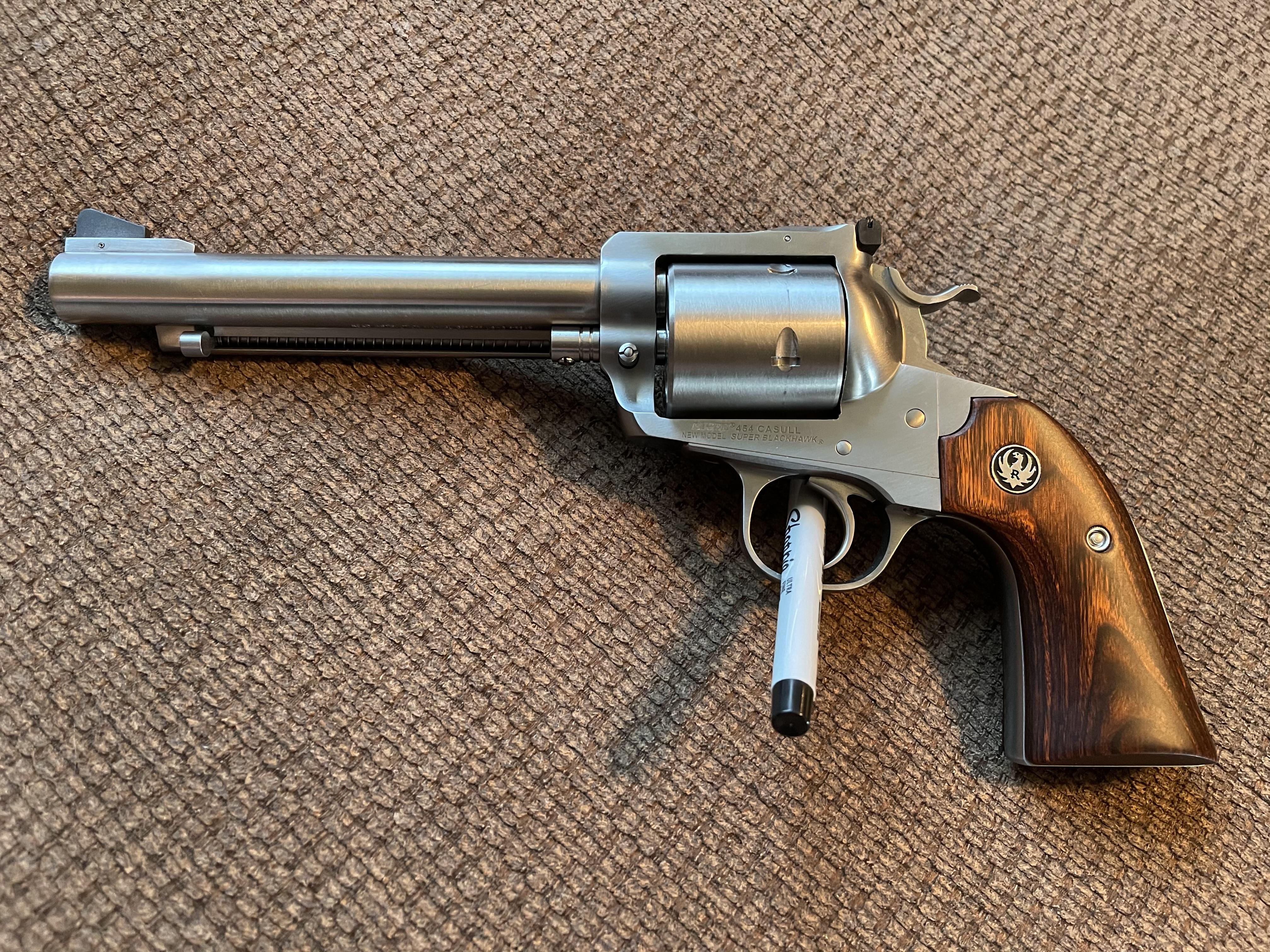

I’ve acquired a SBH 454 Casull recently and have worked up,,,,,,well down, a few loads. I started with 250 grain XTP because that’s what I had on hand. I have 260 and 305 cast from Matt’s Bullets. The 305 are pretty tough, even at starting loads.
I know you can shoot 45 Long Colt and clean after but I’m wondering what you guys think about having someone make a 45 LC cylinder to use as a convertible? Who would y’all recommend to take this on?
BTW, I’m using H-110 and have also IMR 4227 to try. I have read to NOT use H-110 as a reduced charge.
    2.3 MB

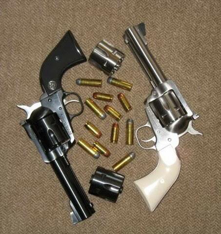

Do you know if there is a full sized frame Ruger .45 Colt that is also a convertible and that can also shoot .45ACP ammo with a cylinder swap?
I showed one (blued) in the picture above. I'm glad my information was helpful to you.
As a side note the blued convertible shown was sent back to Ruger due to a poorly fitted grip frame, frame itself warped at the pins, and a terrible job on the bluing. They quickly sent a replacement with no argument. I love Ruger's customer service.
Yes, Ruger offered them off and on through the years. Then too there were exclusives offered as well.
