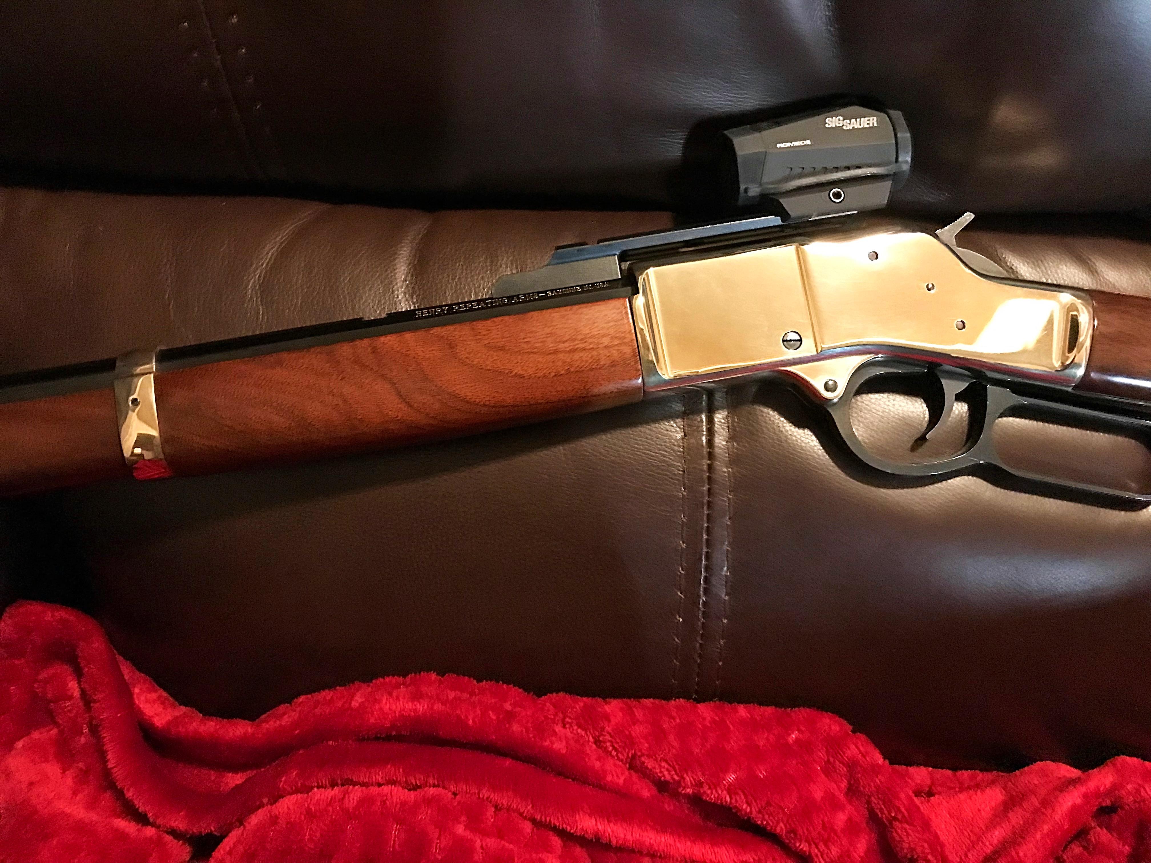

Don’t hunt dear but do hunt feral hogs with my Henry Big Boy in 44mag. it has yet to fail knocking down the porker. They stay down. Not all we’re killed with the one shot but they weren’t going anywhere. I dispatch them with my .45 if they are suffering. All have been sows. The smallest around 80-90 lbs and the largest around 150-175lbs. I have no doubt you will be able to drop a deer with any .44mag round you choose…. Provided your inside 200 yards. I use Winchester 240gr JHP’s. My longest shot was maybe a 100 yards but I suck at guessing distance. Congrats on the rifle!
