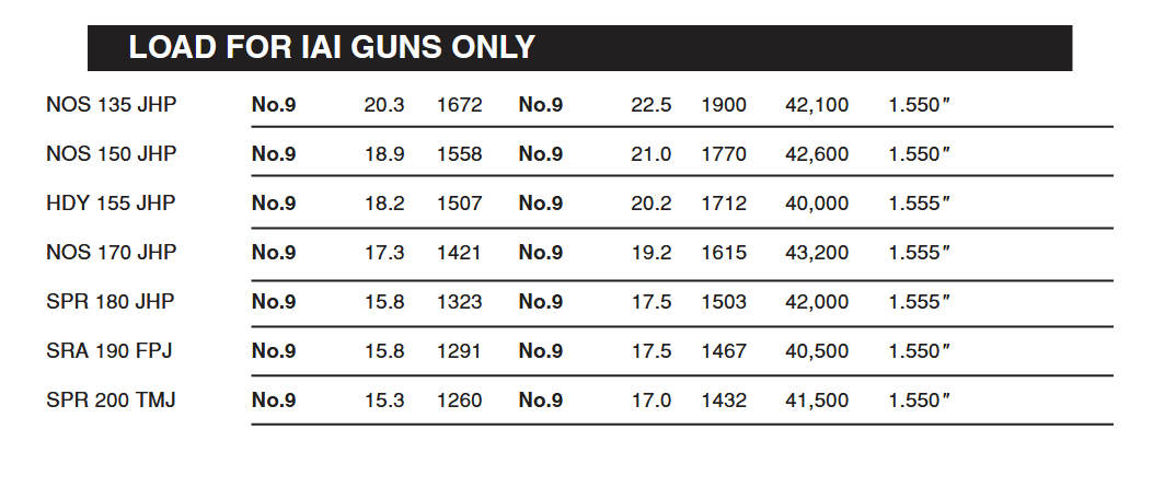

A number of people have converted the GP100 10 mm to 10 mm magnum. I wonder what the pressures on this are compared to the .41 mag? Never mind. Found 10 mm mag pressure max to be 35000 psi vs. regular
10 mm auto at 37500 and .41 mag at 36000 psi and 36200 psi for the .41 Special ( https://www.xxlreloading.com/caliber-load-data/.41-special )
10mm magnum? 🤔
The 10mm Mag. cartridge, as manufactured by DoubleTap ammunition, employs what is essentially a 10mm Auto cartridge case lengthened to 1.290-inches. These rounds are loaded to a maximum operational pressure of 35,000-psi (or 2,500 less than 10mm Auto) and topped with bullets weighing between 135- to 230-grains. The result is a cartridge capable of developing roughly 25- to 30-percent more bullet energy than the 10mm Auto. This moves the 10mm Mag. cartridge's performance potential much closer to that of the .41 Rem. Mag. rimmed revolver round than the 10mm Auto. And it does so while remaining compatible with commonly used 10mm Auto barrel rifling twist rates and well within the pressure tolerances of typical modern revolvers.
Not sure where the .41 Special pressure ceiling comes from. It's a wildcat and even the 1200fps loads are probably not more than 26,000psi.
I can't find any documentation for the pressures associated with the "10mm Magnum". John Taffin did a lengthy review of the round, and revealed everything about it except the pressures. There's no SAAMI spec for it. Anybody have a source?
Accurate data shows it at 37,500psi and they got a 180gr Speer to 1450fps.
If you wanted to get frisky with a bigger gun like the large frame Blackhawk, you could cut .400Legend brass to 1.4" for a little more powder capacity.
Thanks. I checked the LoadData site. They give a whole bunch of loads, including bullet data, powder used, and velocity attained . . . but you have to "subscribe" to get the actual powder charges.
They list pressure limit for this round at 37,500 PSI.

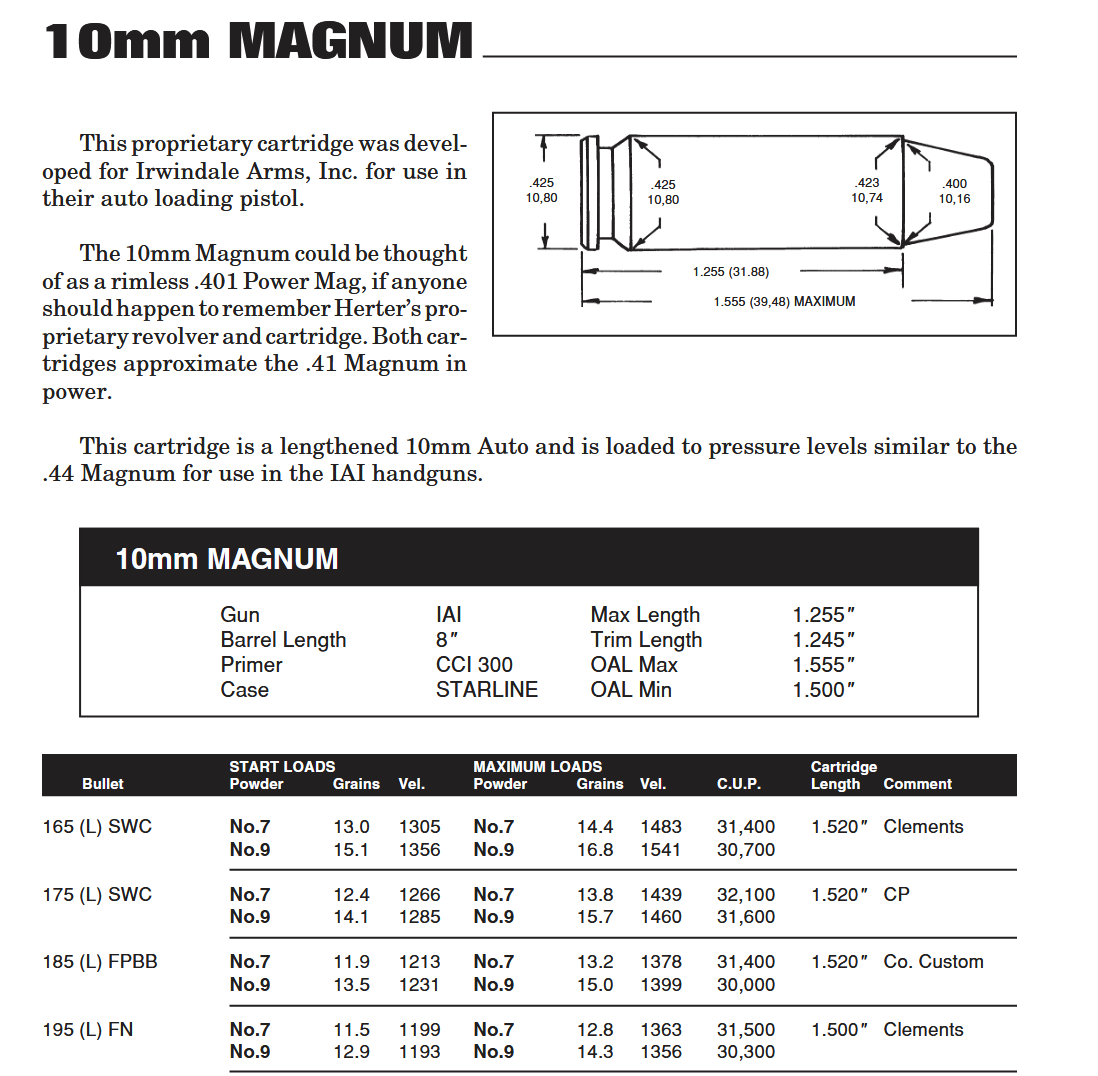

Great post. Thanks. Very similar to the LoadData one.
I note that while this one does list pressures, it's in CUP rather than PSI. There is no direct conversion between the two, but SAAMI lists both for each load where available so one can make a good guess as to how they shape up in PSI.
SAAMI lists CUP of 40,000 and 36,000 PSI for the .44 Magnum. :)
