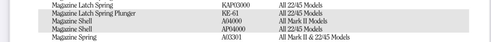

@GasGuzzler the regular MKII magazines and the 22/45 magazines use the same BODY different base plates.
Not so… accord to the factory manual, at least.
Different mag bodies, due to different magazine retention/release mechanisms.
The factory schematic bears this out, showing different part numbers for the magazine shell:
Above screen shot is from this link, on Ruger's site:
You may well be able to incorporate a 22/45 magazine shell to "build" a magazine that will function in a MK II, but the factory schematic says that they're not the same part.
