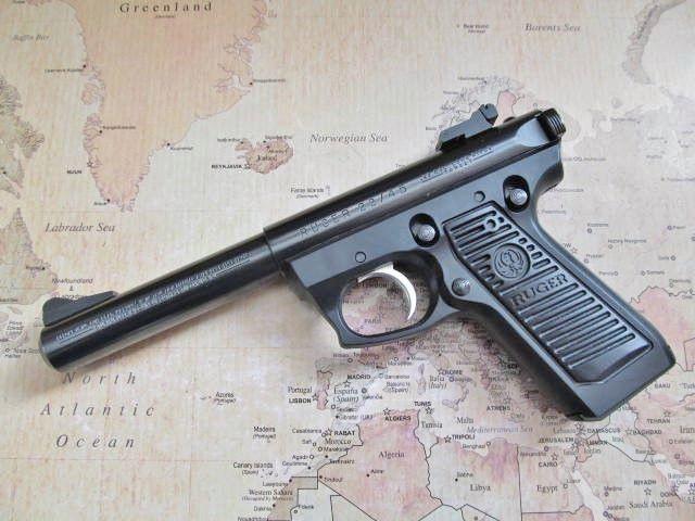

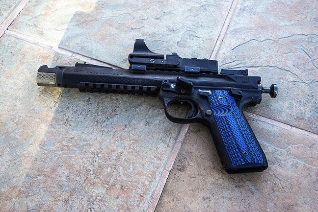

I've got a 22/45 frame with a Volquartsen top end on it and it has over 100K rounds so far without failure. The Mark IV frame is well worth the money.
