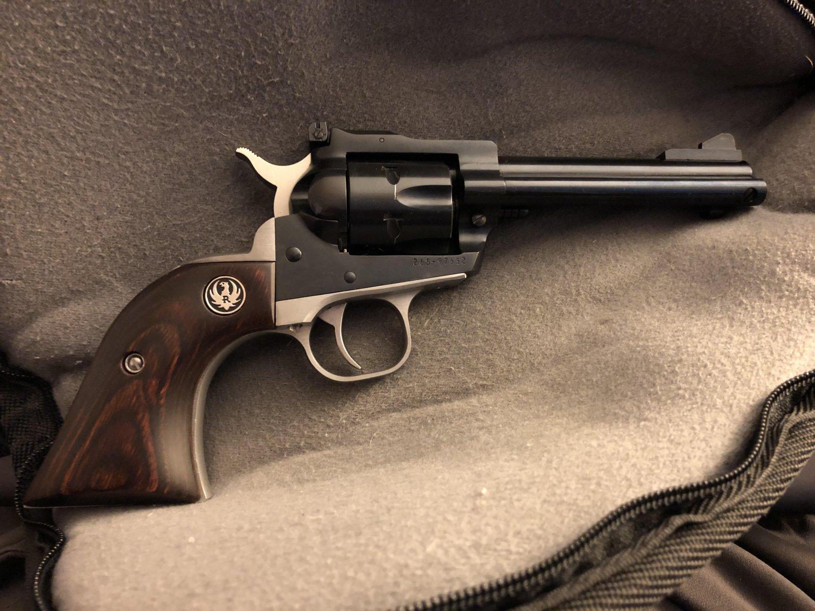

Welcome to the forum. I have a blued steel 2015 Single-six and I just wanted to go for a two-tone so I stripped the finish off the grip frame and just polished the finish, it looks pretty nice I think. However, the finish on the newer Single-six grip frames are painted rather than anodized and the paint was easily removed with paint remover products and I'm not sure about removing the older anodized finish. I also wound up buying a stainless steel grip frame for mine and when they say some fitting may be needed, considerable fitting had to be done to mine. I am actually now happy with either the stainless steel grip frame or the stripped and polished original aluminum grip frame. Picture is of the stainless steel grip frame on the revolver. I don't have a picture with the original stripped aluminum frame.

Hello, wow that does look really nice and I may keep that as a backup plan! I have already located a black replacement frame for reasonable price and will go that route. I may polish up the old aluminum and see how it turns out and have two different looks. I do appreciate the response!

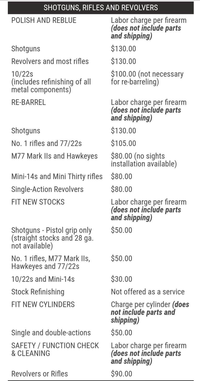

Yes! Sending it back to Ruger is by far the least expensive and the best results.
However they no longer anodize alloy parts like the grip frame ever since new production changed to powder coating alloy parts about 20 years ago. The baked on power coating is superior to anodizing and a much better match to the rest of the gun.
Polishing the alloy grip does not look good for long and oxidizes rapidly to a ugly dingy look.
My choice is replacing with blued or stainless steel grip frames. But not a new one! Much cheaper getting a used steel grip frame and is far less work, usually little fitting required because they’ve already been factory fitted to a gun. Stainless is easiest because any fitted areas only needs to be polished, no bluing to touch up.
If you send the gun to Ruger for a refinish you can request a steel grip frame replacement.

Thanks, I’m going to contact them to get it reblued, I have a grip frame on the way so part one is taken care of, got to shoot it again last night and I’m still smiling. 😊

Ruger redid a Security Six for a friend of mine probably 25 years ago and they sent it back like new complete with new hammer and trigger and springs and sights and grips for $35.
I’ve heard lots of stories about how they come back with new hardware and think that’s pretty good customer service!
I had a 357 three screw done by Ruger and they did great and was $35.00 then
