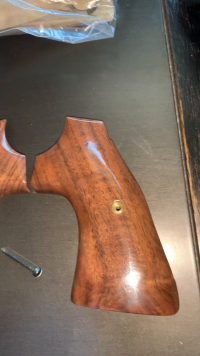

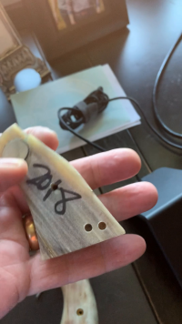

I have a set of the e-bay grips; the seller and I lived close and we fit all his grips to my 150, to check fit. In return, I got the prettiest set (see attached). I also tried a set of Sack Peterson Merlino Ram (see attached). I eventually found a nice set of originals and went that way. If interested, IM me and we can work something out. Regards, Mike

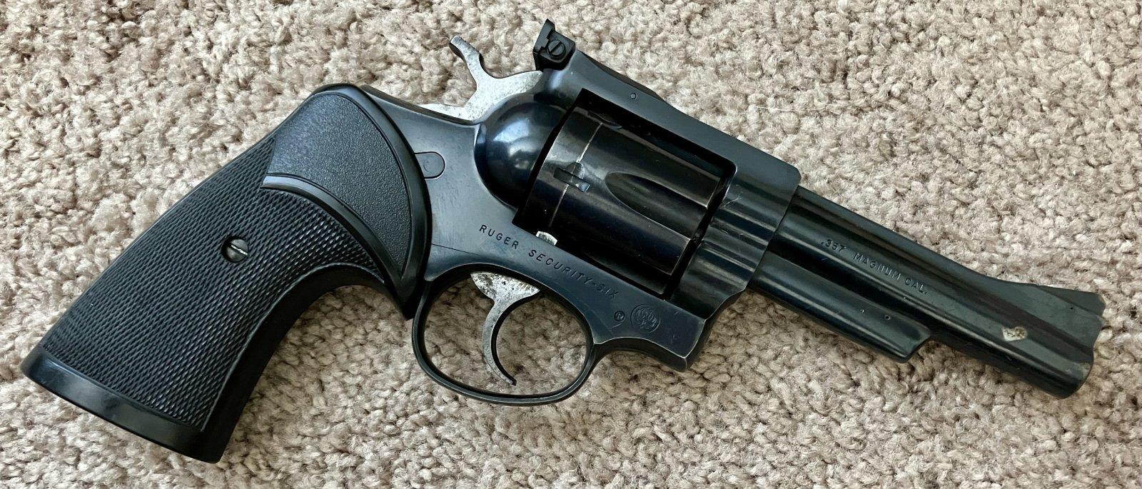

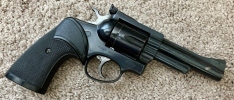

So after passing on the 150 low back due to the grip issue, I found this 154 series (1979-ish) at a local shop today for $350. Even had on my preferred grips.
GEEZ! For a minute, I thought you had my gun! Pretty sure I have the same grips? Pachmayrs?

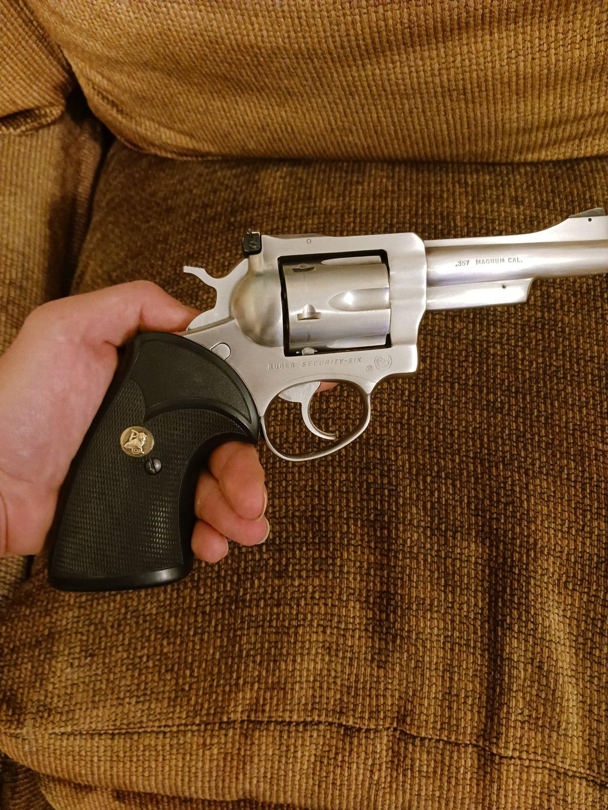

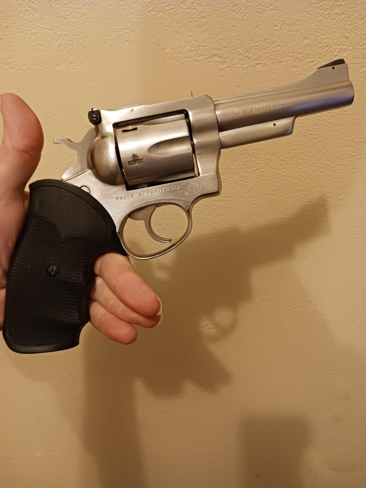

I have another solution, if you prefer rubber grips or just don't want to spend a ton Pachmayr grips for the later models can be made to fit.
This isn't my picture but I use it often, see the pin at the bottom of the frame the arrow is pointing to? If you punch out that pin the Pachmayr grips for the later models will work just fine. Not an exact perfect fit but they do fit, especially the Gripper model. Here's my lowback Six with Pachmayr grips. I got a good deal on actual 150 grips so no longer use the Pachmayrs but I would've had no issue using the Grippers.
The locator pin will punch right back in if you ever need it to so no harm no foul. I know that the Grippers work 100% for sure. I'm pretty sure the Presentation grips do too but I can't say for certain. The Presentations I have were stretched to fit and came from another 150 gun. The Grippers do have a little bit of material that goes above the frame but it's a non issue. You could freeze em and sand em down if it bothers you but I didn't mind it.
