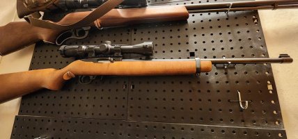

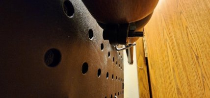

Mine appears to be the same length but it is NOT a takedown model. I never paid attention to it before and have never been bothered by it.
