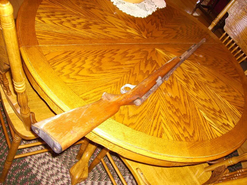

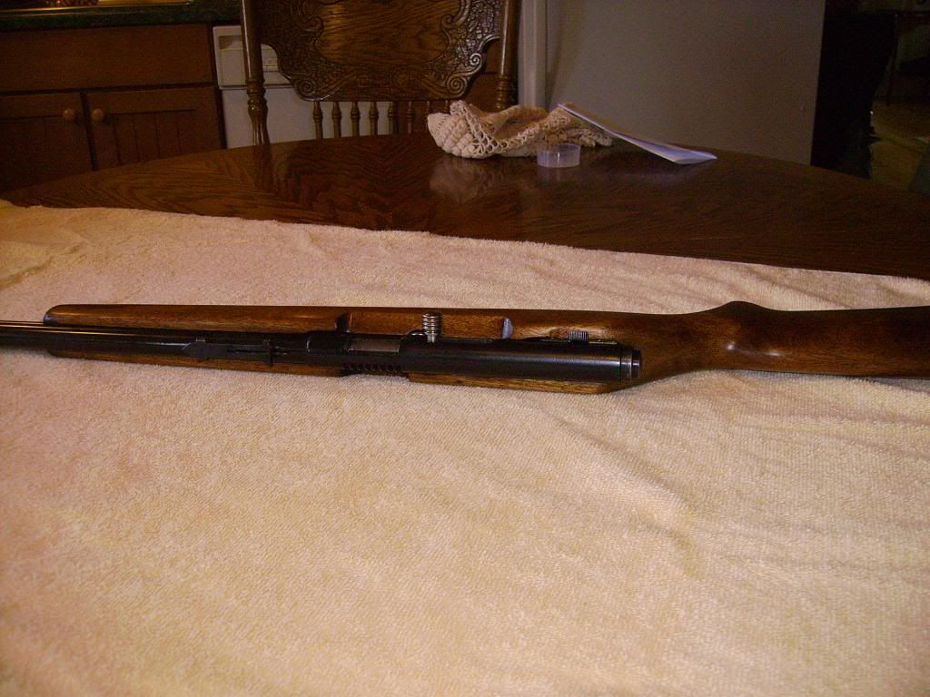

Since I am pretty much chained to the house with a little one in the nursery. I spent the weekend doing the Rust Bluing job on the barrel of my rusty old Springfield model 15 I picked up last week for $20. It took a lot of time...as expected, but turned out really, REALLY well. Here is the "short" version. I feel that I can, after even one job like this, produce similar results on just about any gun made now. Learning curve was not very steep. Click on the pictures and it will pull up a larger one.
I pull filed all the dents and cuts out of the barrel and only sanded it to 240 grit...any more and you are wasting your time as this process actually roughens up the surface a bit.
Made a mount for the barrel to rest while the rusting process takes place...Since I plugged the barrel I used the dowl pins to rest on a wire framework

It turned this
Into this
Of course there is a lot more detail going on between these pictures, but that is the gist of it...no real magic to it. This is a much better finish than using hot bluing salts. Very hard and very impervious to about anything. If you folks have time...you can do this. Very satisfied with the end result.
