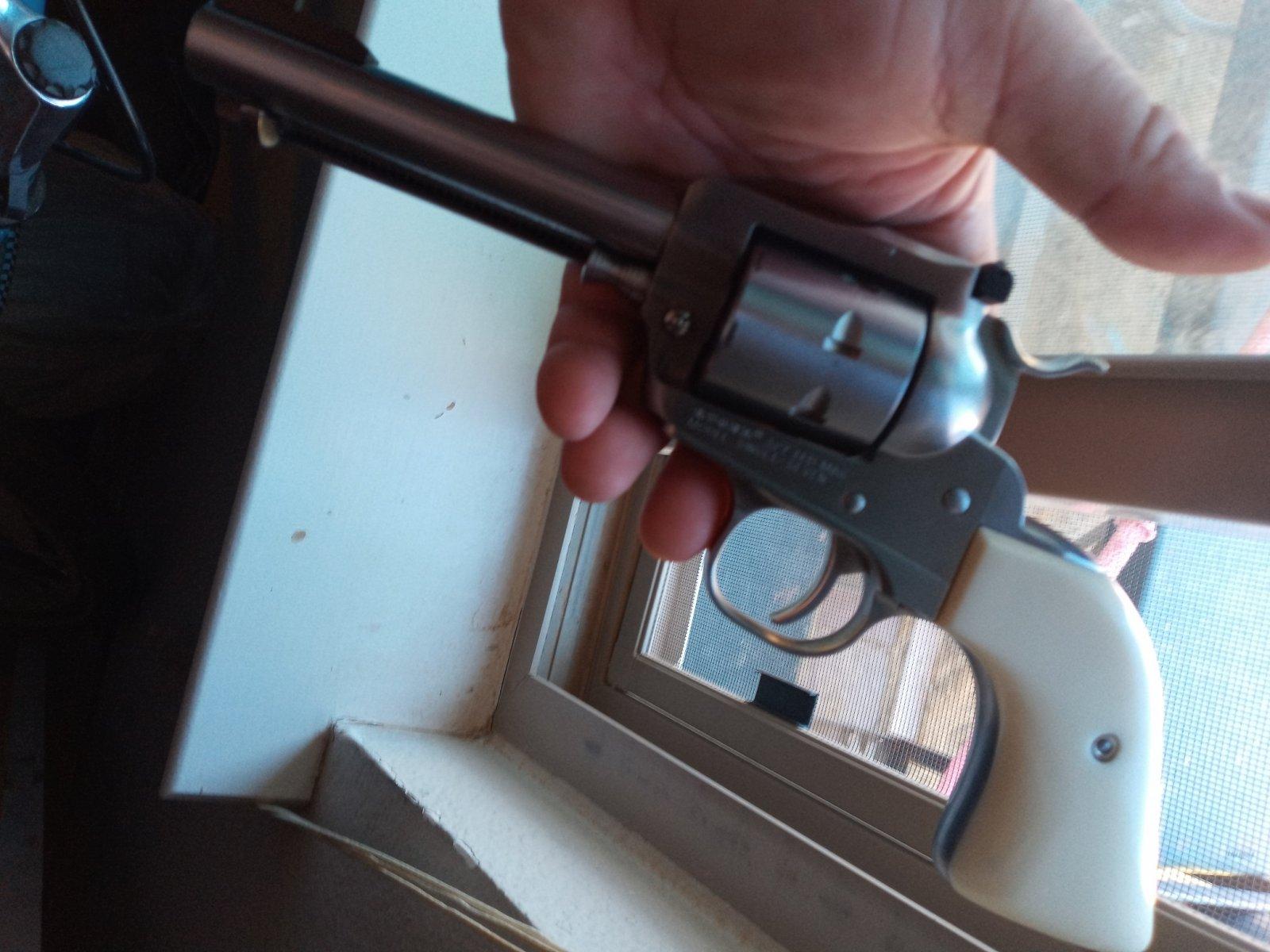

This thread has had a long run. I hoped my experience would show that sometimes things are not so good.
As far as sending it back to Ruger NOPE! They felt that it was ok and sent it back.
I'm not a quitter and knew I would continue to try to make it work.
I still have some hope that there is a solution.
Wolf makes reduced power hammer springs which I will test. Right now the SS is back to how it left the factory. So I will test the three reduced power springs and see if I can get reliable ignition without pierced primers. I haven't ordered the springs yet but will soon.
Never give up. The .327 is just to much fun.:)

I have a first year Single-Seven and has been one of my favorite shooters. The only gripe I have is the alignment issue making it a pain to load as mentioned above. I've thought about trying a free spin pawl from Power Custom. My question is, would a Wrangler pawl work in the Single-Seven or is there something else that prevents the free spin other than the pawl?

You could just do your own free-spin pawl. I don't have the page marked anymore, but maybe someone else does. It just takes some careful filing on the pawl to get it to work. I have done both, Power Custom and filed my own. Two completely different ways of achieving the same free-spin. And both work great. This being for a Blackhawk... not a Single-Six (or 7). But it should work the same way.

I just removed metal until a case would slide in easily. I started with a round file and then switched to a sandpaper wrapped wood dowel.
It took about thirty minutes to clear and polish.
Having to index perfectly was annoying and other shooters would have the same problem when loading or unloading cases.
Bruce 51
Wow, it sure seems like a lot of work ? Did you have to remove a lot of metal, or would you say it was more of a polish type job ? And to think you bought this gun new from Ruger, and you have to do this for a caliber the gun was "designed for"

Definitely had to remove metal and blend into the curved area. Once finished it was so much easier to load and unload. I did this before I knew about the free spin pawl. No regrets. It needed to be done.

Most of the newer 32s and 327s will load much easier with just a free spin pawl.
1. The easiest free spin pawl is modifying your original pawl: grind off the corner of the top right hand side of the pawl's top tooth until it forms a point on the left side. That's it!
2. The Wrangler or any new model flattop Blackhawk and New Vaquero pawl will work but you have to cut a divot in the top surface of the trigger guard part of the grip frame which is much more difficult to get right.
3. Power Custom pawl comes with good instructions and is easy to fit to the gun but you'll have $40 wrapped up in it. Not as easy as #1 above.
If you want to enlarge the loading gate chute, a sanding drum (of the diameter you want the chute to be) in a Dremel tool is the fastest and easiest way followed with a polishing wheel of the same diameter. Practice on scrap metal first if you haven't used a Dremel much.

Exactly what I was looking for Hondo. Thanks a lot.
