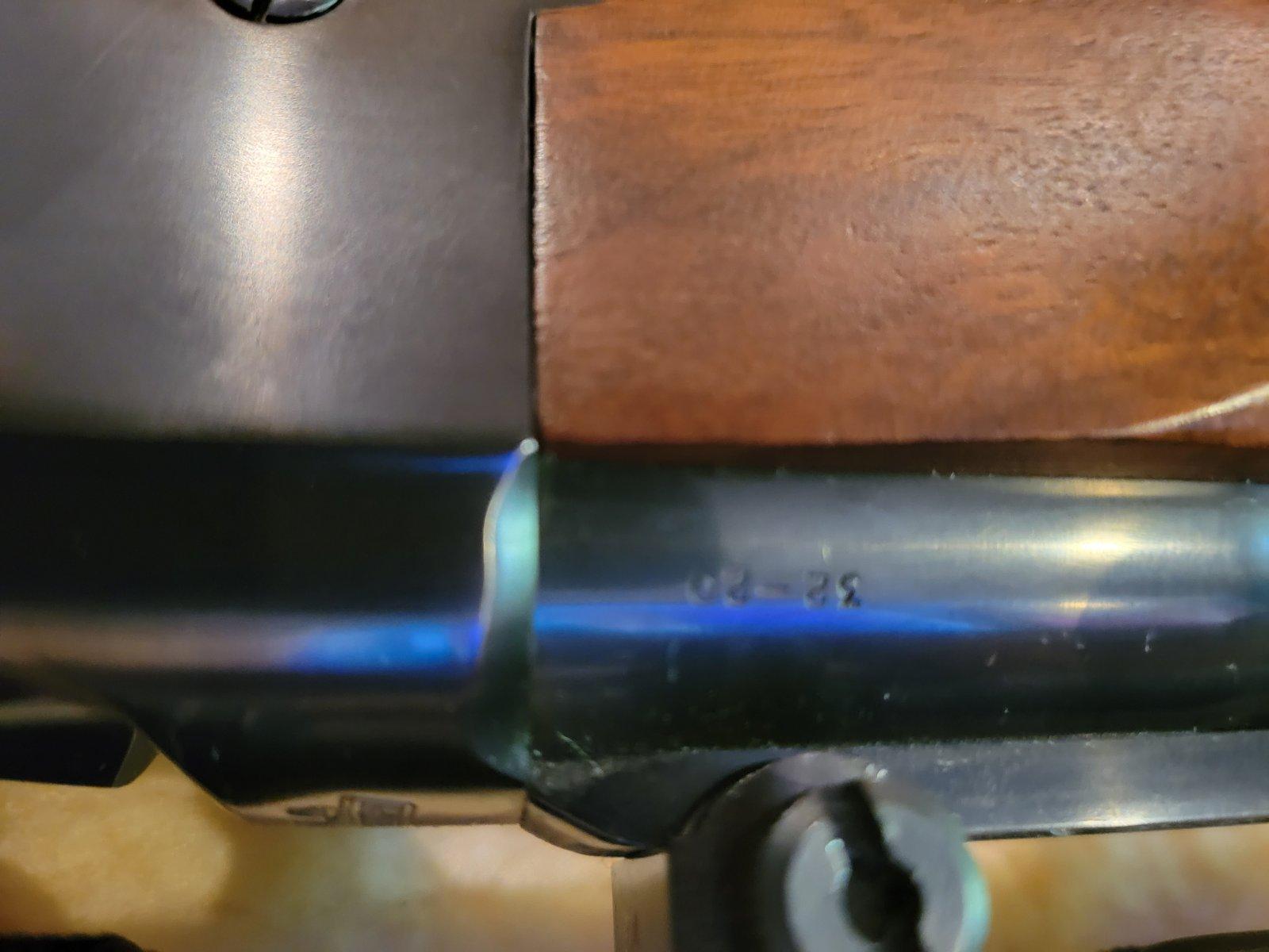

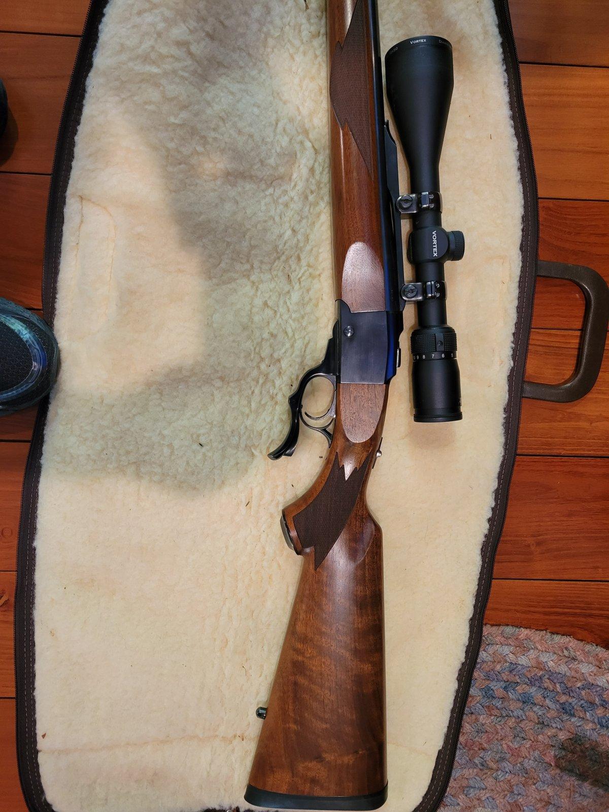

This is my 1st #1. It has been rebarreled for 32-20. The name on the bottom of the barrel is J Seele. Are any of you familiar with him?
Is the name maybe Seeley? Joe Seeley is a custom gunsmith and engraver in the southern tier of NY. He does fantastic work and is usually set up at the Syracuse, NY gun show.

Yes it is actually Seeley. The Y is upside down. Do you reload for yours?
Yes, I reload for all of my rifles. That said, I have too darned many and have not taken the time to really wring out the 32-20, but so far, it looks very promising with both .311 and .308/9 diameter bullets. Best group to date is with old Winchester W680 powder and Hornady 123gr .310 bullets. 5 into 13/16" at 100 yds.
