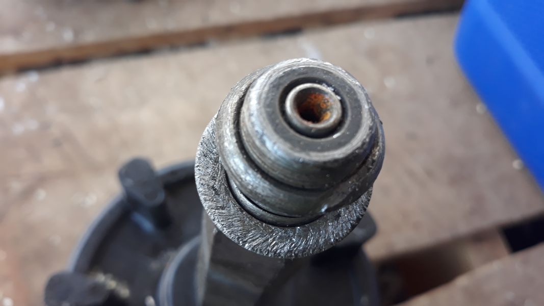

pic 1) this is the speedo and the inner axle bearing housing.... notice the nice oblong hole ground out by the (free range) drive axle.... the bearing was completely gone except for a very small piece of the inner race.

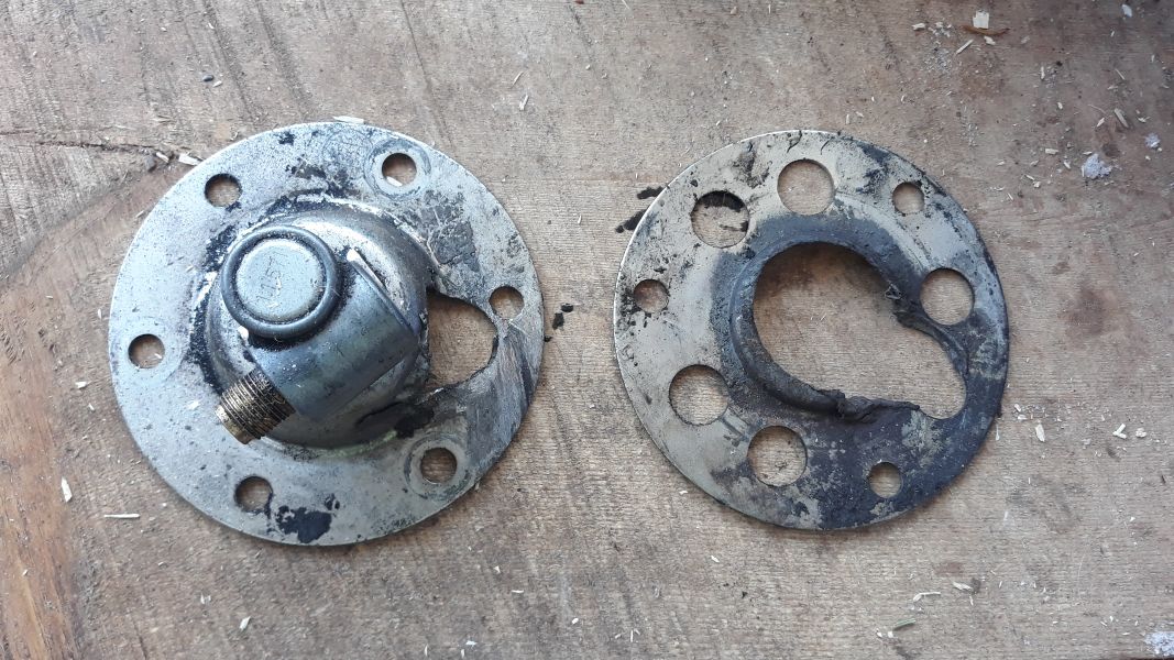

pic 2) this is the bearing end of drive axle.... it's the part that augured the holes in the previous pic... the tapered round (thing), on the end of the shaft is supposed to be a hex nut..
... it evidently makes a fine cutting tool as well....

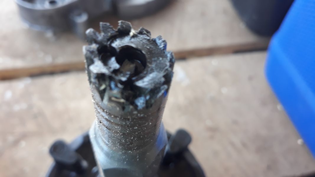

pic 3) this is the other end of the axle.. clearly broken, with the tip remaining in the large sprocket... The sprocket itself has some minor wear on a few of the teeth, however, both sprockets and the chain did not receive major damage, although I did buy new sprockets....

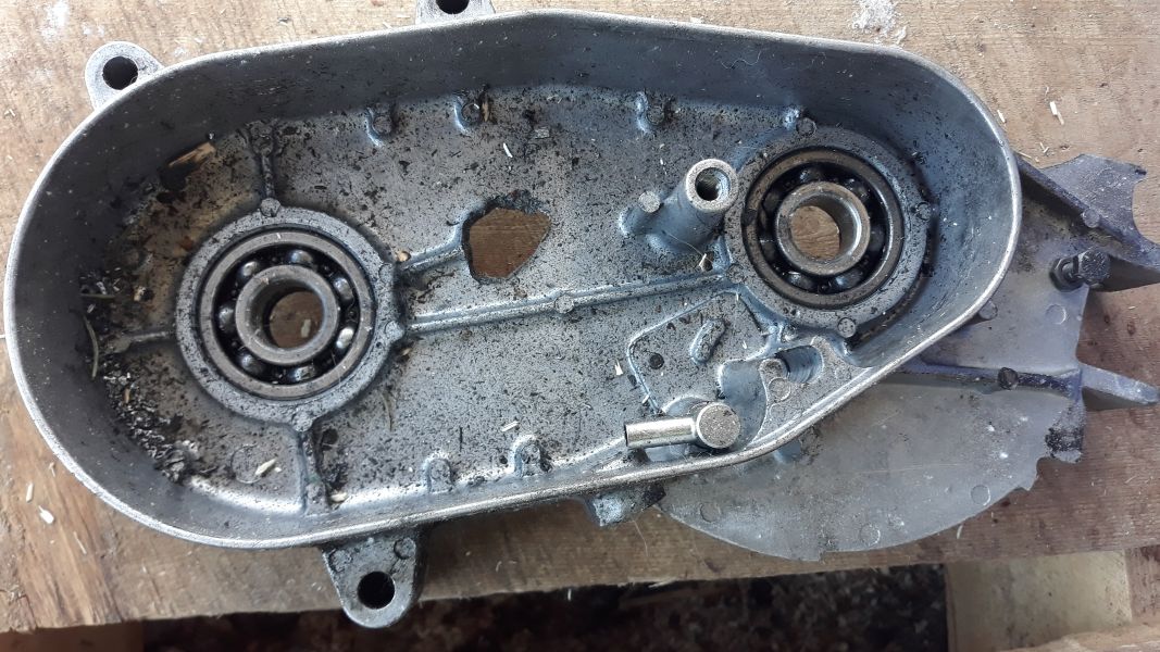

pic 4) this is the chain case... the hole is where a stud that holds the chain case cover was... (see similar directly to the right for the second one)... that was the only damage, and probably happened when the axle torqued to the side....
