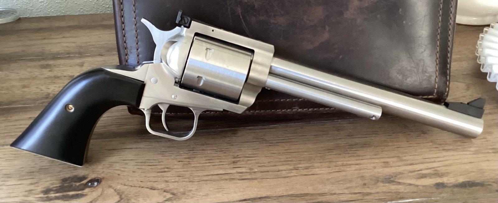

Depending on what caliber/configuration you're looking for, another option is to buy a standard offering and send it off to a smith for a bit of work. Jack Huntington has a wonderful grip mod for the standard Blackhawk grip frame that works wonders at reducing felt recoil and is quite handsome to boot (something I can't say for the BFR Bisley grip). Add in action tuning, barrel shortening, get rid of the nasty barrel billboard and maybe add an express front sight base that takes FA blades and you'd have a heck of a sidearm that probably wouldn't cost any more than going the Custom Shop route with MR. Heck, it might even cost less.
Here's an example of the Huntington grip mod on a BFR. Front sight base appears to be from Jim Stroh -

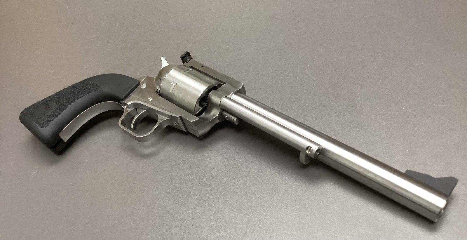

They are rubber and appear to be made by Hogue. I don’t care for the rubber stocks and have already ordered replacements. As to whether they will fit a Super Blackhawk, I cannot say.
They are rubber and appear to be made by Hogue. I don't care for the rubber stocks and have already ordered replacements. As to whether they will fit a Super Blackhawk, I cannot say.
Seems like another case of something working for one guy that absolutely doesn't work for the next. I've been wanting to get a set of those rubber grips because the Uncle Mike's rubbers on mine are like holding onto an angry cheese grater. Meanwhile , I know guys who think the Uncle Mike's are the best set of grips to ever created for the single action sixgun...
And so it goes...
The gun’s barrel length is actually 8.25-inches when measured from the front of the cylinder. It appears MR is measuring from the front of the frame.
