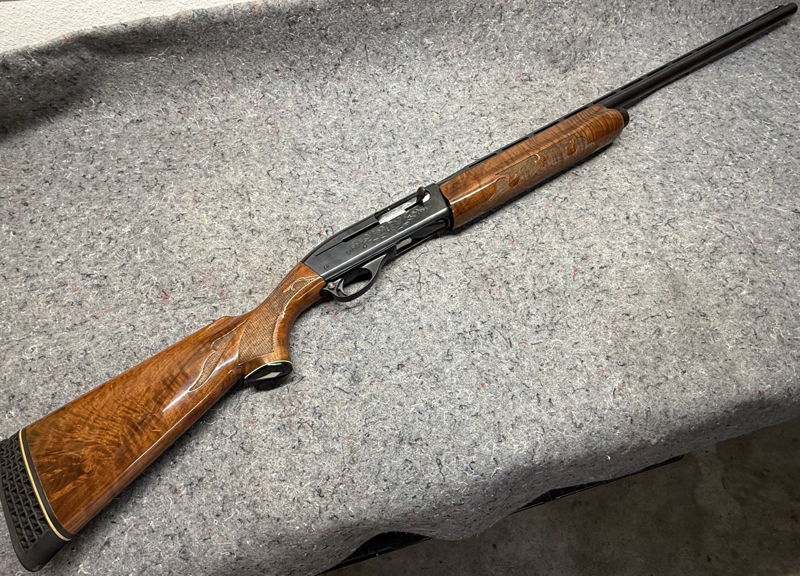

Already back home and with a new to me Remington 1100 in 12 gauge with a 30" vent rib barrel, checkered wood, engraved receiver and bolt, and large butt pad. I have $222 in it. Looks like it was made in 1992 and looks nearly new. It's got a double bead, the choke is modified, and the barrel is stamped April 1992 which matches the 1992 serial number prefix. It's marked as a trap model.

Didn't realize the 1100 is so easy to take apart. A semi-auto shot gun sounds complex. I am going to order seals and rings for the gas system. Looks original and not used much at all. Almost all of the bluing is on the mag tube still. Pictures when I can...

An1100 with that Pachmayr Triple Magnum pad is among one of the softest recoiling 12 ga. shotguns made. Good O rings & keeping that area pretty clean should have the gun running smoothly.
I suggest avoiding Winchester Super Speed shells at all cost if they're still around. The Universials aren't much better.
If your interest continues with with Sporting Clays or Skeet, you may find that a more open choke than the Mod. might result in more broken birds. Another barrel in Skeet, Imp. Cyl, or Rem choke should help.
That's some damn pretty wood, haven't seen much nicer on some TC grades, which is a higher grade than yours .
It's apart now for cleaning. I have a dozen gas o-rings on order. As far as the barrel goes I am a little stumped. There's not another 30" mod. marked 1100 for sale or previously sold I can find, not even a barrel. I only see ones with Remchoke which was introduced before this gun was made. So why does it have a fixed choke barrel and why is it 30" modified when I can find no others? Receiver is marked "TRAP" with a light roll mark on the right side. I can get a Remchoke barrel for $350 new but that's extreme. I had no issues hitting clays with my cheap pump until my shoulder turned blue.

Many of us have shot 1100's for trap and it was a staple of that sport. I was immediately thinking, "I hope he knows to carry extra O-rings". And a couple posts later, the OP mentioned he was getting some. :)
I also thought the wood looked like it was a TB or TC Trap grade. Then later I read it was marked TRAP.❤️
I don't know enough about these yet to know what TB or TC means. It simply says "TRAP" on the right side of the receiver and nothing else.
The left side says REMINGTON Model 1100 and displays the serial number that starts with an M, has six numbers, then ends with a V.
The barrel is lacking most billboard type messages. Has a proof mark or two including "REP", a two-digit date code "4-2" (April 1992?), is marked mod., and a star with "12 GA 2 3/4 in shells only". Other side of the barrel merely says "Remington Arms, Inc. Ilion, N.Y. Made in USA". No warnings or giant ugly things.
Front bead is white and larger than the silver mid-barrel bead. The big nut on the end of the mag tube that holds the forearm wood on is plum/copper colored. I found NO wear, NO burnt powder residue, No grease (but some light oil), and the dirtiest part was inside the mag tube as I am sure I am the first to remove the spring, plunger, and follower after popping the cap out. I bet it has less than 100 rounds through it.
ANY information you all can provide is appreciated. I love the stories and the trivia on these things as much as anything. Still trying to figure out why I have the only 30" vent rib modified 2-3/4" 12 gauge 1100 on the planet. I did find a 26" improved for $250-ish if the guy still has it but I need to fill in the blanks on what I have before I go spending more on it.
It's simply a trap barrel that was offered in modified & full. Most buyers of a dedicated trap gun would generally pick the full in the day, but things were changing. So, not so many of those seen. Not a long run for them anyway as the Rem choke was being trusted & used more & more.
Lots of skeet choked barrels mentioned there but I need to look a lot further to find out about TRAP stamped receivers and why mine has such a long modified barrel...and no Remchokes.
My bad for calling it a trap barrell when it doesn't say so on it. It's simply a visual & how equipped in the day. Vent rib & twin beads, an ivory colored Bradley type on the front with a small silver(colored) mid. Simple as that. Field barrels had a single silver colored bead up front. Trap marked receivers were equipped with the twin bead in Mod or full, before & during Rem choke barrels as the later was not accepted by the trap shooting crowd at first.
The gun appears to be a correct standard 1100 trap gun with sometimes seen prettier wood generally seen on the Trap-B or C guns. This one has an aftermarket pad installed & the only question is that was the length of pull corrected for it.
The stock does not look cut down. I could put an OEM plate back on if I knew which one to get. I have a slip on Limbsaver for function. It doesn't seem too long but I am far from knowledgeable on how to fit a shotgun.
I don't remember seeing a barrel marked TRAP and it's not uncommon to see a trap gun with modified or improved modified choke. I haven't done any of that for a long time but there was some push back from the old timers when screw in chokes came on the market. Many preferred to stick with the non-tubed barrels.

As others have commented, that is stunning wood! I shot trap for many years, 1970 thru about 1998, and the Remington 870 and 1100 was very popular. With the recoil pad on your 1100 it should be a very soft shooting shotgun. I shot with an 1100 for awhile and then went to both Browning and Beretta single barrel shotguns and finally wound up with a Beretta 303 semi-auto.
I should have added "non-magnum" to the weirdness of my 1100. The only 1100s I have seen with a 30" vent rib modified fixed barrel were magnums. Mine is not.

ATA rules prohibit the use of Magnum shells, which would explain why your trap gun is not chambered in 3".
Trap shooters like to "choke for smoke", so I'm not surprised that not too many 30" Mod barrel guns are out there.
As mentioned, general consensus is a more open choke would be better for sporting clays, but the setup you have now will still dust 'em on the trap line.
