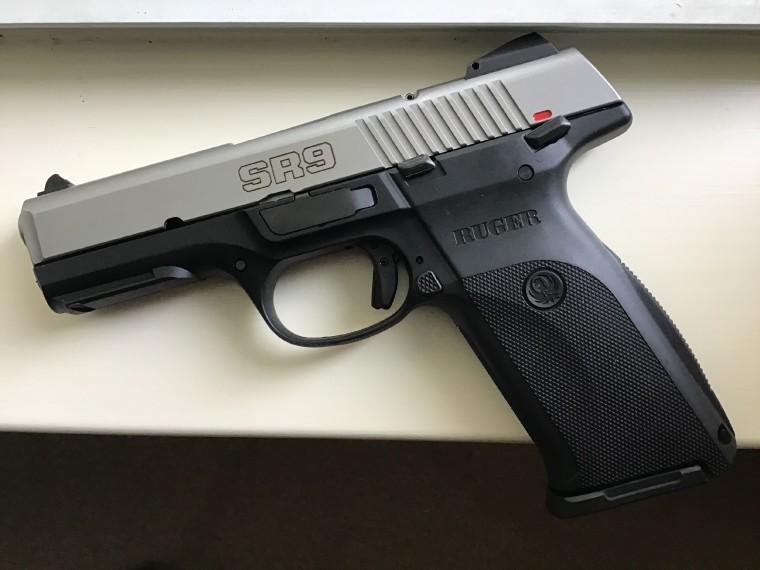

Not a ridiculous question at all, and welcome to the forum.
That is the normal trigger position when the gun is empty and the trigger has been pulled while dry firing.
See my SR9 below.
But be careful, the manual says not to dry fire your SR without an empty magazine inserted in the gun.
The trigger will not reset until you rack the slide. I only have the SR45 as a striker fired Ruger, so I'm not familiar with any other where the trigger resets with out racking the slide.
My Glocks, Springfield & Kahrs work the same way.
