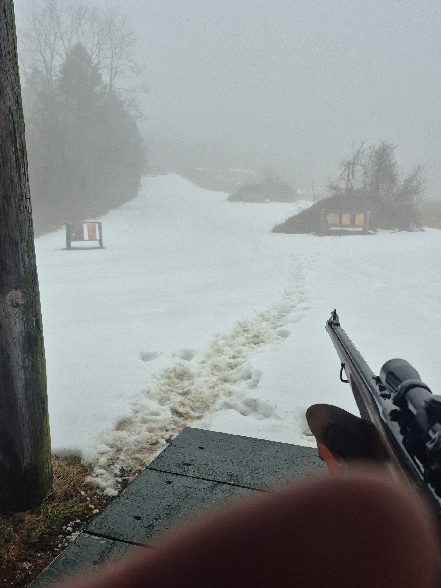

Finally got to the range.About 8" of snow and terrible foggy.Some times could not see any target dots at 100 yds.
Gunsmith said barrel bedding and action from factory was TERRIBLE ! He floated barrel, head to toe, and bedded action.
Worked up 150 gr Sierre SPBT with 4064 .Best group was 45.0 at 1" and 45.5 at 1 1/2".The 4 inch groups were gone and worst was 2 1/2".
Scope was Leupold 2x7 on 7x to shoot.
I can live with that.Gonna try Sierra 180 and maybe 200gr.
