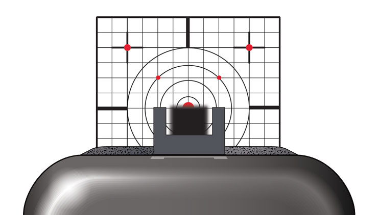

As a firearm instructor,, and USPSA competitor,, the focus of open sights is to be on the front sight. Your eyes can not focus on (3) things at ones. (Target, front & rear) The front is the focal point, with the rear blade being a little fuzzy. The target,, will be the item of least focus due to sizes & different distances.
You mentioned your Redhawk having the "fin" being mostly red. I'm assuming you mean the rearward portion of the front sight blade. Coloring that area allows many people's eyes to pick up the contrasting color when aligning sights.
But as noted above,, you should always use the sight ALIGNMENT shown in s4s4u's picture. But in his picture,, the front blade is fuzzy while the rear sight is in sharp focus. That's backwards. Also,, in his picture,, 1/2 of the bullseye is covered up with the front blade. Most often,, it's taught to put the entire bullseye dot in alignment to where it appears to "sit" on top of the front sight. Or as I say; "Sit the ball on top if the front sight line, while having the rear sight aligned with that same line. Equal spacing on the sides of the front in relation to the rear."
