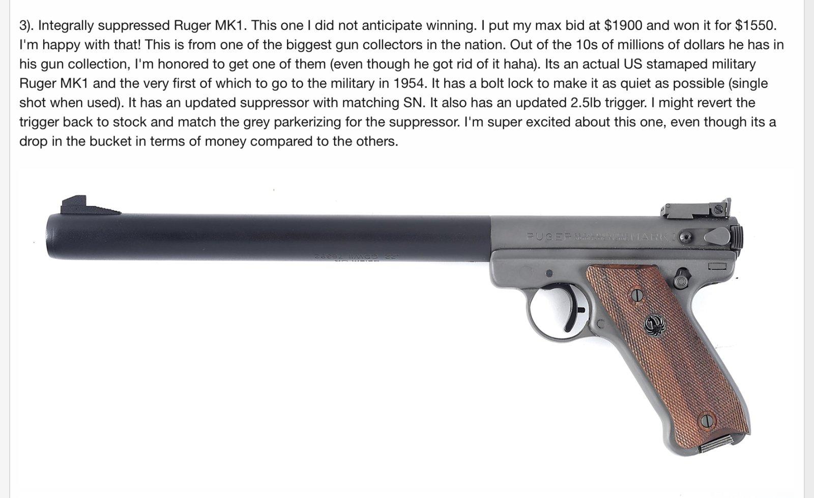

There are different mechanical ways to bolt lock a Ruger Mark, but I don't think the juice is worth the squeeze. That said, some of the designs are fascinating mechanically, and pretty cool and collectible if found on an ex-government gun like this one (which is not my gun):
