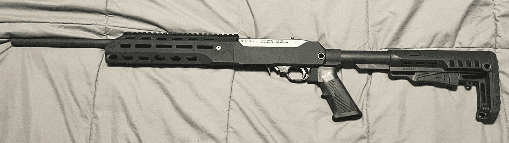

I just put a 10/22 into this chassis from Jager: https://jagerpmc.com/ruger-1022-rifle-chassis-system-2-piece-black-type-iii-hard-anodized/
