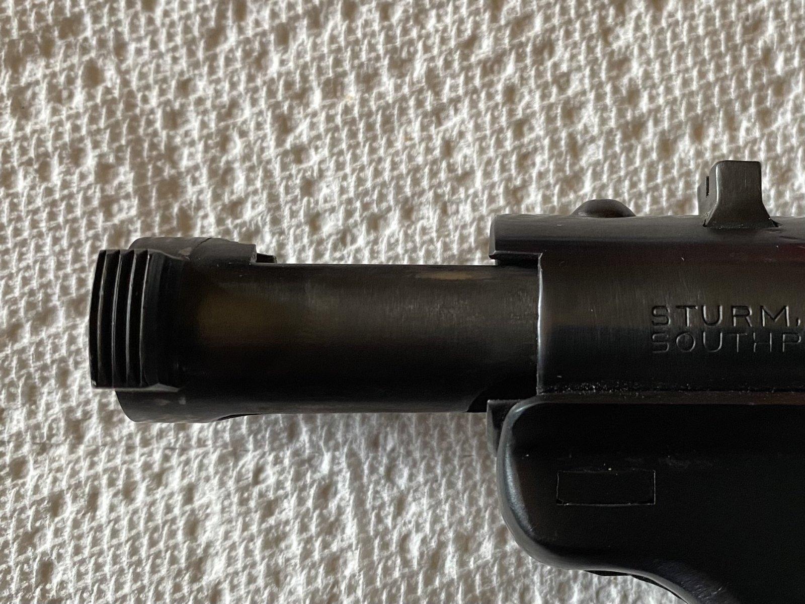

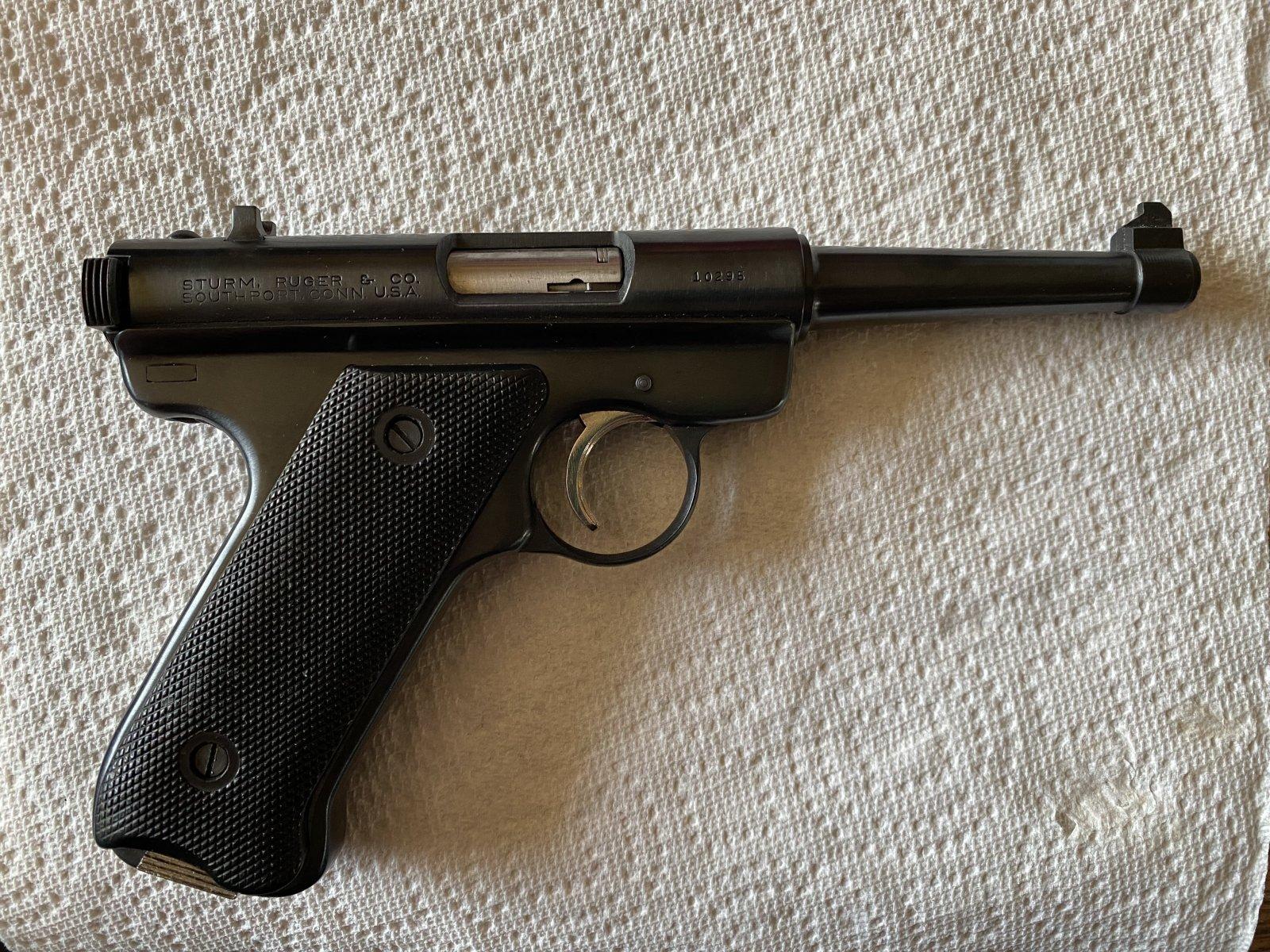

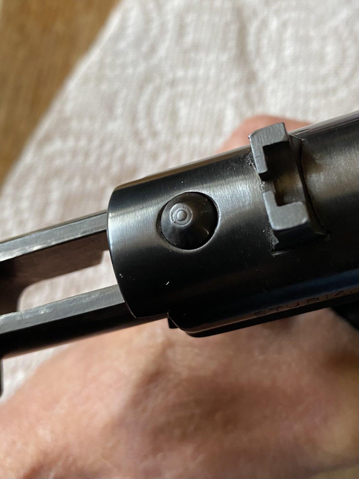

It's just the back half of the bolt that is blued. I asked the person I purchased it from if the bolt was all in white when he sent it to Ruger in 2014 but he couldn't remember ( he sent the pistol to them because something was broken, not to be refurbished. Ruger called him and asked him if he wanted it refurbished and reblued for an extra fee and he said yes, which as far as it being a 1950 Red Eagle might not have been the best idea). The rear sight and the bolt stop appear to be correct for the 1950 serial # according to the Hiddleson book. His book shows "long throw" and "short throw" magazines. I don't understand what that means? I believe this pistol to be a "type XI" , late 1950?

"I believe this pistol to be a "type XI" , late 1950?"
RENE would say it's a Type 6 (VI) . . . not a Type 11.
I'm guessing your bolt is original. JMHO
VERY nice pistol! 😁
Yes, type VI. I don't know my roman numerals .
You think the bolt was originally blued ?
The reason I am confused is in Hiddleson’s book it says “C, this all blue bolt was used on Standard automatics from 12214 through the end of Standard automatic production “. My serial # is 10295 ( below the number stated.)
By “all blue” I believe he means the back half was blued behind the ejection port opening.

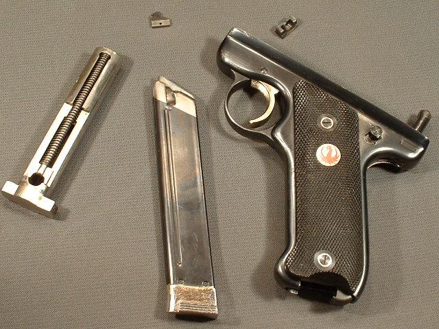

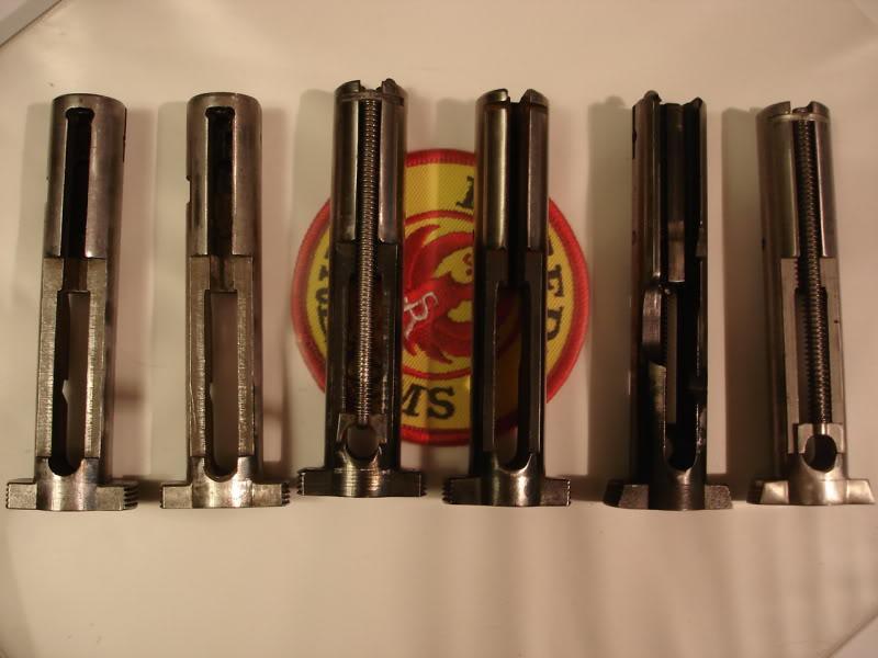

as I said in my reply above your gun and that serial number, the bolt should be in the white, the whole thing ,it is when it goes back and gets redone or the bolt replaced, or it was reblued by just about anyone (gunshop or the factory) then it is white in the front half and the rear will be blued, they polish off the front portion ,that what you see looking into the ejection port, with the bolt forward ( closed)........
here are the early parts for example............and some others
