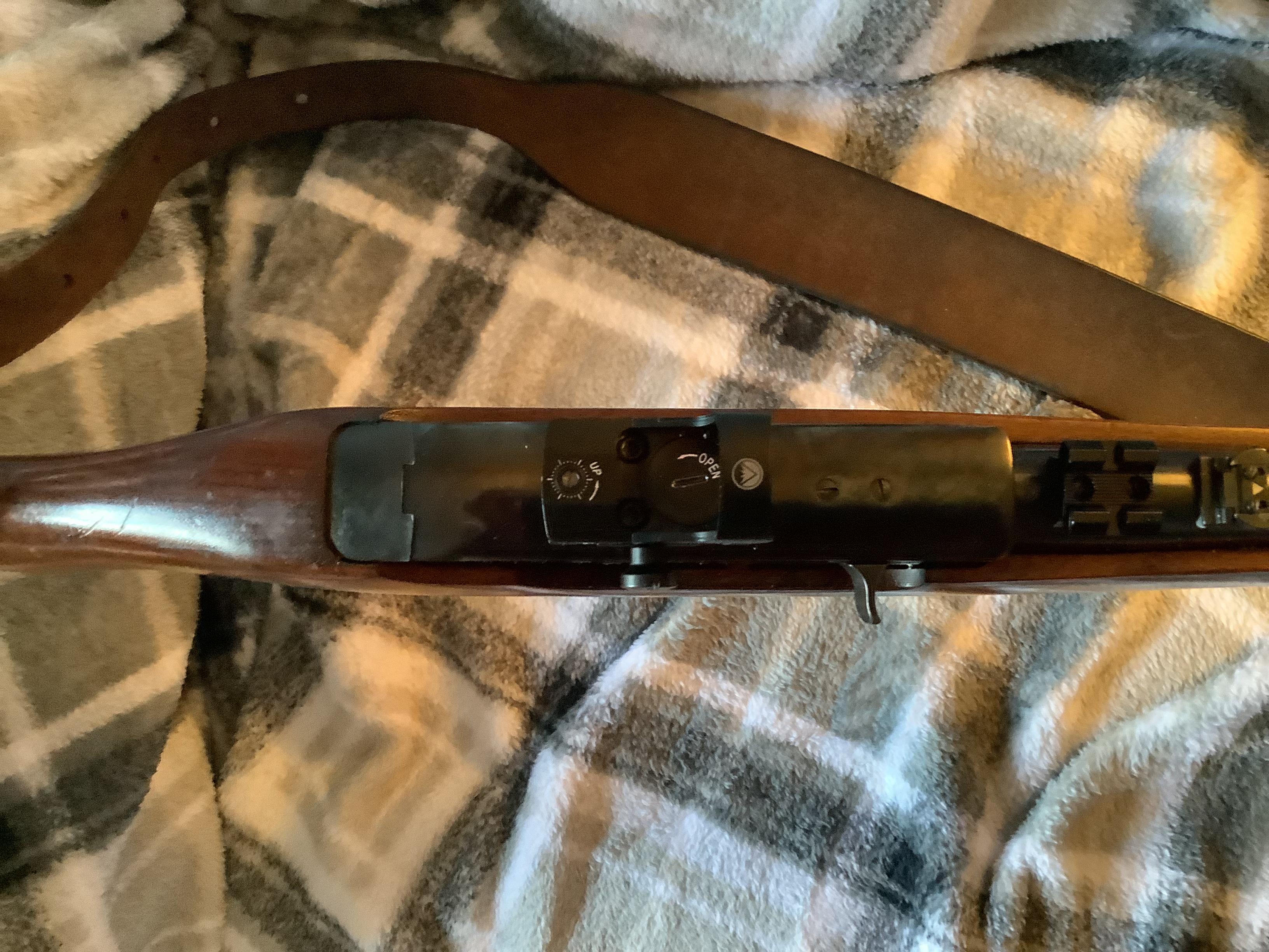

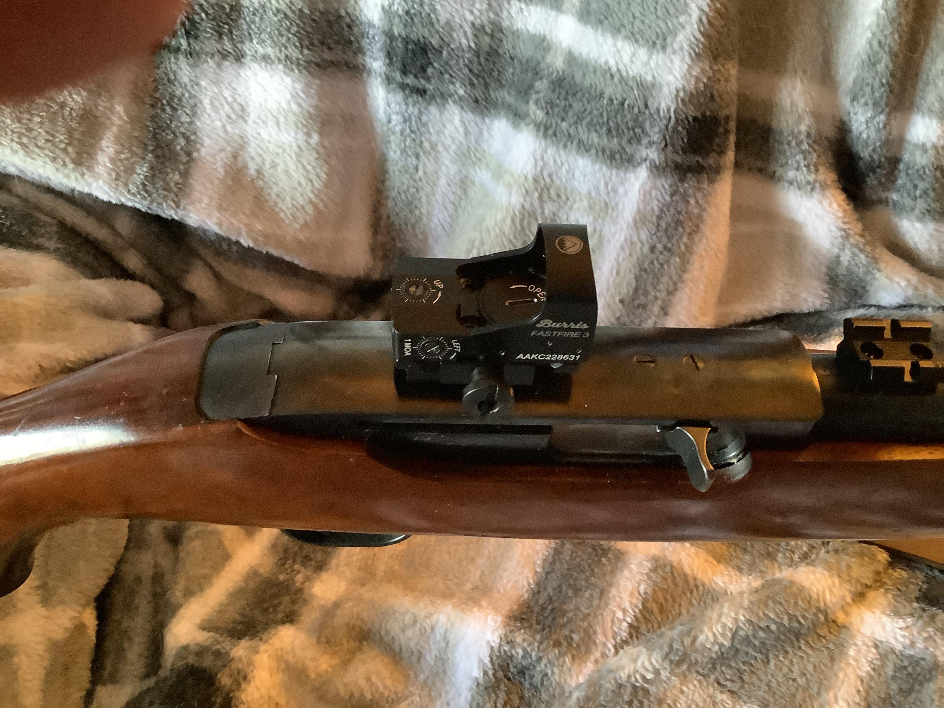

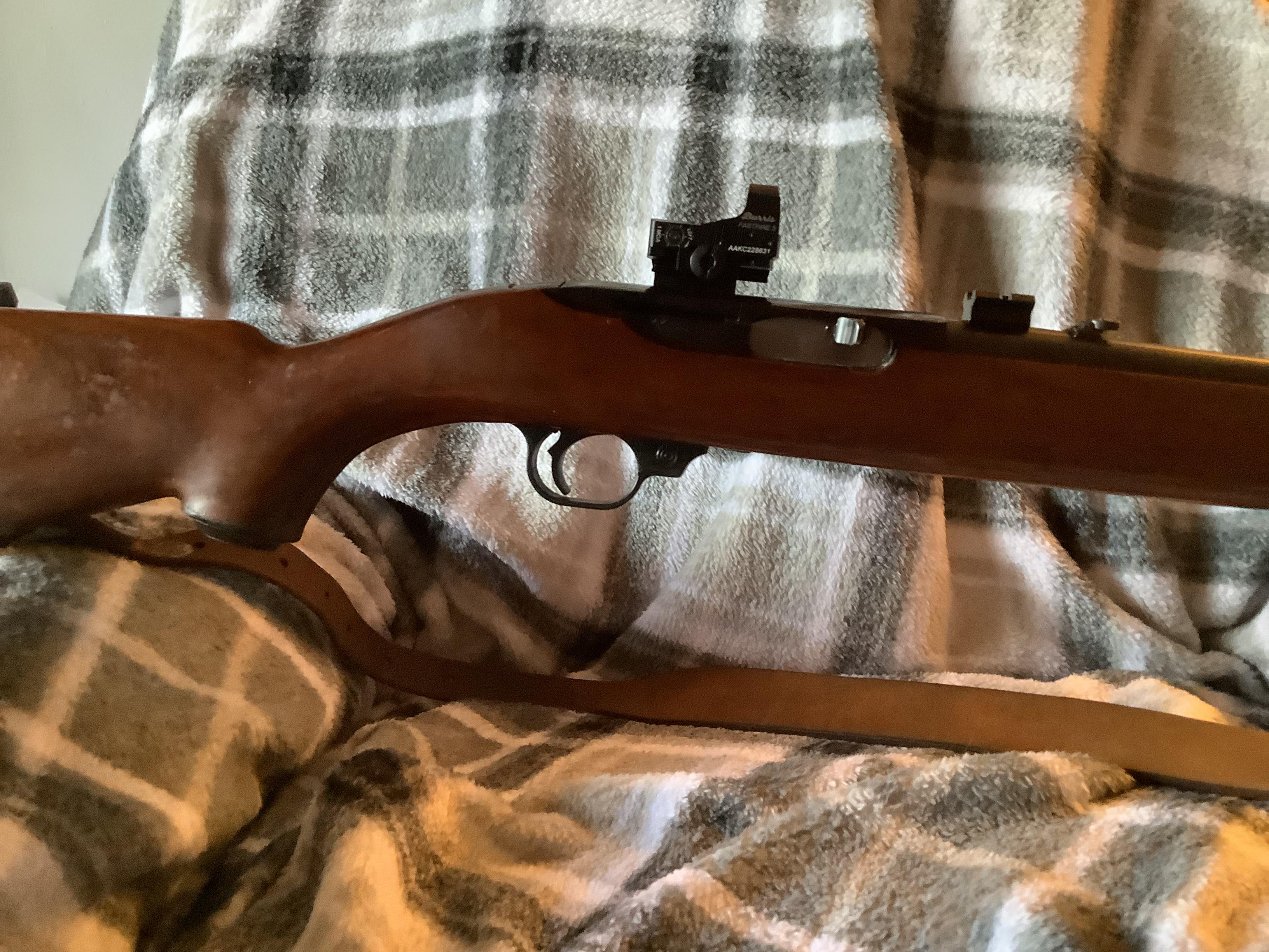

Sorry Mobuck just saw this. the Burris Fastfire III was delivered today and I mounted it. I got the weaver 68 and 47 bases and the sight comes with base that mounts to it. I’m pleased with piece. Very small, dot quality is good, weights almost nothing. Can’t wait to get out there with it.

I would remove the scope blocks, put the original low rail on the rifle and the red dot on it. It will sit considerably lower and should improve the sight picture/handling a good deal.
It was a toss up deciding to go with the rail or the weaver blocks. It boiled down to me not caring for the look of a long rail with a small red dot mounted on it. In retrospect I might backtrack and do the rail. Lowering the dot might be more more important then appearance. Then again I have an Aimpoint mounted on a Larue mount that sits even higher on my Colt M4 and it suits me fine. I’ll try it as is at the range and decide which way I’ll go.

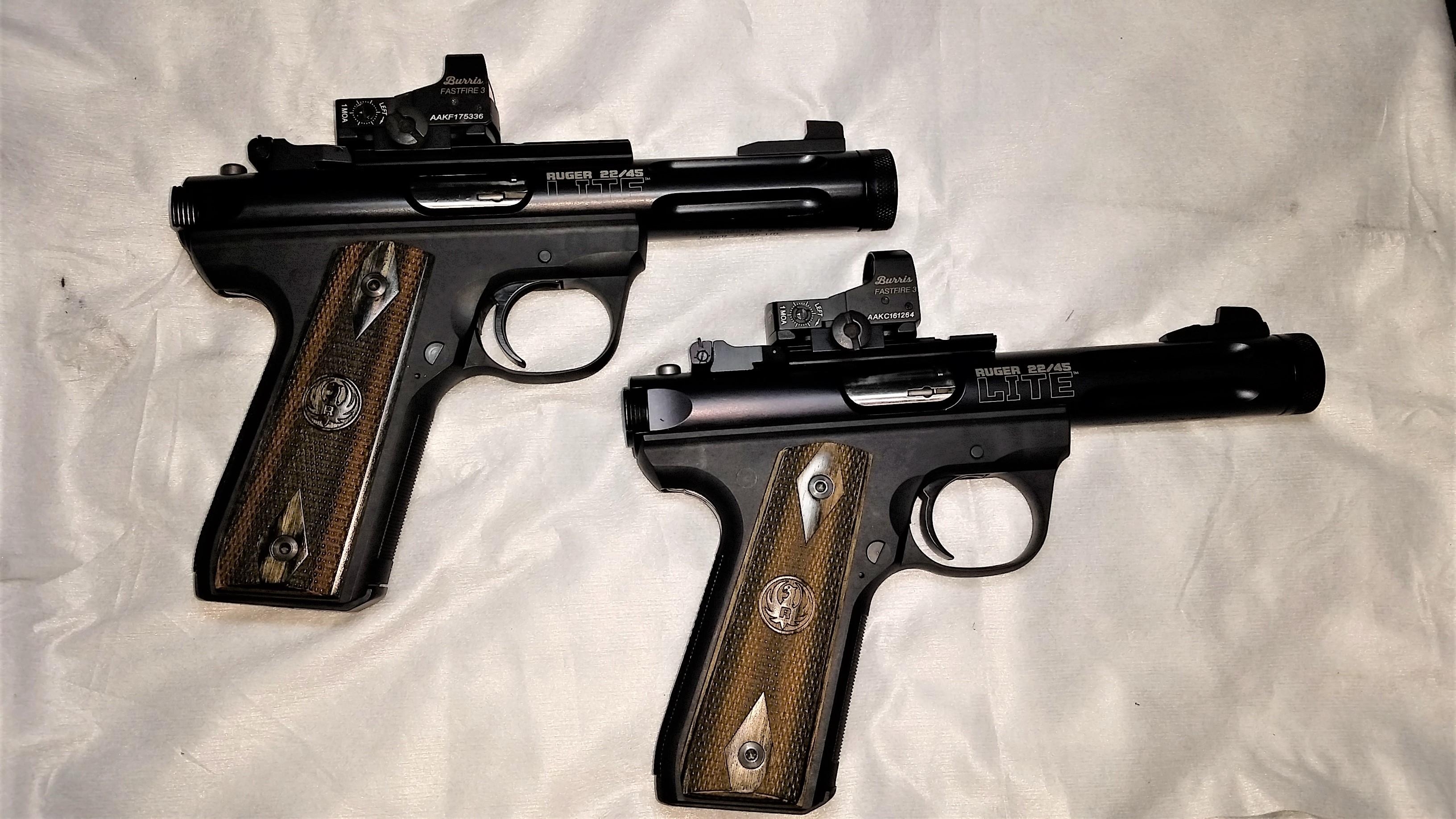

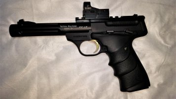

You can always cut the rail shorter as long as you have two screws in it. I did it on my 22/45's and Browning
