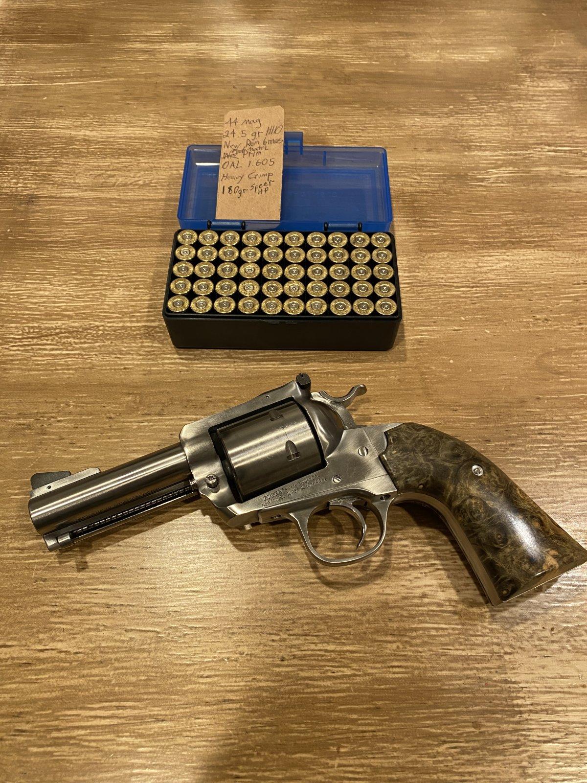

I am trying to shoot up some of my loads from my Lee dipper days. I shot this string of 12 today all loaded with a Lee dipper and 24.5gr of H110 powder. The bullet used was a 180gr Speer hollow point shot out of my 3.75 inch SBH bisley in 44 mag. This is the best SD and spread I've ever had with the dippers.

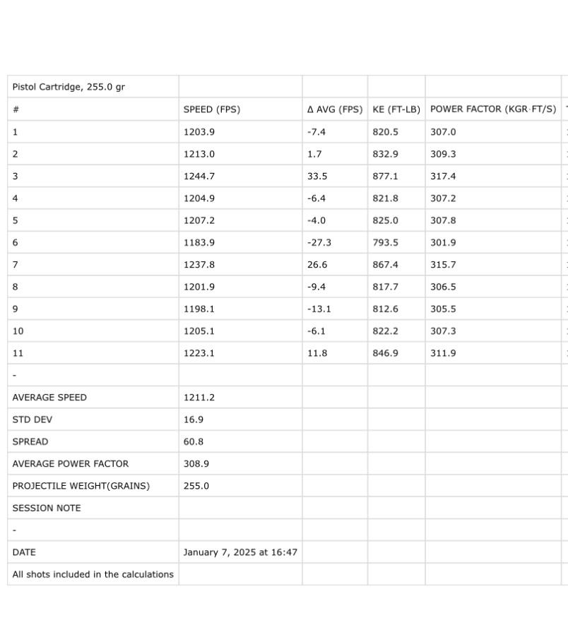

The 24 shot string is 255gr extreme flat points with 6.7gr of W231 done on the Rcbs powder thrower. These loads were shot out of a 4 5/8ths blackhawk chamber in 45 colt.
this last string of 11 shots was out of the same 4 5/8th blackhawk in 45 colt. These were Ruger only loads with enforcer powder and 255gr coated lead SWCs loaded again with the dipper. Not bad!

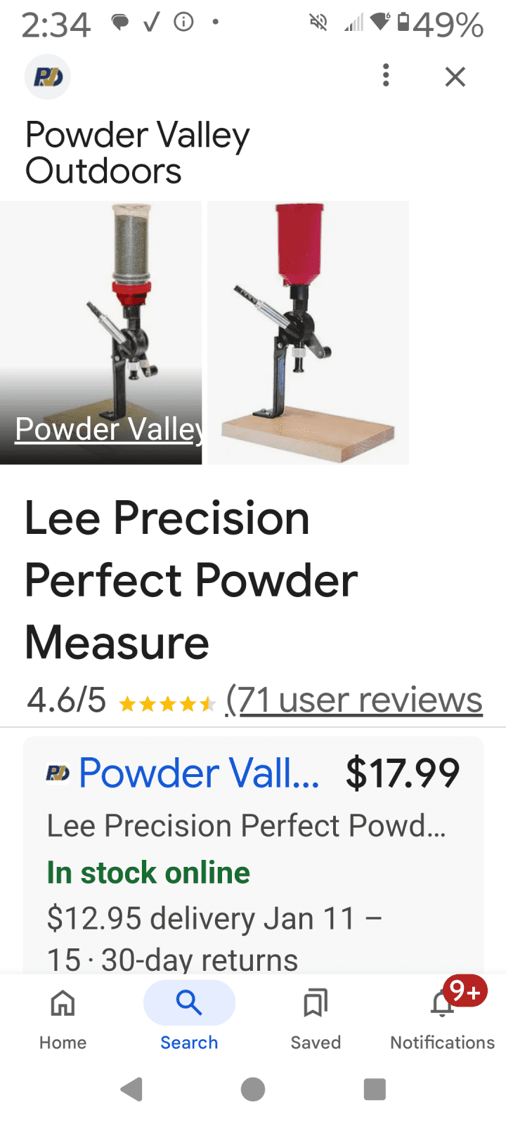

I have not tried the Lee perfect powder measure. I have this electronic Franklin powder thrower coming that is supposed to be super accurate my brother has it and loves it. Should be here in the mail today.
hvymax have you chronoed loads with the Lee perfect powder measurer?
Always. It's way more accurate than the scoops. And probably way faster than what you are getting. I hold the case under it, raise the lever to fill the measure and tap twice to settle the powder, lower the lever dispensing the powder and tap twice to make sure it's cleared. Everything goes directly into the case. I tried using the dippers and they take three times as long and wasted more powder trying to level them and pouring. The precision tricklers are OK but you are still dumping loose powder into a funnel or something.

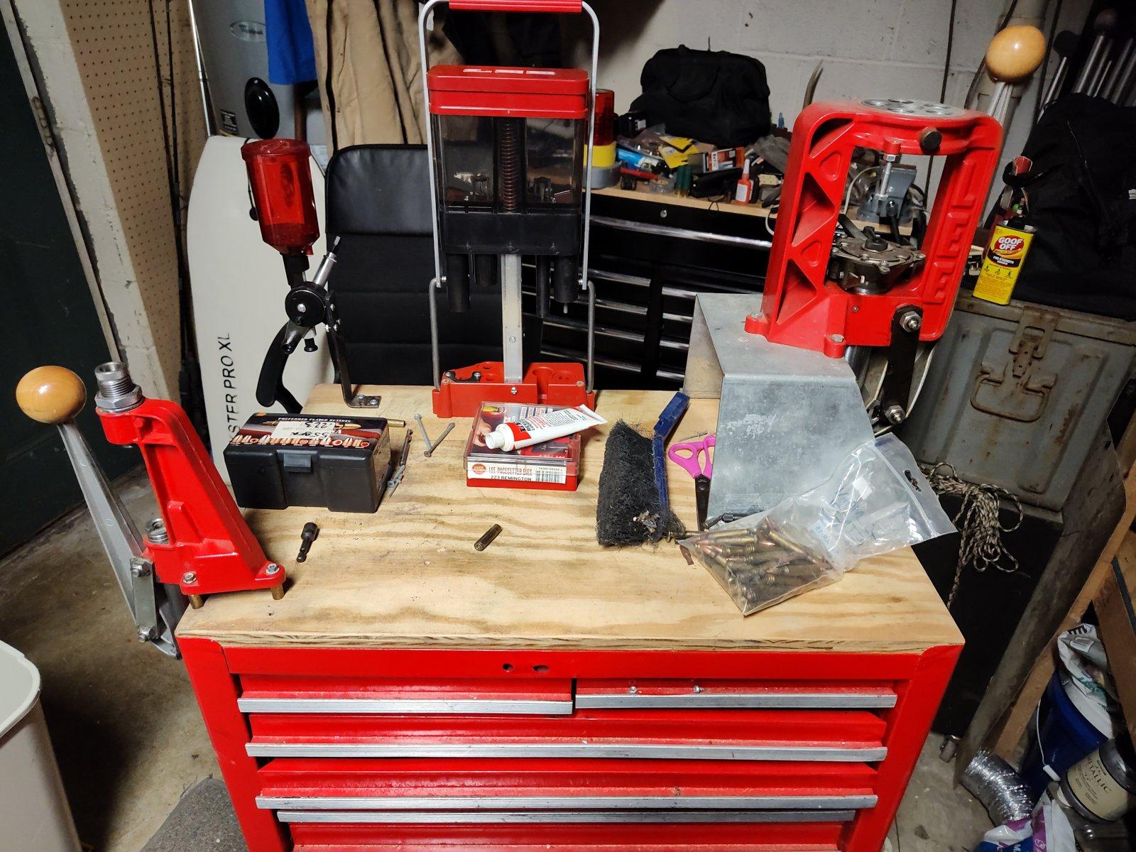

Yea it's probably going to be slow for higher volume shooting but I'm ok with that. Reloading is zen for me. No rush, it's nice to sit at the bench, not worry about the past or stress about tomorrow. Fully focused in the here and now.
Nice setup you have there!
