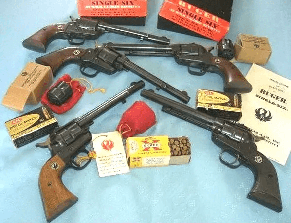

The description in the RENE guide is confusing. I have a magnum only, in the serial number range. It's not labeled magnum, but .22 cal. Correct box labeled RSSM, also came with extra cylinder.
I have one also but the type matters too as stated. Here's the box for my 2-cylinder gun.
