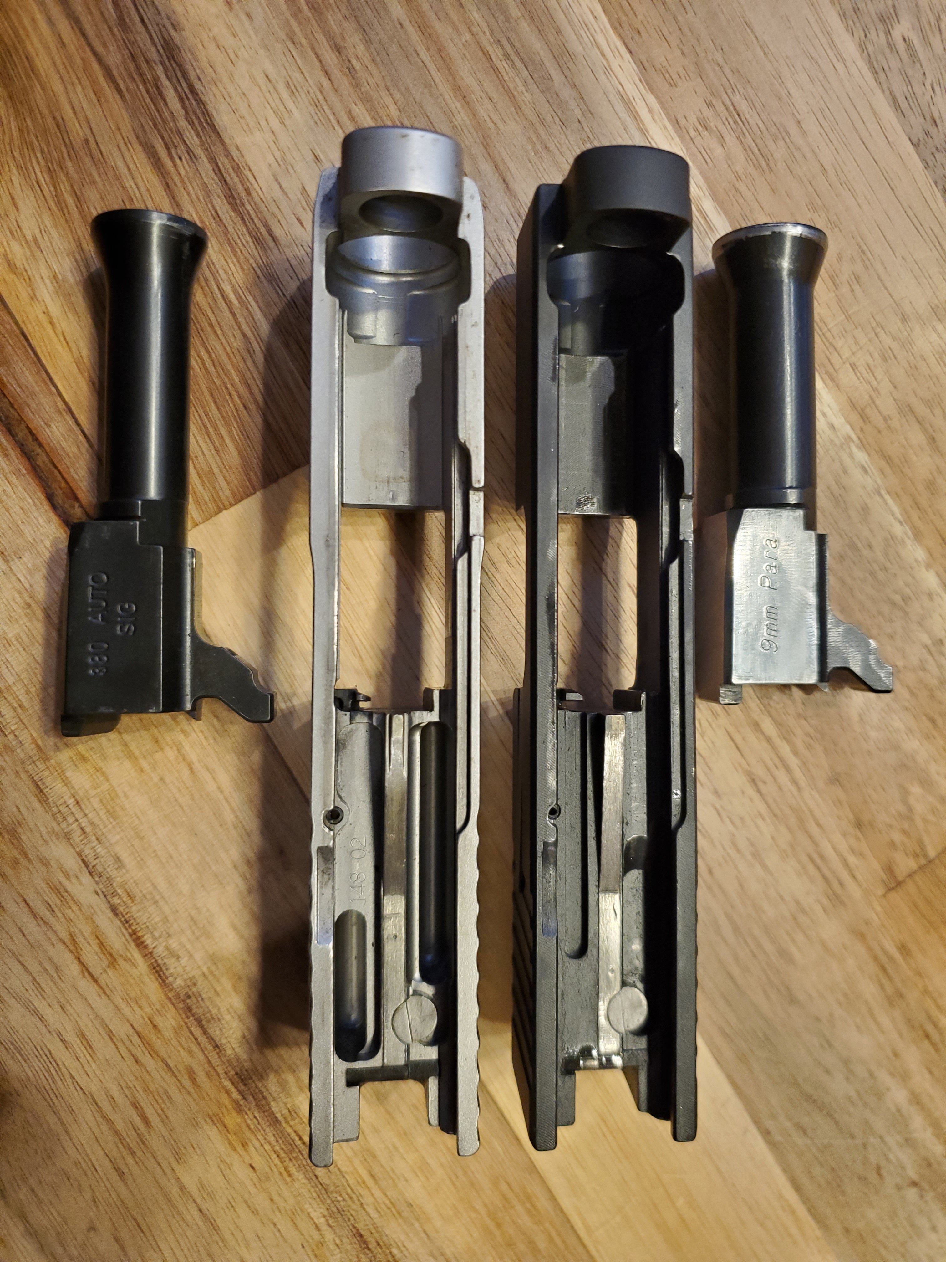

If I remember this afternoon, I'll take a picture of similar cuts in a Sig P290. They are a necessity for .380 locked breech pistols built on 9mm platforms.
Below, comparison of Sig P290 slides for .380 (silver) and 9mm (black). Lightening cuts clearly visible between feed lug and slide rails of .380 slide make it 2.3 oz lighter (7.1 vs 9.4 oz), paired with a shorter recoil spring to allow the .380 slide to function properly on same lower frame as 9mm.
I suspect the Security 380 and Security 9 Compact have more or less the exact same relationship.
