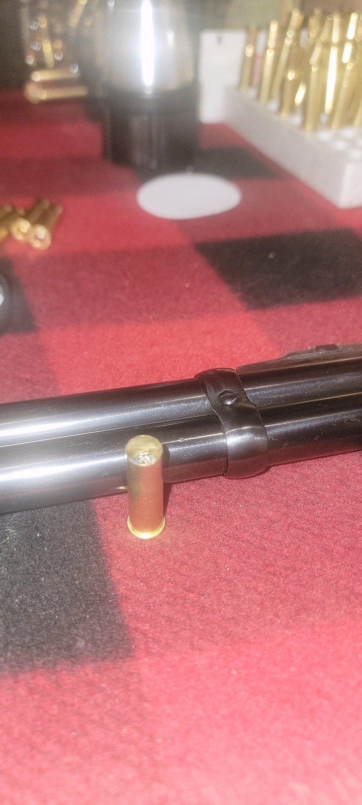

I will only go by manuals or at least cross referencing between manuals but have a ? I read where 13 gr of imr4198 with 100 gr jsp was 1600 fps in 32/20
OK then i read 3.5 gr of unique was close to the same fps. I know looks does not count but 13 gr 4198 fills the 32/20up to where the bullet will slightly compress the load. Im skeptical of a case that full. If its safe ok but i want to know first not after.
I know when the air space is remove with powder or other filler the burn rate and pressures change. Im just a skeptic who does not want to ruin a gun or me.

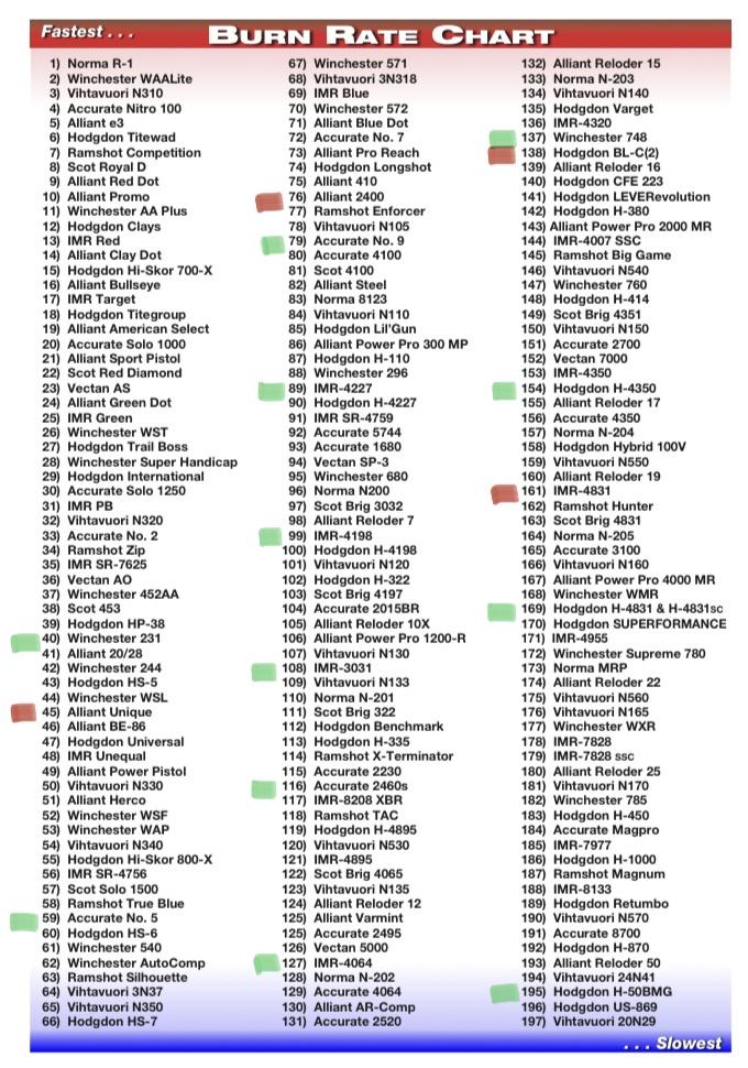

heres a dumb question.
Burn rate charts? Do they have a numercal rating or is it just fastest on top of list progressing down the list to the slowest.
Just a relative rate. This is the chart I use, but there are many others.
