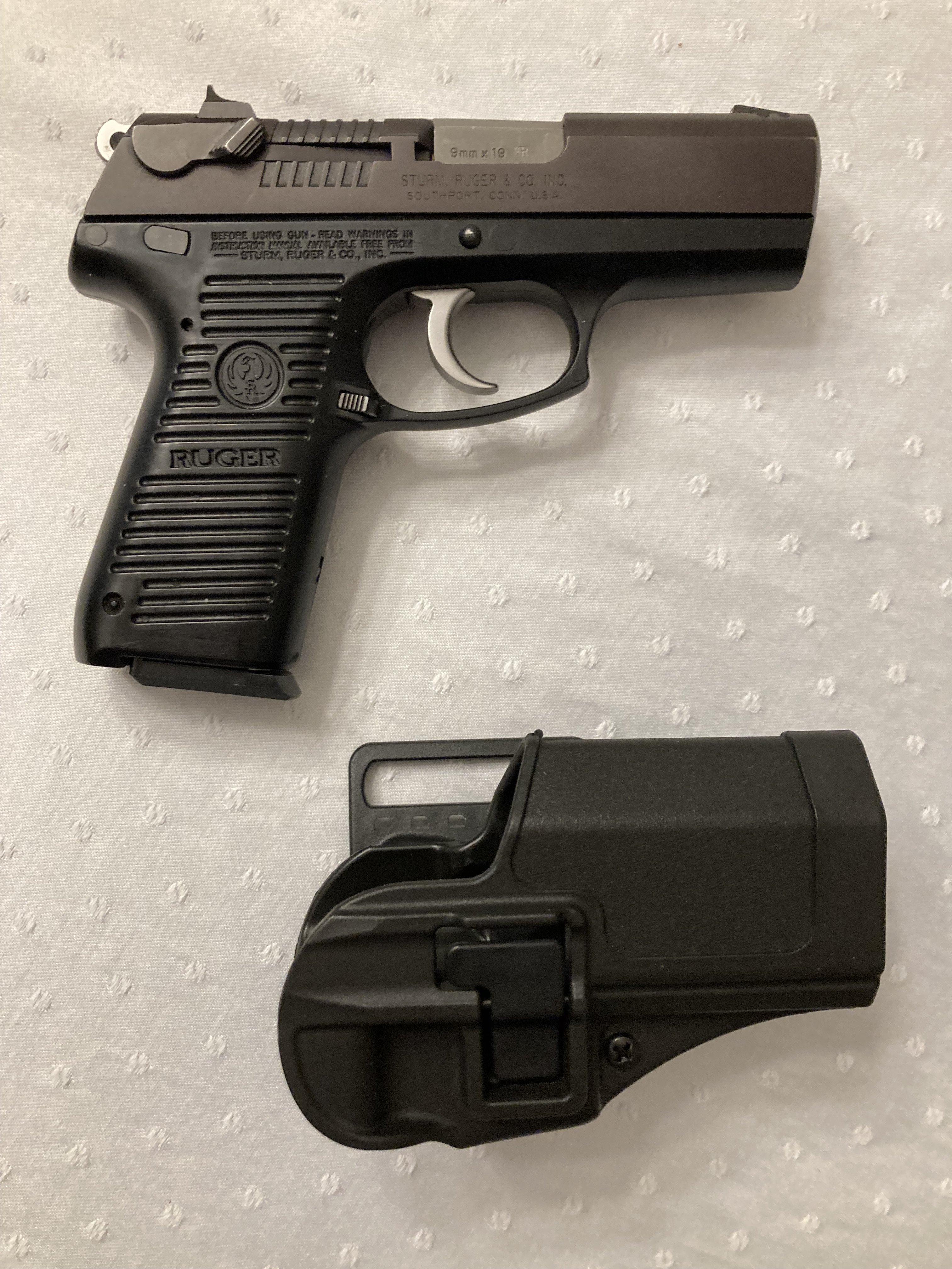

Long ago, (like Thing 1's first marriage) I purchased a P95 that the SIL at that time wanted to use so he could be an armed security guard. Have they ever made Tritium Night Sights for the P95 as the original sights are almost useless in low light? Anyone else still using the P95 for anything other than dead weight?
