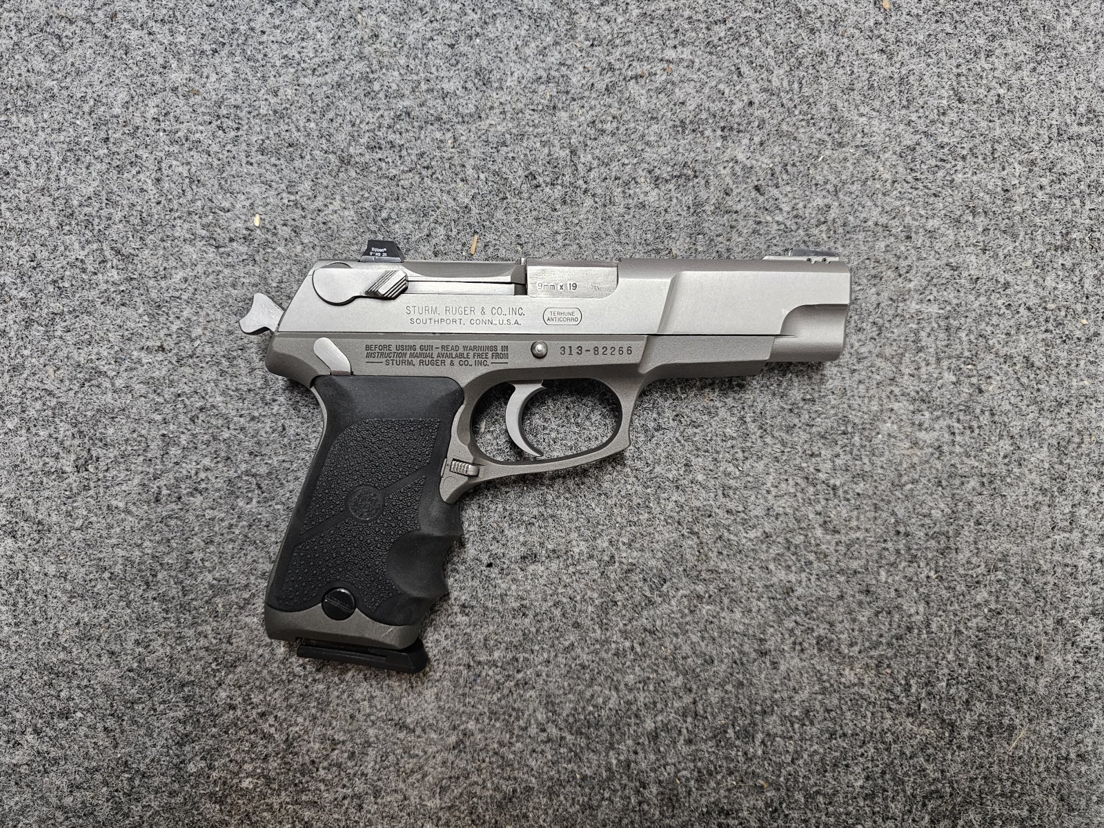

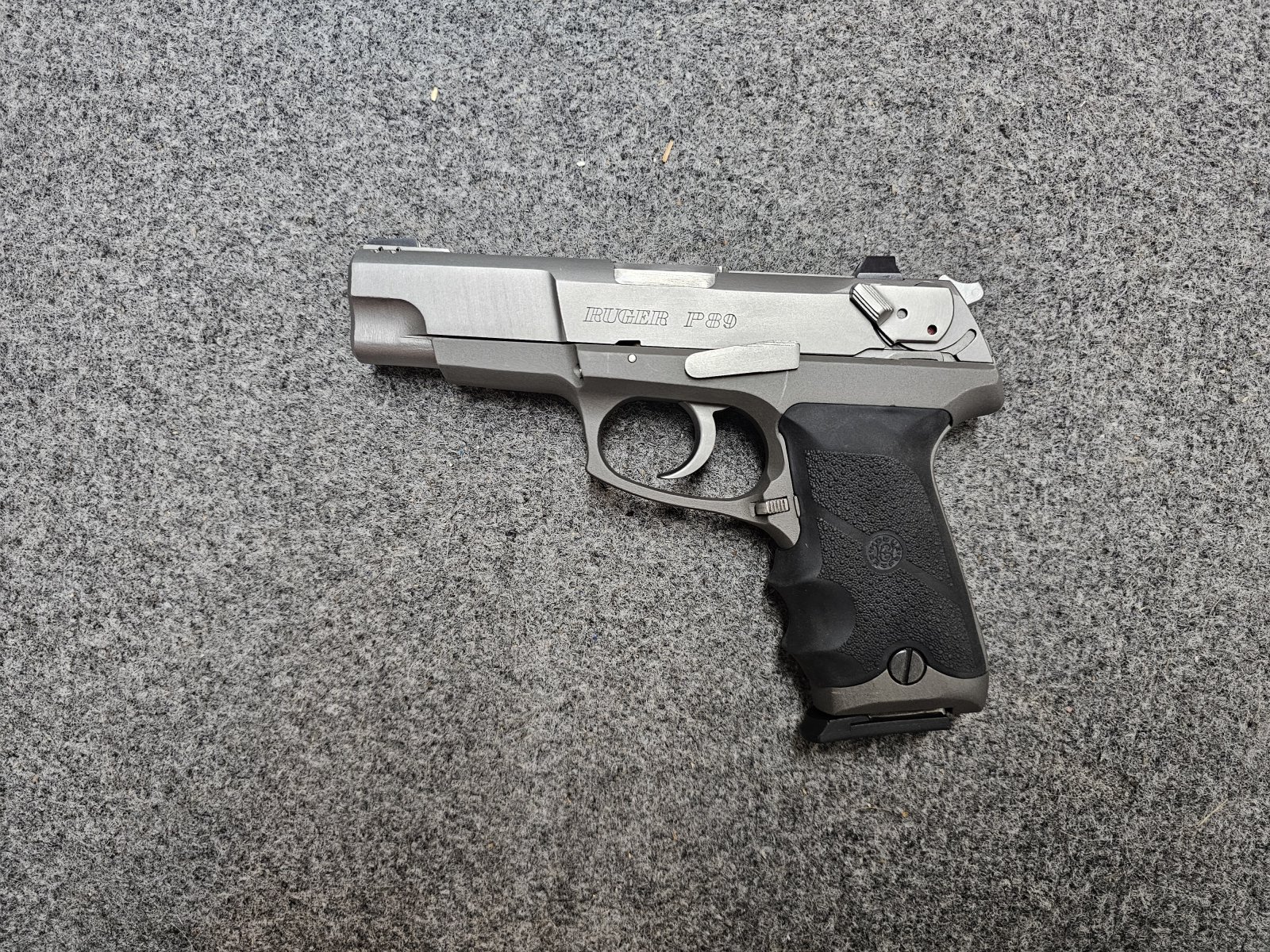

Picked up a used P89 safety model this spring. Made in 2000 it had some old Trijicon sights, but faded horribly. Gave them a call and got it relamped for $50. Then added a P95 trigger w/19lb hammer spring. What a difference that makes.

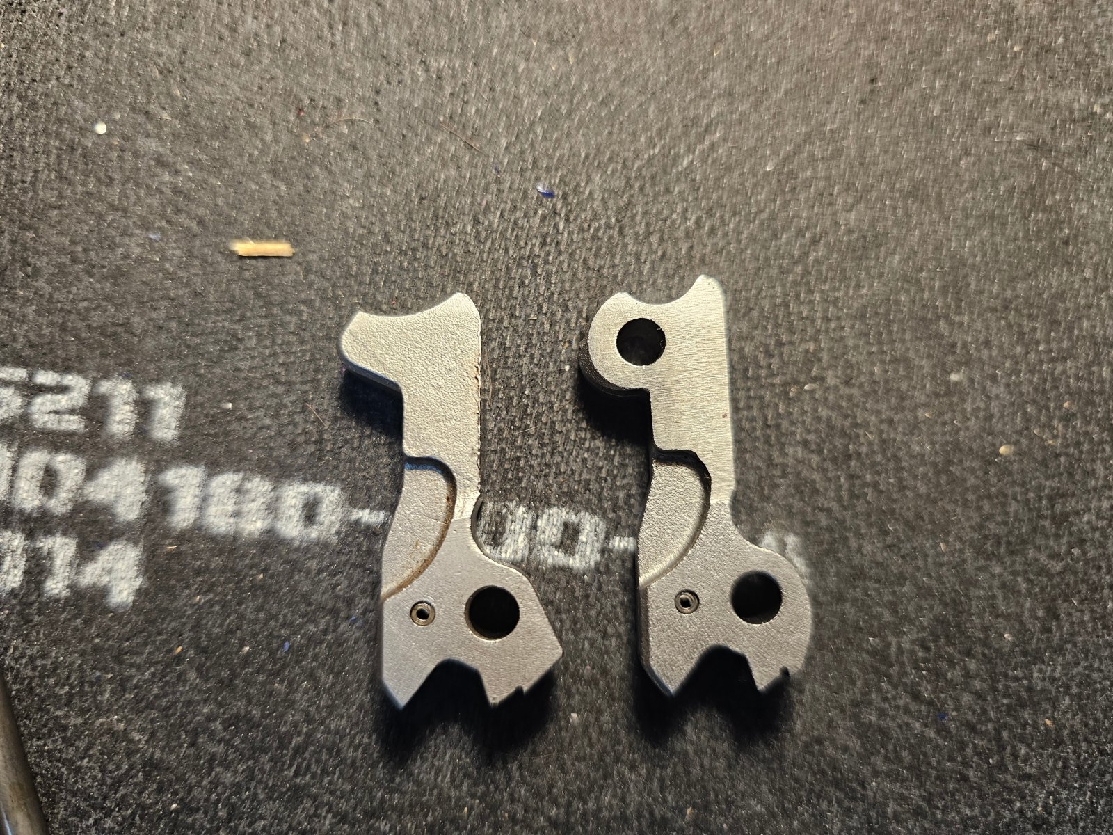

Then on a whim I decided to try a different hammer. Found that the P345 hammer was nearly identical w/minor fitting. Topped it off with some hogue rubbers and now it feels like an entirely different pistol

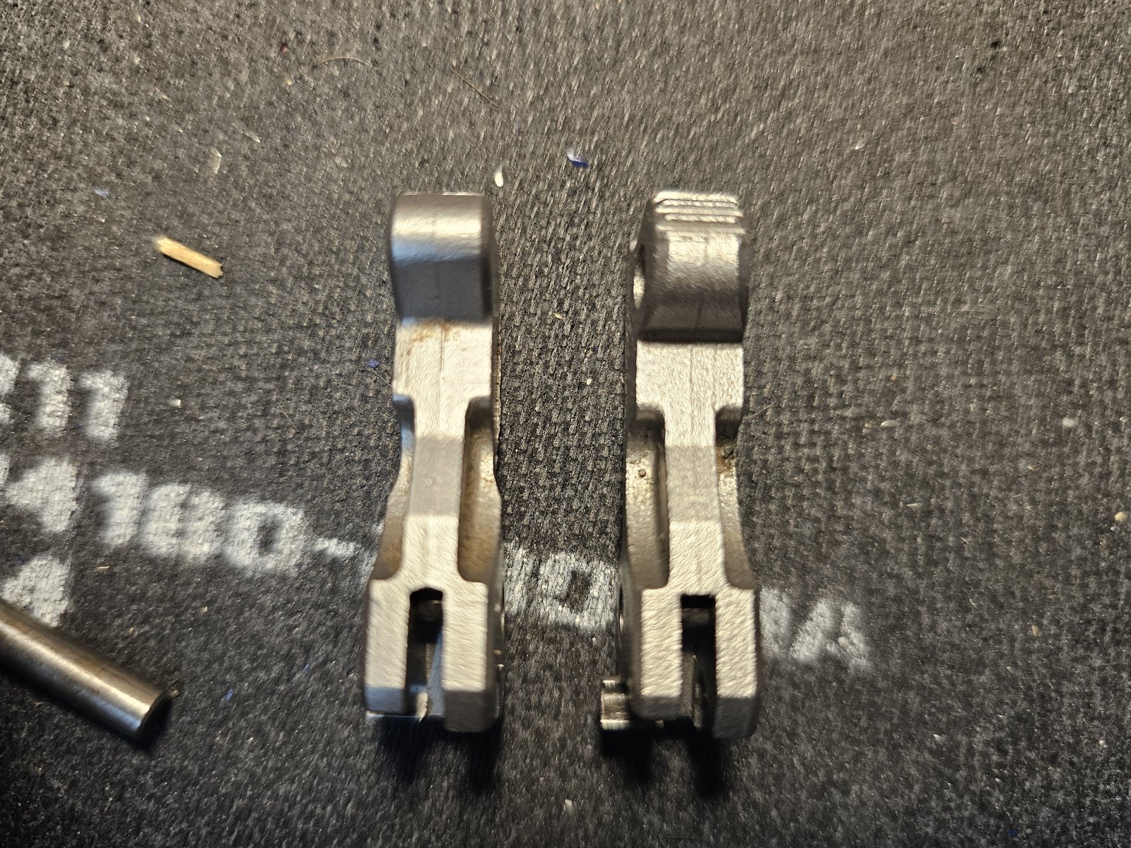

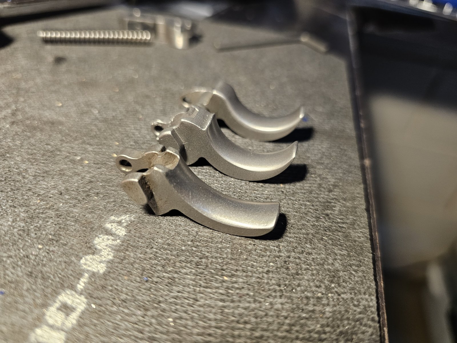

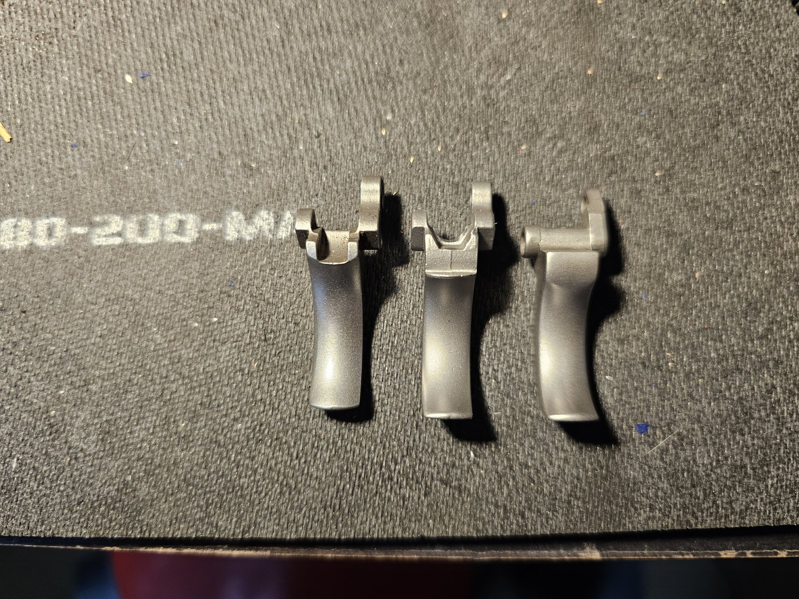

The P95 trigger was drop-in, but it did require the center channel to be ground out to clear the barrel link. Here it is 'center 'after the work was done compared to the p89 trigger 'left'. A p345 'on the right' was thrown in for comparison but its entirely a different setup

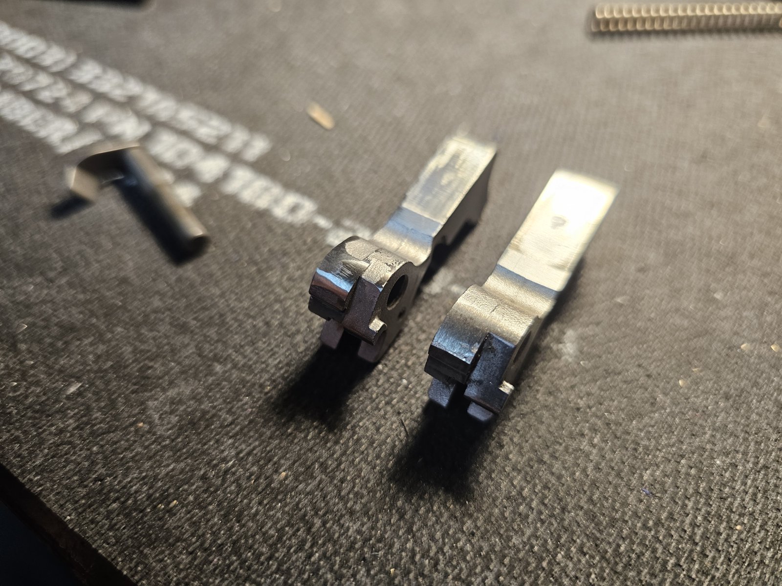

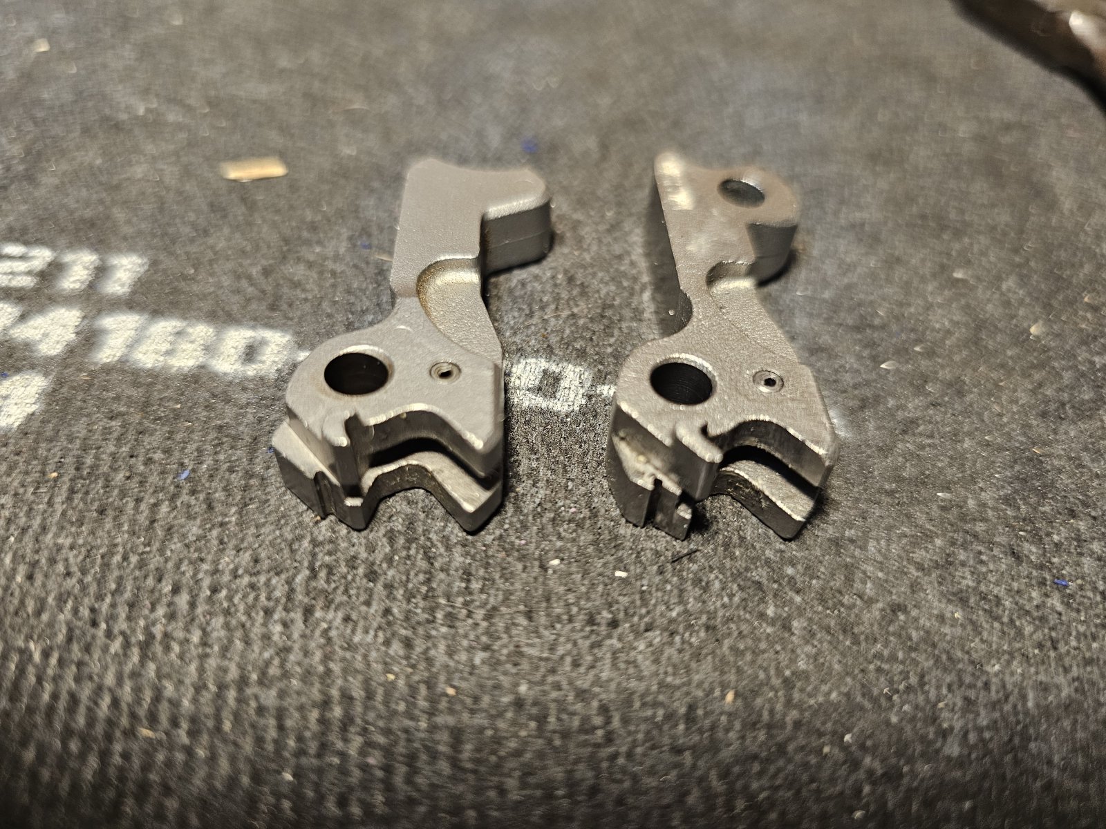

Here you can see the hammer profiles. Its a tad narrower but hardly noticeable

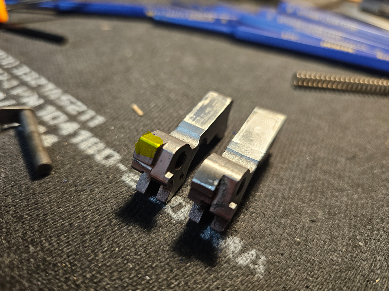

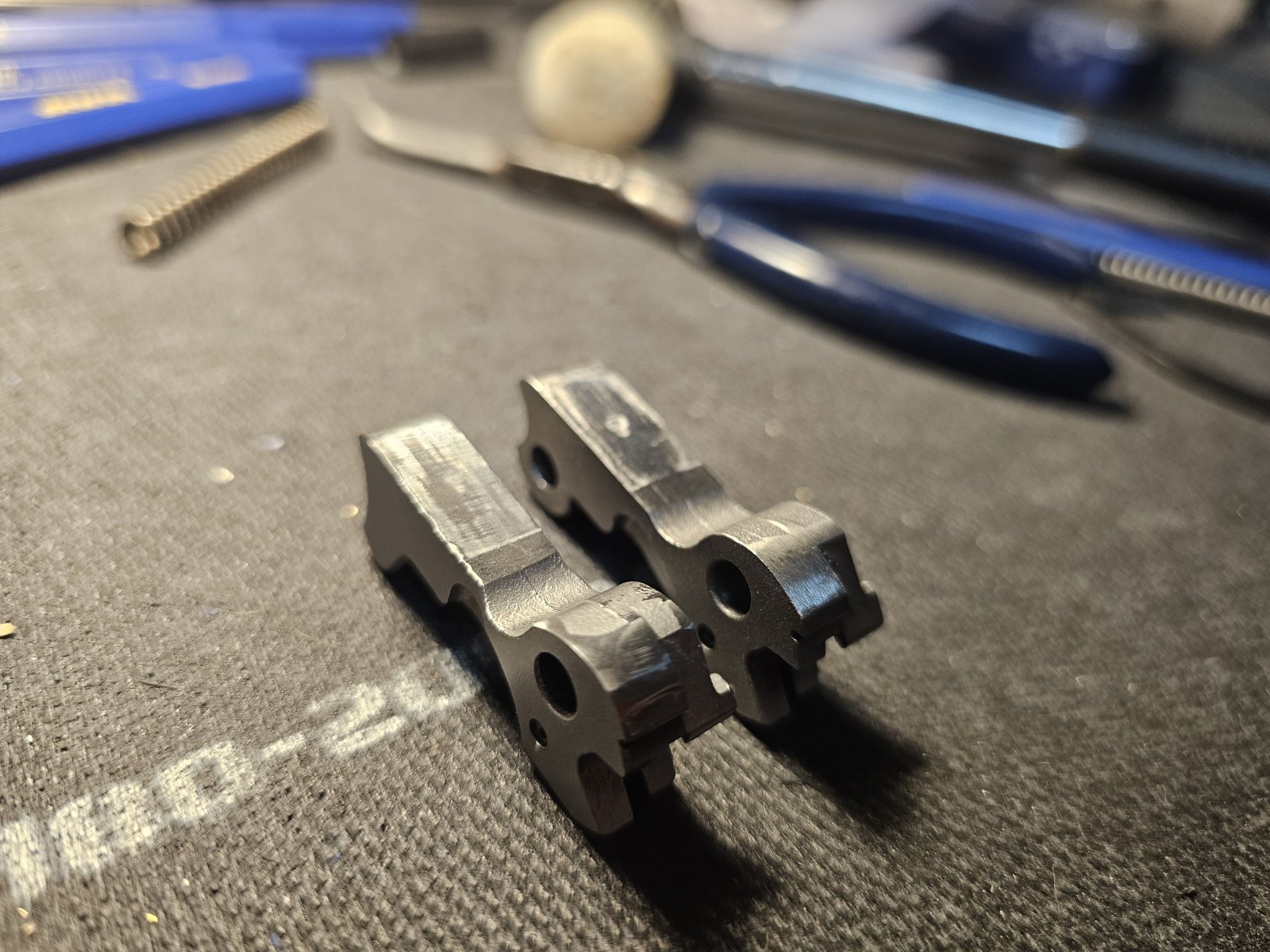

First thing I noticed it wouldn't engage the sear when cocked. Then I noticed the front had a significant hump on the face
So just rounded it off to match the profile of the p89 trigger. Not the cleanest look but its functional
