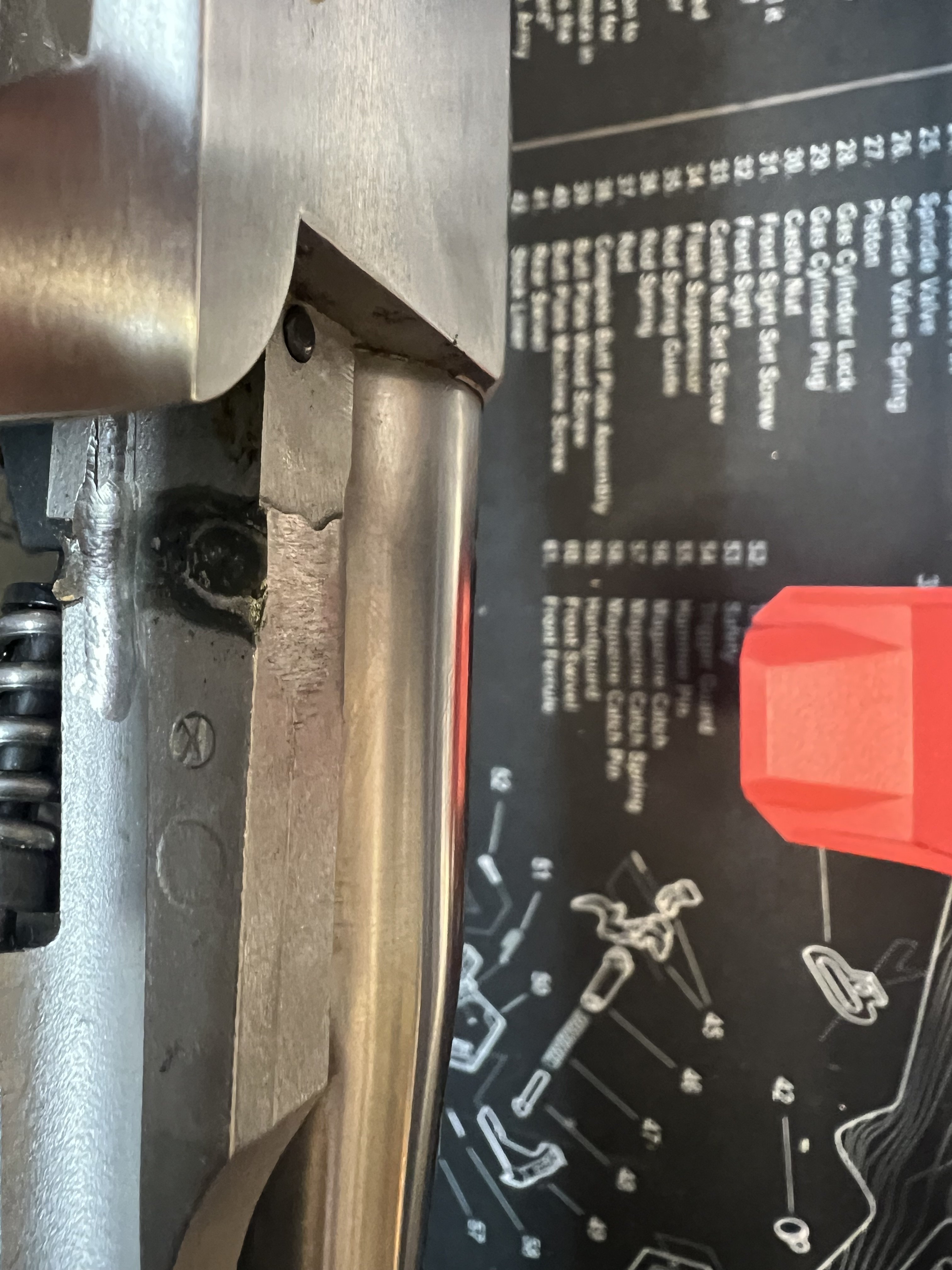

Wonder if Ruger thinks it can be fixed or what they’d charge.
I sent the shop an email. I will contact Ruger tomorrow. It looks like the bracket (forend hanger?) that cracked off and was welded is part of the receiver. Sigh….
I'll bet Ruger declines repair. That hanger is an integral part of the action repair would require replacement of the action. If that were some sort of warranty thing, they might replace the action. But they will probably touch after this repair, no matter what.
I wonder how that happen?

I was thinking the same thing but it’s not just the forend hanger.
There are 2 springs anchored on that piece. If it breaks off, the action will loose all integrity. Under recoil you will have the forend and both springs in one hand the recoiling rifle in the other.
I sent you their information
Seems to me the action has already lost all integrity but maybe I’m more squeamish than other shooters.
The seller though ….. no loss of integrity there since he stepped up and did what’s right!

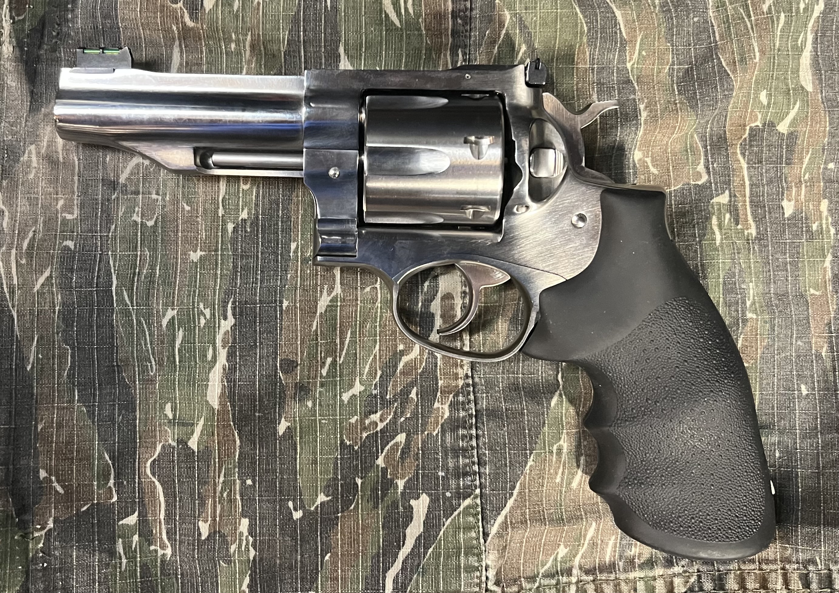

I’ve been looking for a used Redhawk locally for a few years, but never found the right deal. So I was going to order a new one with my store credit. But that meant another trip.
Yesterday a used Redhawk popped up at my LGS!
I returned the rifle and they gave me a full refund so I picked up the used Redhawk on my way home.
All things considered it all worked out good. Glad this is resolved Thanks again.

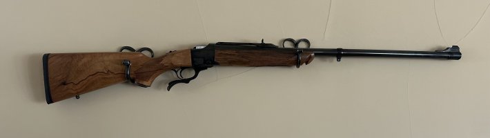

.45/70 Wall hanger.
Only modern firearm I've got displayed. Think the No.1 in .45/70 with the 26" barrel, Circassian walnut stock and high polish blue are just classic looking guns!
Couple of friends at Ruger NH helped me out with this one at the time.

Hate to burst anyone's bubble, but that weld is on every No. 1 I own and everyone I've ever seen, at least a couple of dozen. It's part of the manufacturing process and perfectly normal. Blued models are a bit harder to see the weld and it's more obvious on the stainless models.
I know how this happened. The Factory did it. I am wrong in thinking this was some sort of non factory process.
He is absolutely correct. I just checked my two rifles, and both have this weld, and it is a little harder to see on blued models as MIshooter says.
Been a few years since I rebarreled guns and not many No. 1's, a few. (counted the years on my fingers, just shy of 40 years) But I never noted this feature. Or maybe in 40 years, I just forgot about it.
They must make the action without the main spring hanger. Inteesting.
