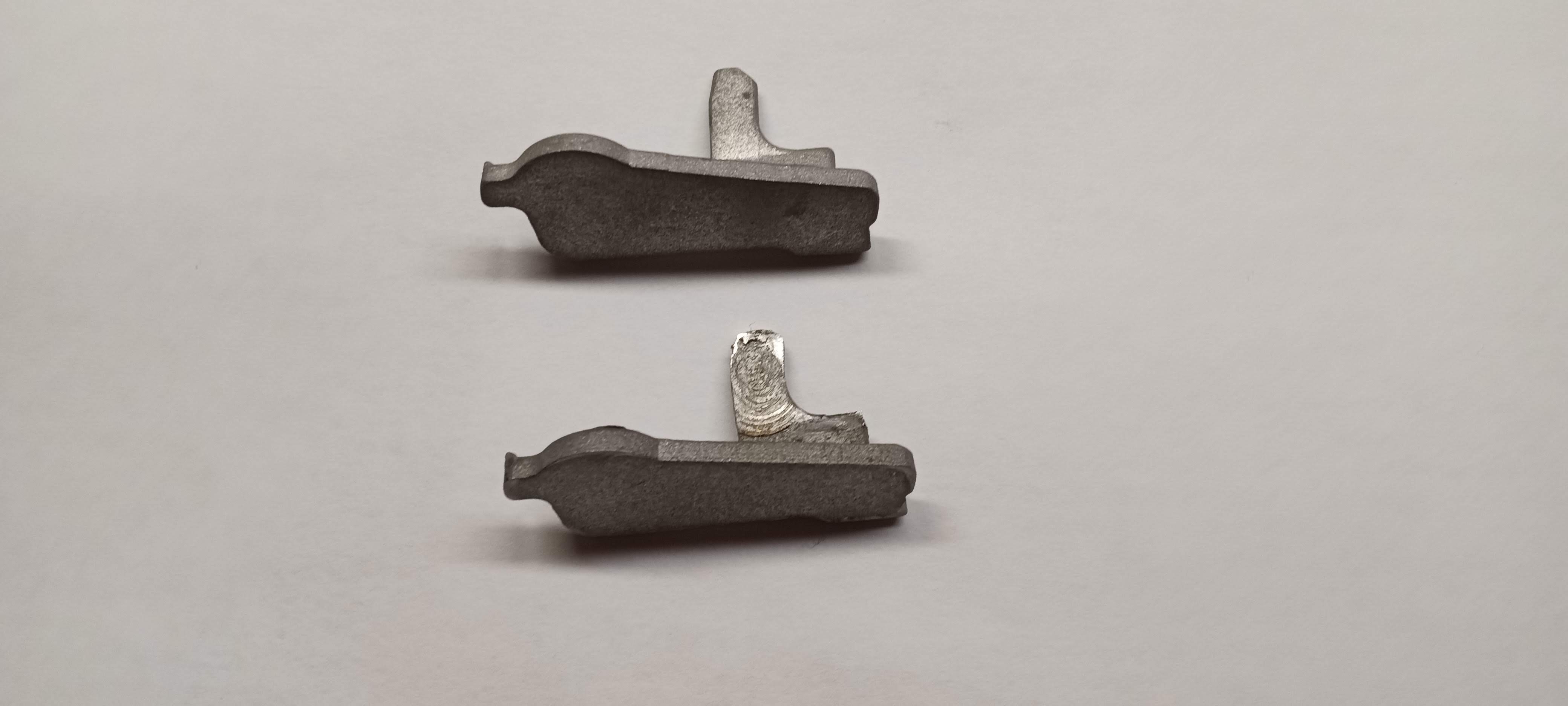

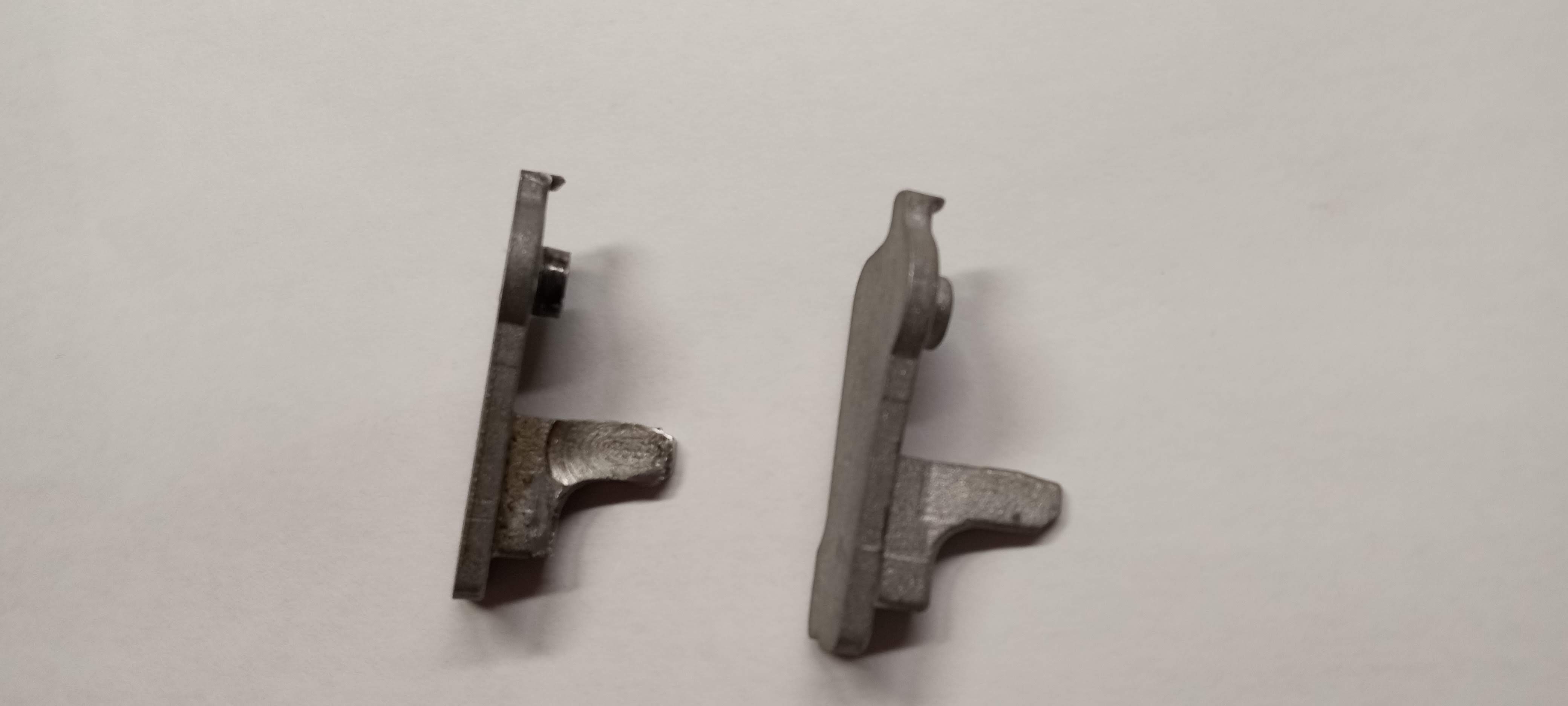

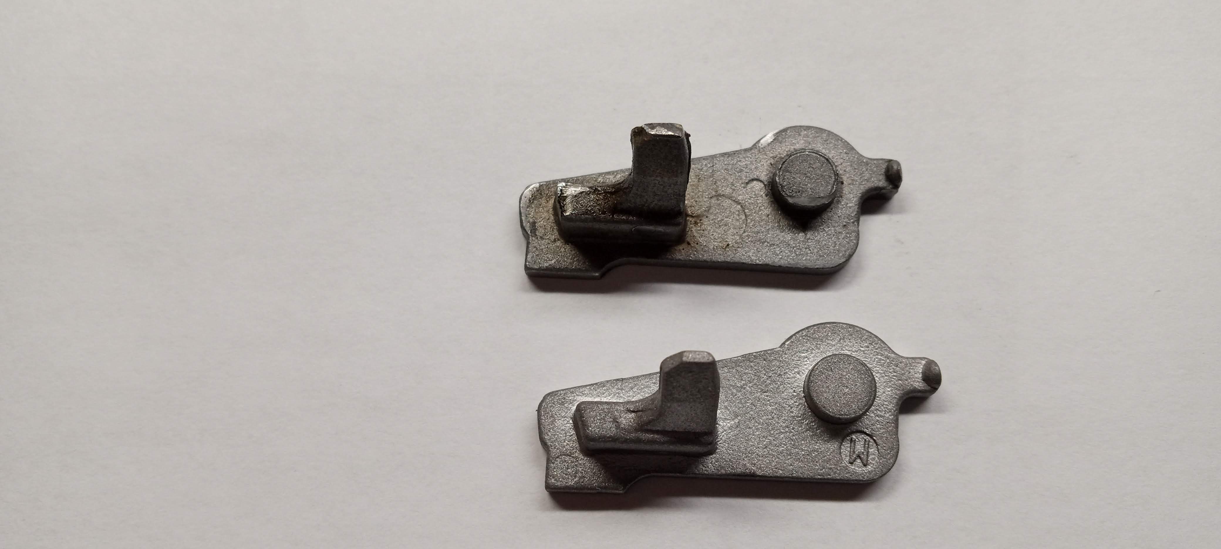

This thread may be long dead, but in case anyone else is having ejection issues with Mini-14 I figured I'd post my recent experience. By way of background, I bought a new 580+series 5.56 Ranch Rifle in stainless a few years ago. Immediately I started having ejection issues at the range. Not extraction - the case would extract just fine but wouldn't eject and clear the open bolt. I tried different (factory) mags and different rounds to no avail. I eventually contacted Ruger customer service and they replaced the rifle entirely. The new rifle had the exact same problem (but less severe). I tried everything. Cleaned and lubed. Adjustable gas block. New mags. Everything I could think of. Then I took a really close look at the bolt and ejector bolt stop and here's what I found (see attached photos). The original factory bolt stop looked like some toddler welded it together in shop class. I ordered a replacement part from Midway USA for a few bucks and you can see the difference in quality. Night and day. My theory is that the crappy stop was catching the ejected case too soon before it had space to clear the rifle. Although it was close enough to allow some rounds to fully eject. It could also explain the totally random and chaotic case ejections I experienced (sometimes 30-feet at 2 o'clock; other times 4 o'clock; sometimes only a foot or two). I'm quite surprised that Ruger would allow such shoddy quality to be shipped out the door. I'm equally surprised that they didn't catch this when I sent the first rifle back, but I'm glad to have a fix for only a few dollars and without the hassle of shipping. Hope that helps anyone else out there looking for a cheap fix to a really annoying problem.
