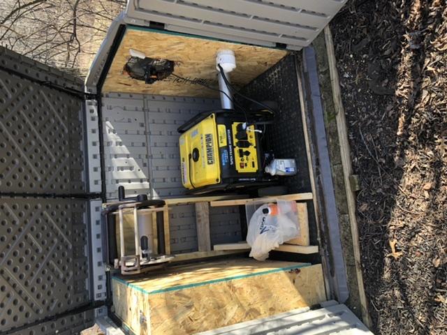

While they are excellent, you can make your own for a third of the price- maybe a quarter. Battery or batteries, 12 volt charger ( or controller if you are strictly solar charging. I installed both) A ten dollar multimeter to show charge level, and inverter. Solar panels extra if you go that way. That's it. Keep in mind the larger the capacity the longer to charge unless you use either a multi-amp AC charger or major solar panels.
Car Battery is $109 each for Exides at Home Depot, Charger is a little over $20, Meter $10-$15, ( Solar controller around $50) , A decent wattage inerter for around $80. So a unit - call it equal to a "1500" for under 4400, with a longer running time ( using 2 car batteries). If you are only solar charging add less than $200 for panels ( contoller sometimes included).
Bubba the "shell" from an appliance like a dishwasher, dryer or washer. Put the insulation (foam board) on the outside.
The insulation can melt if in contact. I built a two sided sound box with single plank across to hold them together ( Who cares about sound going straight up?) I used foam and carpeting to insulate the box ( which should have enough clearance for air flow on the sides) So it's muffled from the sides. Front and back are open. The front would be the opposite side to the muffler and very little sound goes that way. The rear- muffler side I point toward a reflective surface. In my case it's the back of my rear neighbor's garage, which protects that neighbor's home from noise.
Built from scrap, cost nothing, made in 20 minutes. If you want to spend money you can buy a quieter muffler as well, but it may affect performance.

NIGHT TIME ..My genset will run all night on 4.5 gallons with the econo mode switch set to on ..it is in a shed ..that big plywood box is a sound baffle plus it intakes air at the roof line sending the air to the floor for the exhaust fan to pull the air across the genset
I asked my neighbor if my generator bothered him .."what generator" he asked ..as I had it running and the shed closed up we got to with in 30 feet of when he said NOW I hear it
So I run it day or night
