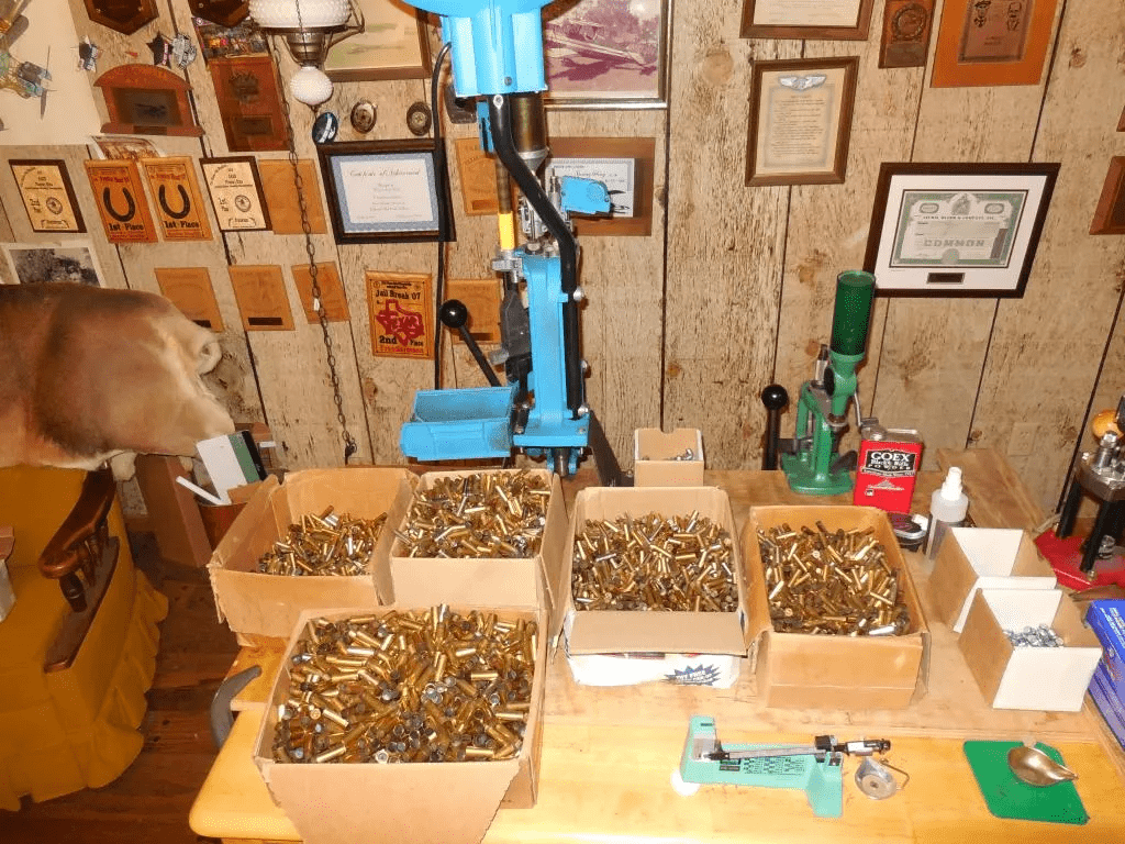

Notice what is front and center. End of story :)
