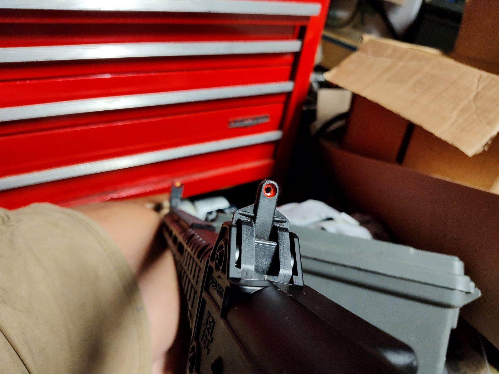

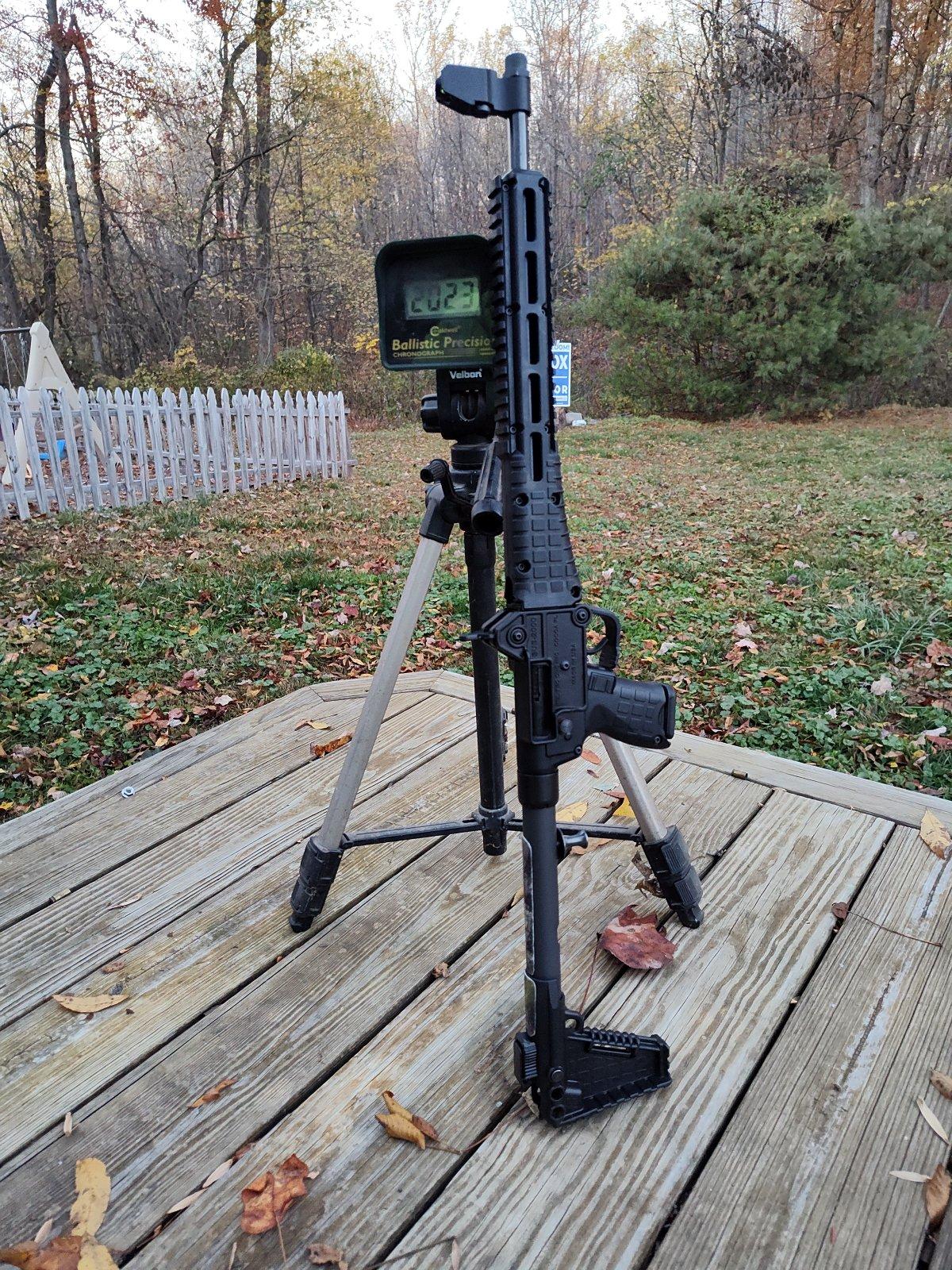

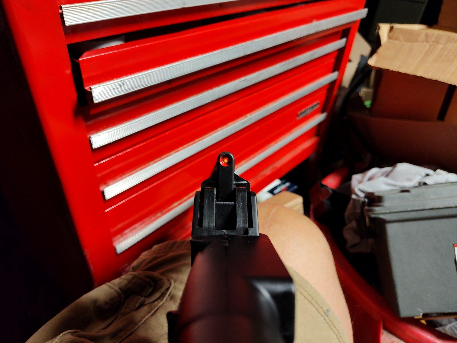

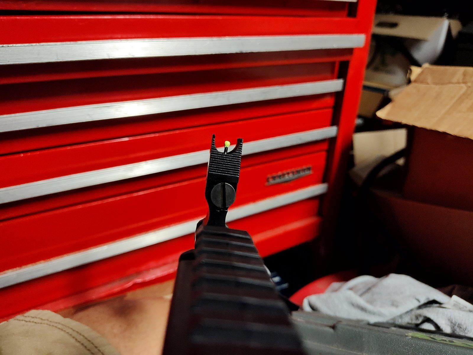

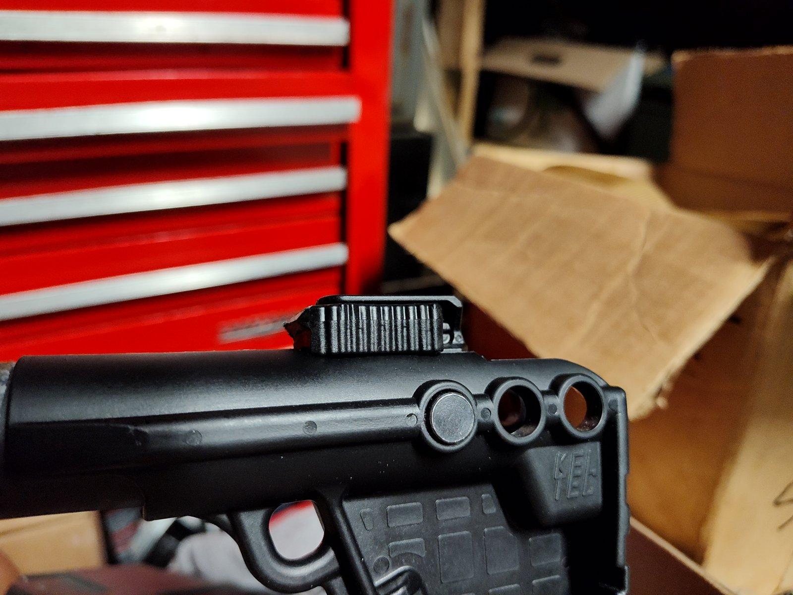

Between the price and $100 rebate and another Will work for Guns and Ammo project . I put a few hundred rounds through it and really like how small it packs down to.
My only negative is the sights are about 1/4" too low for comfortable use but I can fix that wether I make something or get the M Carbo.

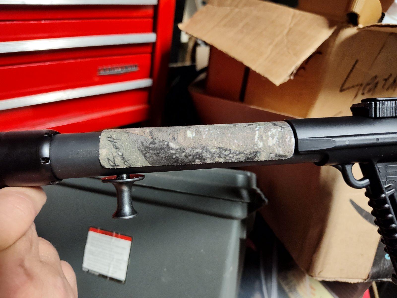

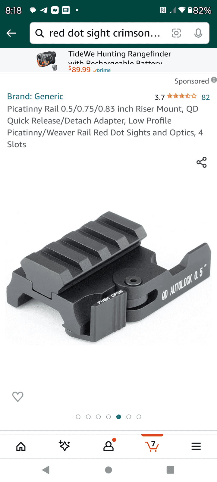

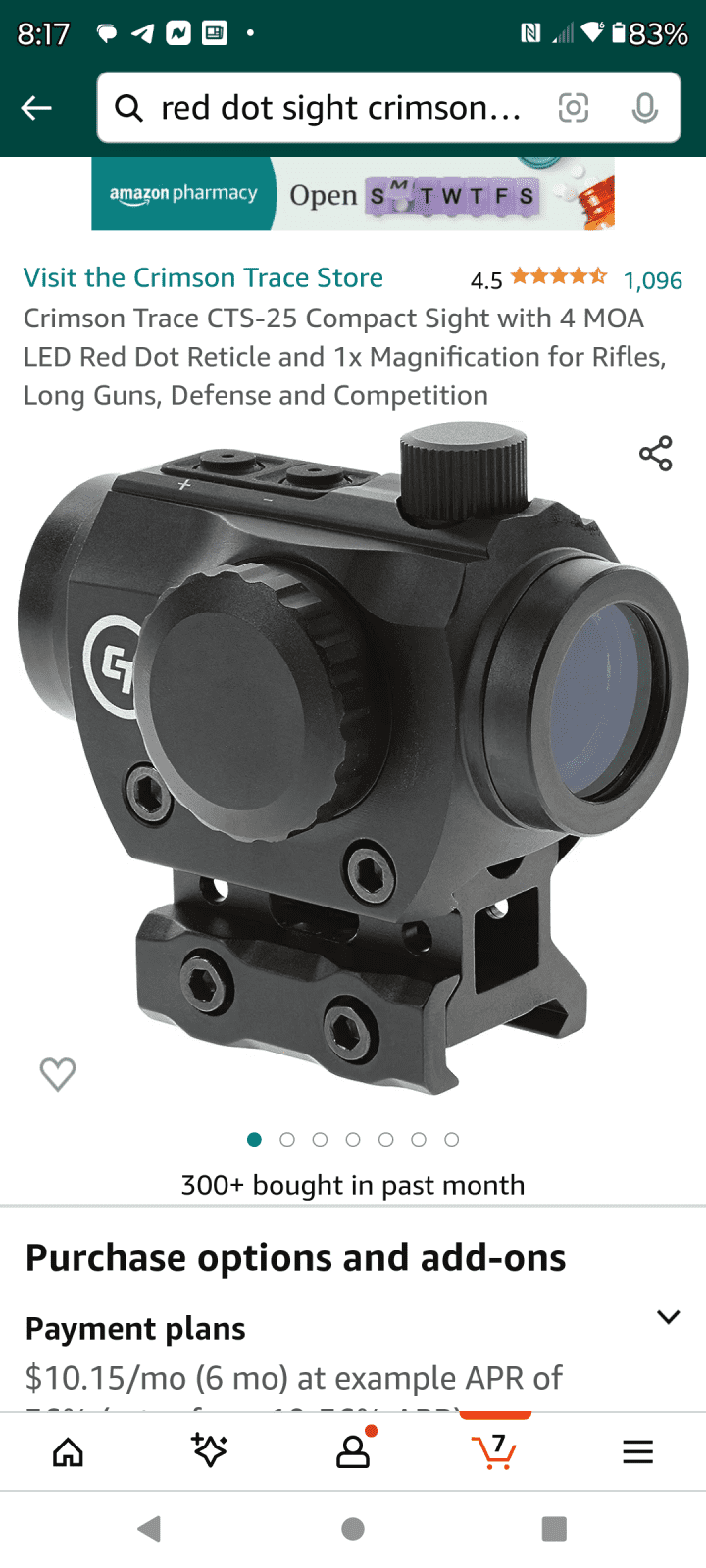

I did add a little hi viz paint to the sights and opened the aperture a little. A piece of Archery Felt on the tube took care of the cheek on cold metal issue. I also beveled the latch so it will release without manually releasing the latch but still stays closed. I've decided a QD mounted red dot will be the way to go and ordered those this morning. I'll probably fab a sling mount and call it good

...My only negative is the sights are about 1/4" too low for comfortable use but I can fix that wether I make something or get the M Carbo...
The Mcarbo sights are not cheap - with your skills, you should be able to make something better than Mcarbo in short order, with about $1.50 worth of materials!
I had mine at the RF meet. I wish I'd have known you were interested.
The original rear sight is way too low. The MCARBO sight is infinitely better. I have the notch, and if you tighten it just right it will flip up like the original. To me a peep is too slow for fast shooting, but to each his own.

If you do decide to buy one of the Mcarbo sights, be aware that their notch sight is not intended to be used like a similar pistol sight (with the top of the front sight level with the top of the ears on the notch). They apparently view it more as an open-top aperture, with the front sight post centered in that big rectangular opening. You probably could use it like a traditional pistol sight, but you might need a front post (AR type) taller than anything I've ever seen. If I had it to do over again, I would get their round aperture rather than the notch.

The 200rnds I put through it were about 4-6" low at 25yds but reasonably well centered. Rapid fire at 25yds was about an 8"group. Perfectly adequate for what it is. Once I notch the sight and get the Red Dot I'll wring it out on the bench with a half dozen different loads.

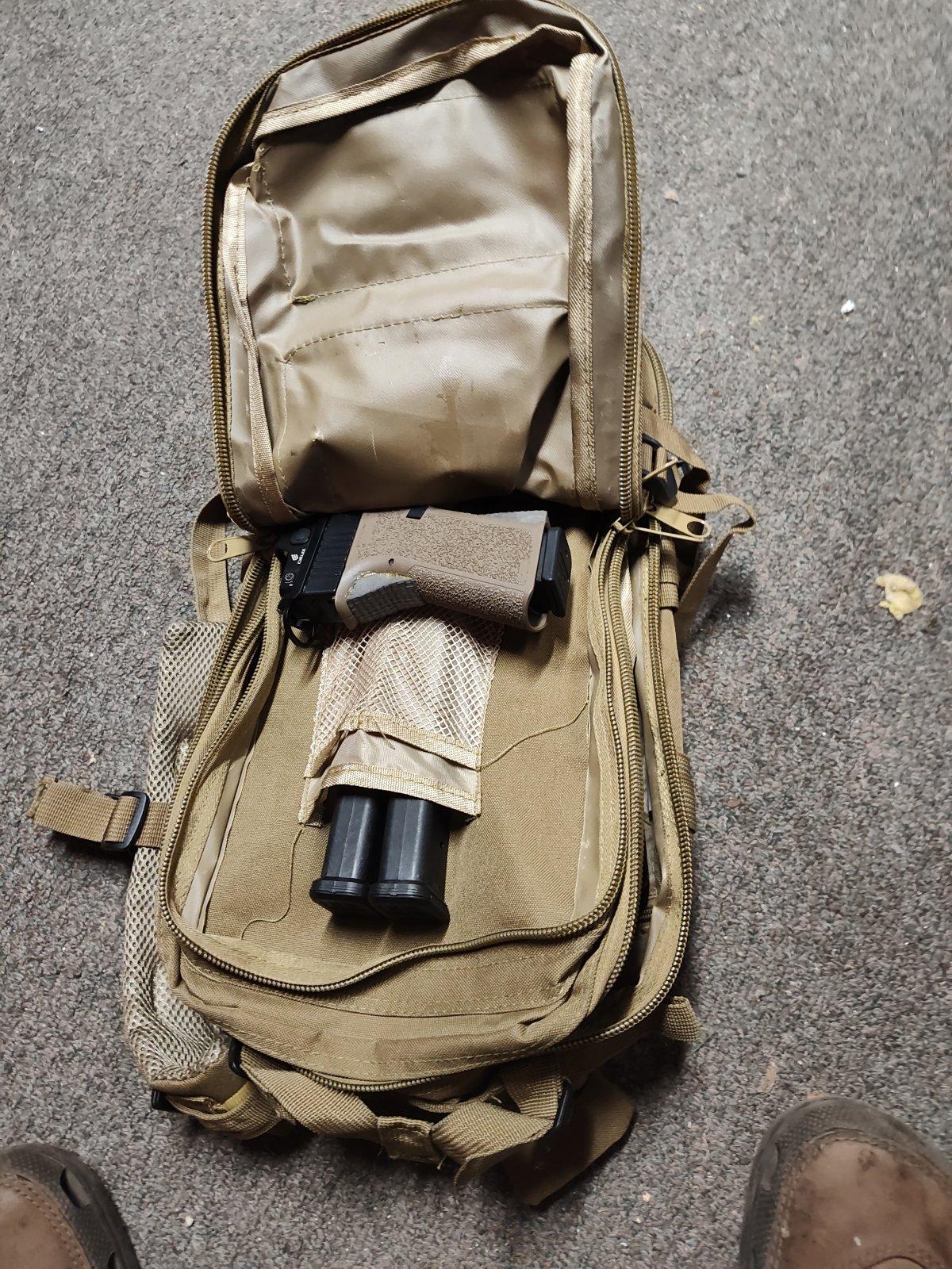

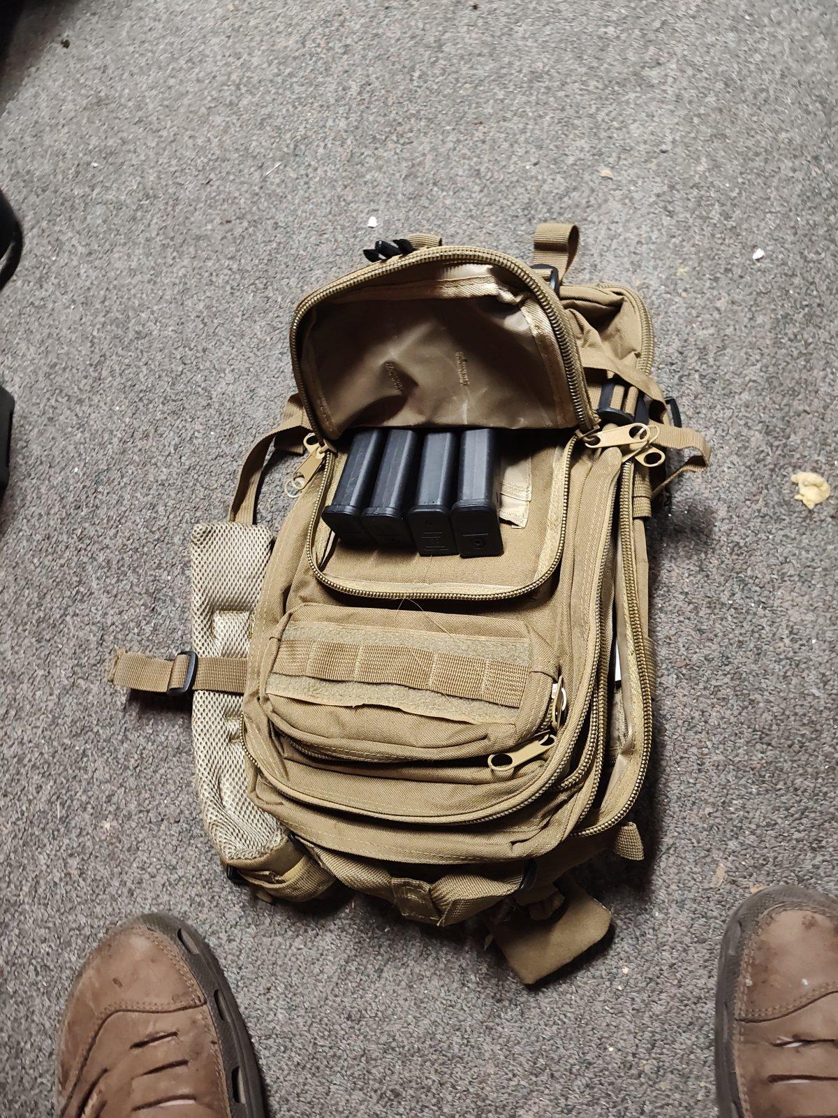

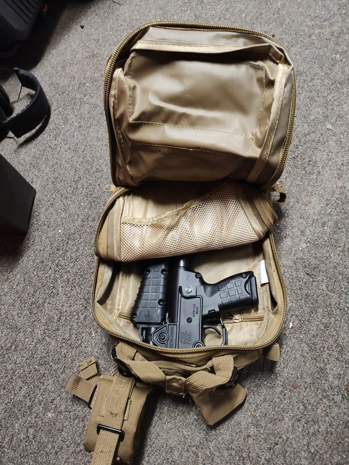

I ordered a nice looking tactical pack from Sportsman's Guide years ago for a stupid low price. When I got it it's scaled for a 3 year old. The Sub 2000 fits perfectly in the largest compartment. I'll probably keep it and the Dagger together in it with a handful of mags. I have an old pass around pistol scope I can put on it for giggles as well with a QD mount. My other 9mm Carbine is solid to 150-200yards with the scope. These could be the perfect grab and go combination???

I would add white lines on each side where you want it to line up. Maybe take a Dremel with a cutting wheel to make notches to hold the paint.

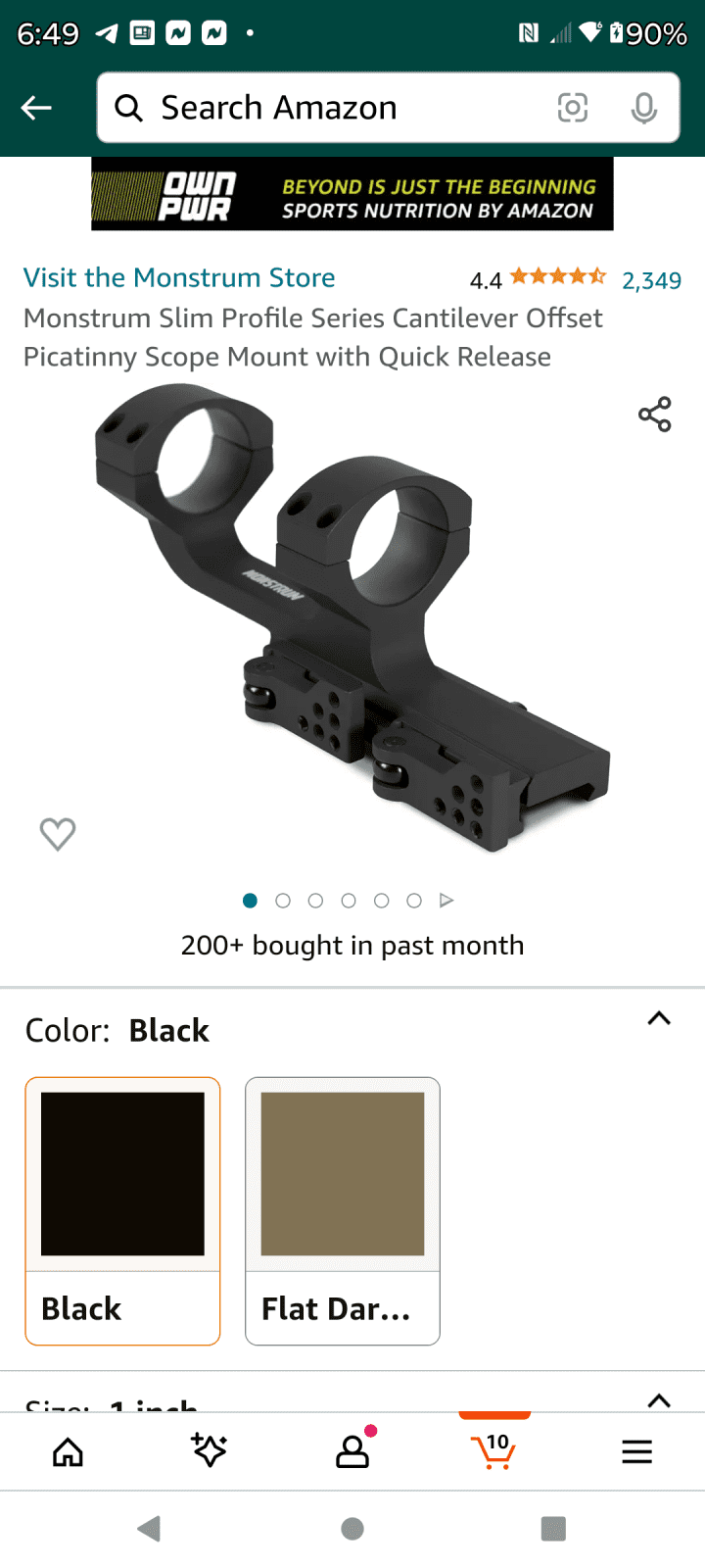

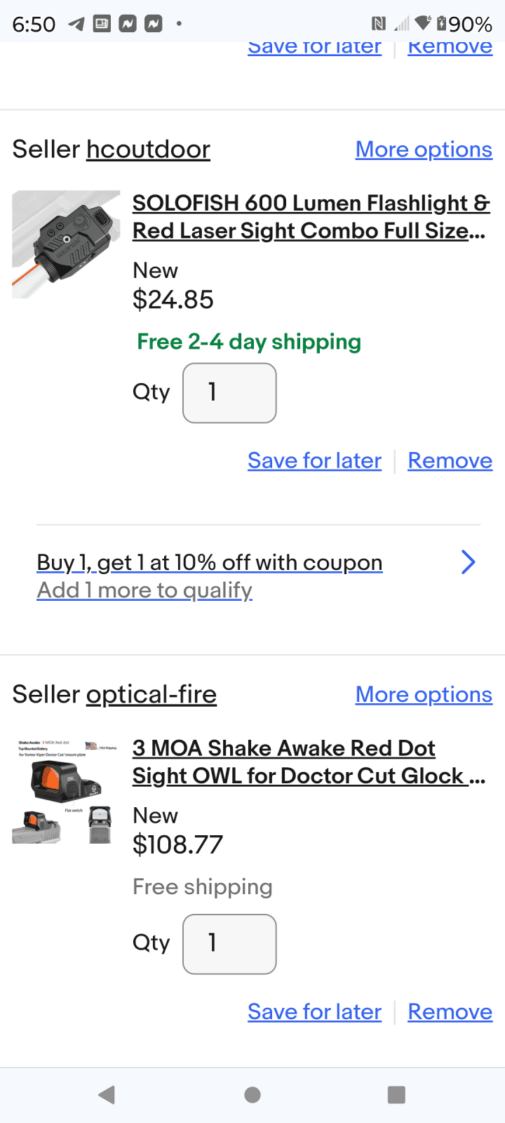

I'm ordering lever throw QD mounts for the red dot and pistol scope. I will keep the red dot on the bottom rail while folded. It'll only take a few seconds to swap after unfolding.
That's a great idea - keeps it attached to the rifle (so it doesn't 'wander off'), but out of the way for folding. The RDS I bought came with a QD mount, so I'll give that a try!

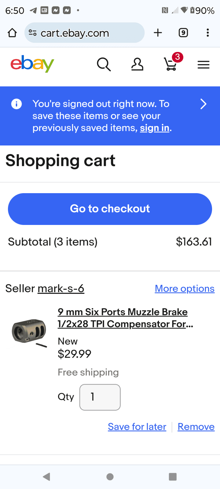

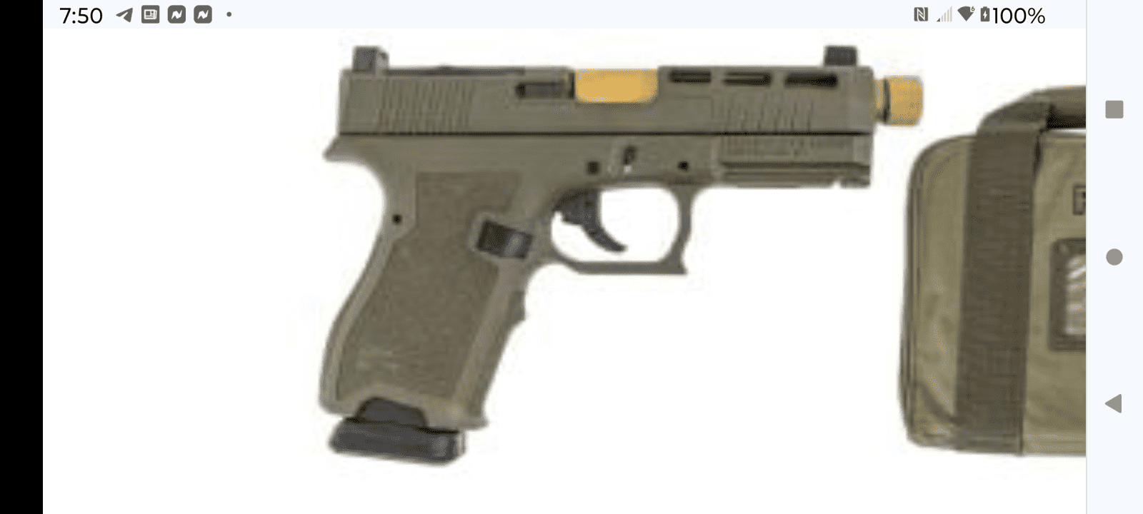

I decided to add a fully decked out PSA Dagger as a companion gun.
The Daggers get great reviews overall (I like mine ;^), and PSA claims they are Glock gen3 compatible, but they have a few issues for folks who are not staying with 9mm. Apparently PSA only tested the frames with 9mm; FWIW, I believe some other "name brand" auto pistols have had frame-cracking problems when the factory reissued/converted an existing 9mm model to .40/.357, so that lack of testing adds a big question mark. One writeup on another forum pointed out that Glock 23 factory slides won't even fit on a Dagger frame without binding, unless you replace or modify the Dagger trigger bar (so much for "gen3 compatibility"!). And if you read the fine print, the PSA lifetime warranty is void if there are any aftermarket (non-PSA) parts installed, or any PSA parts have been modified.
So, they're a great option if you want a 9mm, but they are definitely not "gen3 compatible" in the same way that Glocks & some other Glock clones are.
As always FWIW, YMMV, IMHO, etc.
