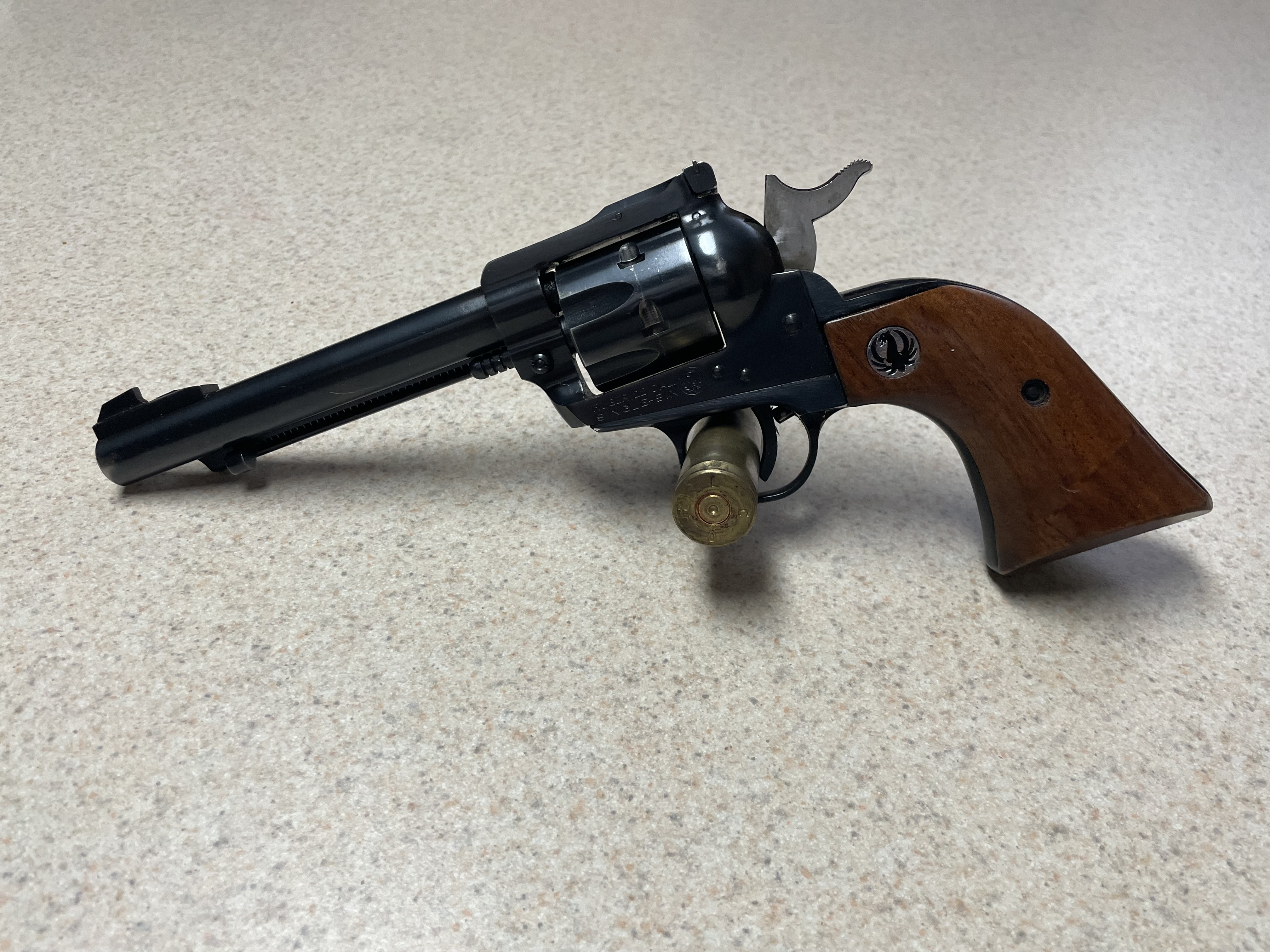

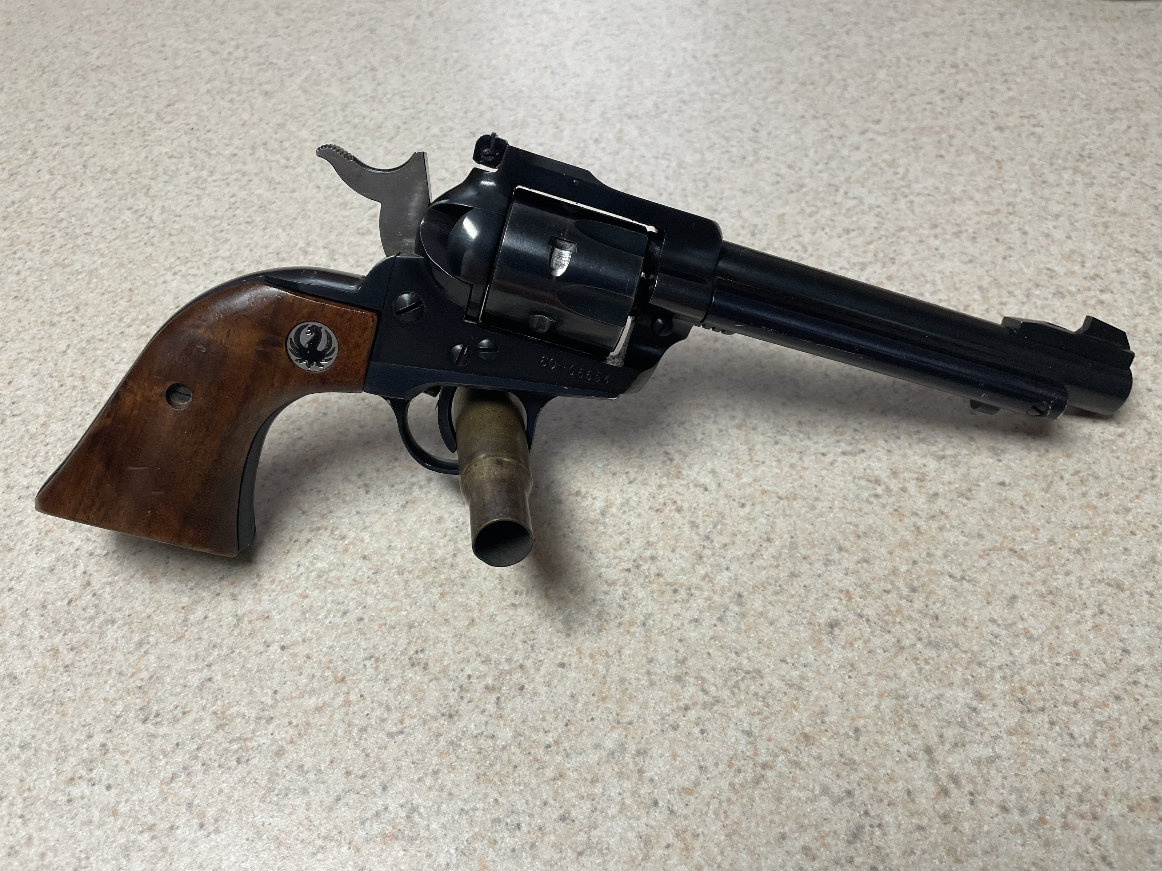

And I find this 3 Screw Super Single Six from 1970. It was another one of those that I let slip away from me a long time ago, and how there is one to fill that hole. Not the same one, but exactly like it. It hasn't been back to Ruger as it's not converted. I'd love to send it to them for a replacement .22mag cylinder, but then they'd convert it with the newer style safety crap. Maybe I can find one and get lucky it times correctly, who knows?

That's a great find. Great condition! And the first thing I noticed was the cylinder latch is perfectly fit to the cylinder notches. But to minimize the line around the cylinder I always polish the top surface of the latch (which is left rough at the factory).
