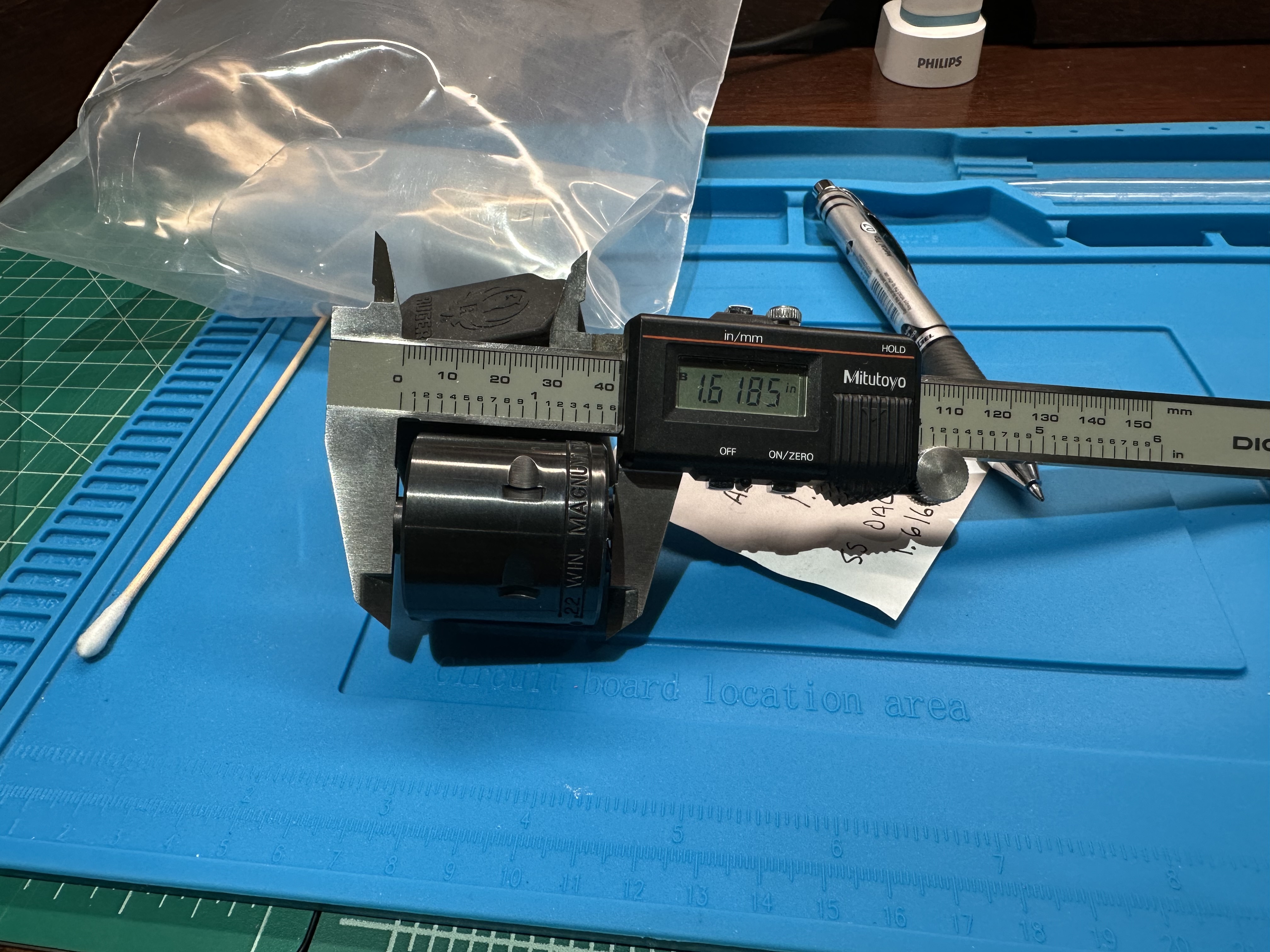

See photo, caliper is across maximum distance across cylinder boss and ratchet flats opposite end. Reading/results are 1.6185”.
This is a NM 22 WIN MAG cylinder.
Is this the correct way and place to measure this?
Much appreciated!

Well confusion can rear its ugly head.
That would be the way to measure a cylinder for buying, selling and fitting to a different gun.
But for reloading one would just measure the cylinder length minus the ratchet and gas ring.
This can be important for OAL with long, heavy bullets.
Just sayin.

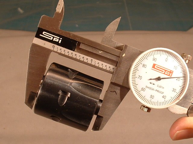

Thanks 'DGW" that picture was from back when my camera, as well as my "Numb" fingers worked.....:cool::rolleyes:
