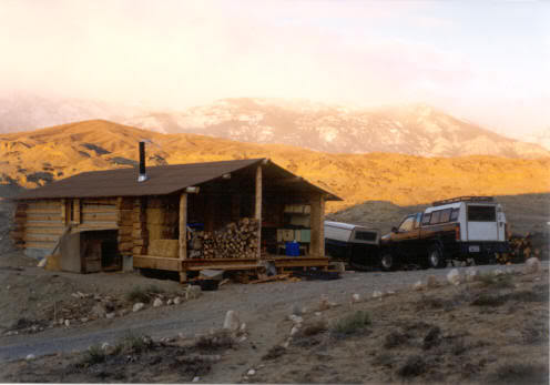

14x18 cabin, behind it is a small shop/storage/reloading room, to the right is the bath house. pantry, temp reloading room. Porch is 14x 6 ft deck, lots of roof overhang all around. Have started an addition that will double the cabin size, then disabling back injuries, and......
16x20 cabin. The numbers dont seem to indicate it, but theres a significant increase in living space from the above cabin. 18x24 would seem extravagant. All one open space other than the bathroom. I think making too many rooms in a small space isnt a great idea.
