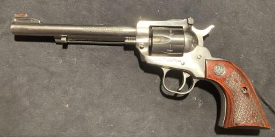

So took a nice older NM Single Six to the range this morning.
Gun was was thoroughly cleaned before hand.
First experience with a NM Single Six, 22LR and 22 Mag.
Tested a few different brands of ammo.
All groups shot at only 10yds., avg. for 6 shot groups
First .22LR:
First: Win. 555 Bulk 1.69"
Second: Mini-Mag HP 1.23"
Third: Blazer .95
Fourth: CCI Standard .72
Second: .22 Mag:
I fired three different brands and types, they were all bad.
Averaging 4", Shotgun Patterns :(
I really want to like it but the accuracy seems sub par.
I know about the Compromise bore size, but is this the norm for a Single Six ?
.22LR groups .67 and .78
.22 Mag is 4.020 :shock:

Hylander - Just my thoughts....if the revolver was purchased used, see if the 3 etched digits on the 22 Mag cylinder face, match the last 3 of the serial number to see if the cylinder is original to the revolver. If you have a way to measure the cylinder throats in comparison to the LR cylinder? I have 2 different NM Single Sixes dual cylinder models, a 2016 SS with a 4 5/8" bbl, which I purchased new, and a 1990 Blued model with a 9 1/2" bbl, which I picked up used - original box and cylinders, but in very nice condition about 6 months ago. I shoot more 22 Mag ammo thru them, than LR, but I'm a fan of the Mag round. I'm not the greatest shot, but both will go into 1-1.5" at 25yds of a bench and bags, if I do my part - most recently that was with CCI Maxi Mag JHPs. I will say that both have Belt Mountain base pins, which seemed to make the action much "tighter". I did not do any testing with either one, before I swapped the pins, so I have no before and after comparisons. If it shoots your LR well, then just my guess, that it may be an issue with the Mag cylinder. Hope that helps - Bill in MA
msp2640,
The mag cylinder is not matched to the gun. I think it is from a 3 screw as it is fluted. All measurements are proper, lockup is tight. Pretty sure timing is off.
It's funny you mention that, as I'm a fan of the fluted cylinder look vs the non fluted look. After receiving the blued long barreled model, I started to look around for a fluted cylinder, purely for the look. Sticking to the old adage, shoot it first before making changes - I highly doubt a different fluted cylinder would shoot better than the factory non fluted model on mine. After firing it the first few times, I gave up the idea.........doesn't mean I gave up the thought of having the Mag cylinder sent out to have it "fluted" but probably not worth the cost, rebluing, which probably won't match and it would most likely shoot exactly the same! I have read here, that early NM Mag cylinders were fluted as well until 1975 or so, but I'm not sure where I got that info. Thanks, Bill
I have several convertible single sixes and they all shoot well with the magnum cyls. Better with some ammo than others
First you need to fire 4 rounds from each chamber with a separate target for each chamber. That'll tell you if you just have a bad chamber or a couple of bad chambers in the mag cyl.
If you're flinching when shooting the mag ammo because of recoil, noise or both, or even if you're not, have someone you know that shoots well, shoot the gun from a bench rest.
Let us know the results and we'll go from there for solutions.
If the cyl locks up on each chamber when hammer is cocked and you don't have lead spitting from the barrel/cyl gap, you don't have a timing problem.
Are there any numbers at all pencil engraved or stamped on the front face of the cyl (use magnification and clean the surface to see them)? It could be the original cyl, why do you think it isn't?
Serial numbers are not full proof for when the gun was made. Fluted mag cyls were shipped in guns at least thru 1976 and some even later.
No bad chambers, I did test each one
Shooting is from a solid rest.
No flinching, I shoot 44Mag with full house loads and group under 2" at 50yds. (Scoped)
45 Colt 2"-2.5" at 25yds open sights.
Lead does Spit with the Mag Cylinder, hits me in the face.
I finally got a chance to check with an Endoscope and timing is off.
Not original, it was acquired separate from a different source.
I think you meant no bad chambers.
But what does that mean? To me that means each chamber grouped it's 4 shots well, either in the center or off center but still tight. Or did every chamber scatter the shots all over? What were your groups like?
The timing is not off, each time you cock the hammer it rotates the cyl to lock up, right?
It sounds like you have a cyl misalignment problem, therefore the lead spitting. You can not correct that with timing. It's a bad cylinder! The cylinder notch locations are not machined in alignment with the chambers to position them in line with the barrel.
Is the lead splatter on the barrel forcing cone all at the same point; 9 o'clock, 3 o'clock or?
Sorry, Yes I did and corrected
Yes
Yes Misalignment, I used the wrong terminology.
Sorry, did not check that, but got hit in the face with spatter.
Thanks for the input, I am learning a lot.
