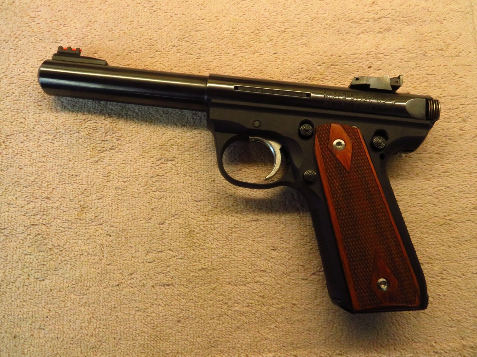

My MkIII 22/45 came with the molded-in plastic grips (ugh). I had a friend machine these off and install two threaded inserts on each side so I could pick any 1911 grips I wanted. I had a local 'smith install the Volquartson kit and I put on a fiber optic sight set from Ruger. Dead nuts accurate and totally reliable, really turned this handgun into one of my favorites.
The 22/45RP (replaceable panels) model just came out when I went to buy mine so all I had to do was get replacements (see above) made in burled walnut.
