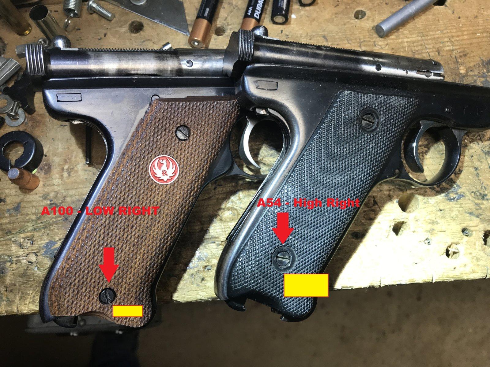

Remove the grips and look at the frame to see if it says A100 or A54. That will tell you what grips to look for. I'm not near mine right now and I'm sure someone will be along and give you a more complete answer. If not, I'll write more tomorrow. I wonder if someone built the gun from an older frame with the 200th upper which would have been made in 1976.
As Ron has mentioned,, you need to pull the grips, and see if it's an A54 or a A-100. By 1976,, it SHOULD have the A-100 frame. But often,, parts are swapped around.
Hold the gun in your hand. If the left side bottom grip screw is lower than the right side, you have a A54 grip frame. If the right hand bottom grip screw is lower than the left side, then you have a A100 grip frame. Grips with the lower right side grip screw are the correct ones for a 1976 Liberty gun. I have owned a lot of A54 grip frame pistols and have never seen one marked A54. I have owned lots of A100 grip frame pistols and they were all stamped A100 on the left side of the grip frame. I am currently building a 1976 4-3/4 inch Liberty upper to a Mark 2 lower. Maybe somebody here can post some pictures of A54 grips and A100 grips to make it easy to understand.
Easy ID. Right side grip panel tells all.

Note. Ruger Mark 2 grips will fit a A100 Mark 1 frame, but you need to put a small spacer under the left grip panel in the area where the hammer pin is located to keep the hammer pin from backing out of the gun and locking up the gun. The Mark 2 hammer pin does not fit any Mark 1 frame. I believe you can also use Mark 3 grips on a A100 Mark 1 frame pistol by adding a spacer to keep the hammer pin from backing out. The area that needs the spacer on the Mark 2 / 3 grips is the top right corner of the left grip panel.

Correct. The mounting screw spacing is the same once the A-100 frame came out.
You don't even need to see the gun or grips at all to identify the frame. Just look at one of the magazines. If the loading button is on the right side, then the frame is an A-54. If it's on the left side, the frame is an A-100.
Very true, unless the magazine isn't available....
