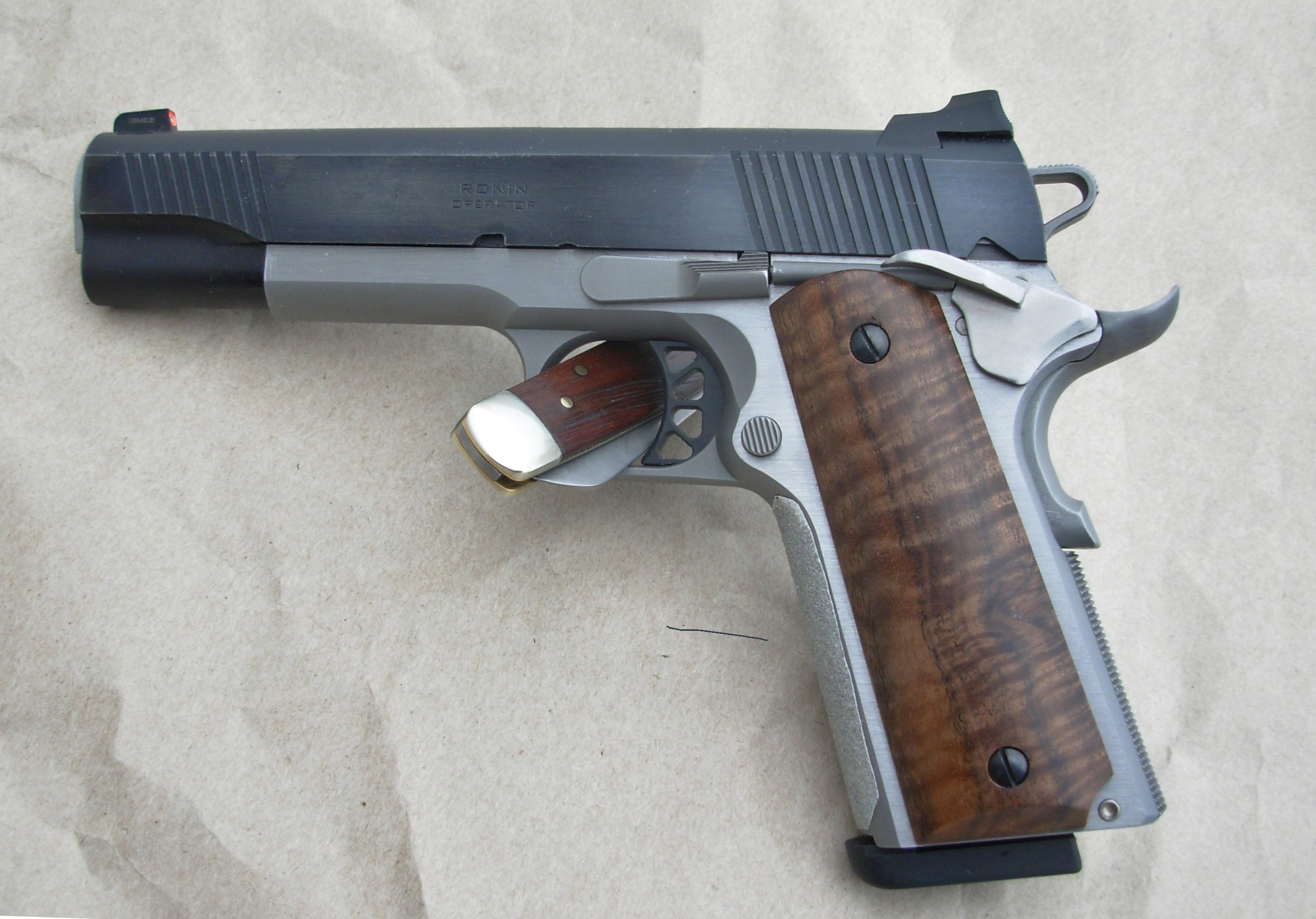

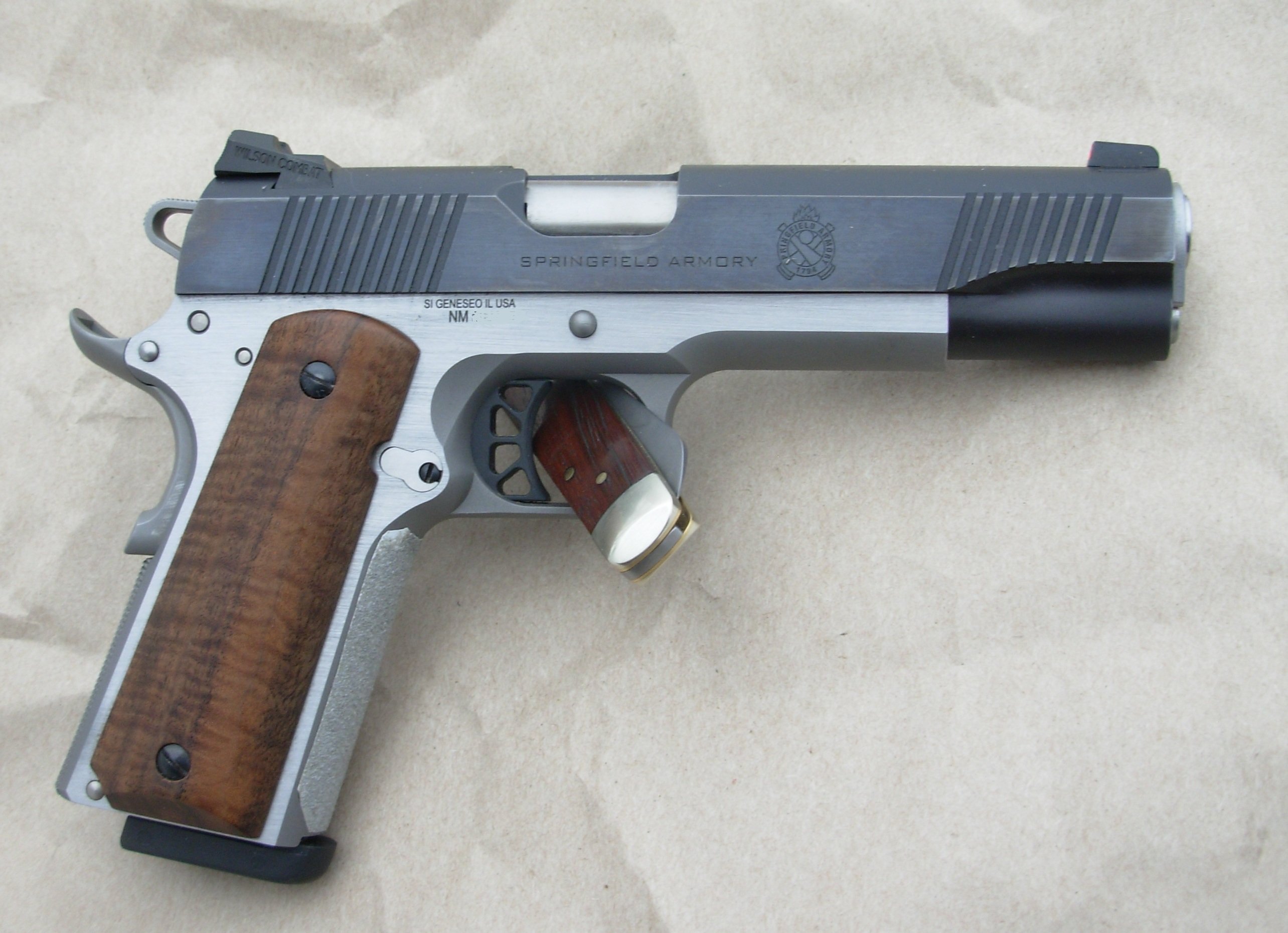

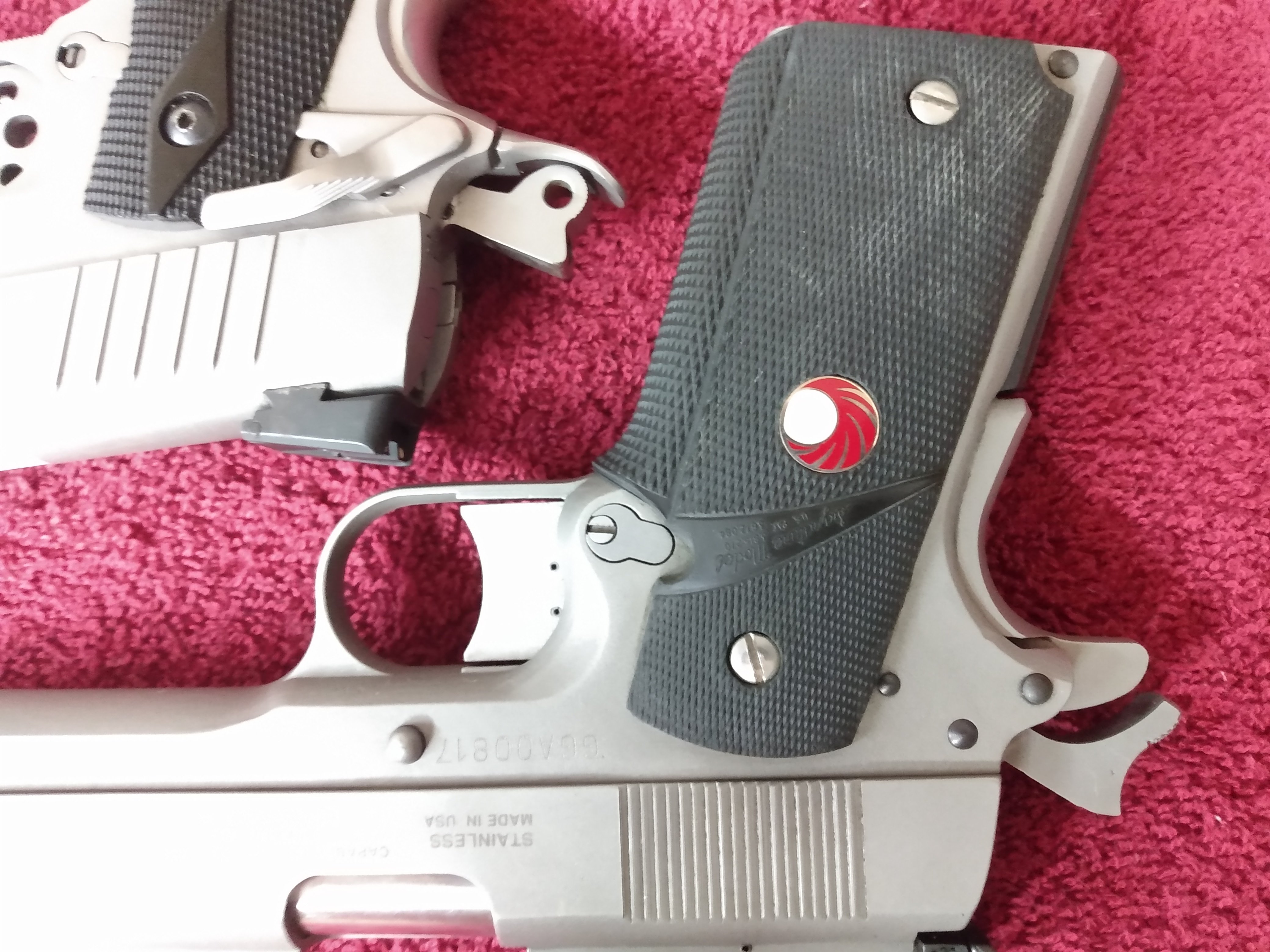

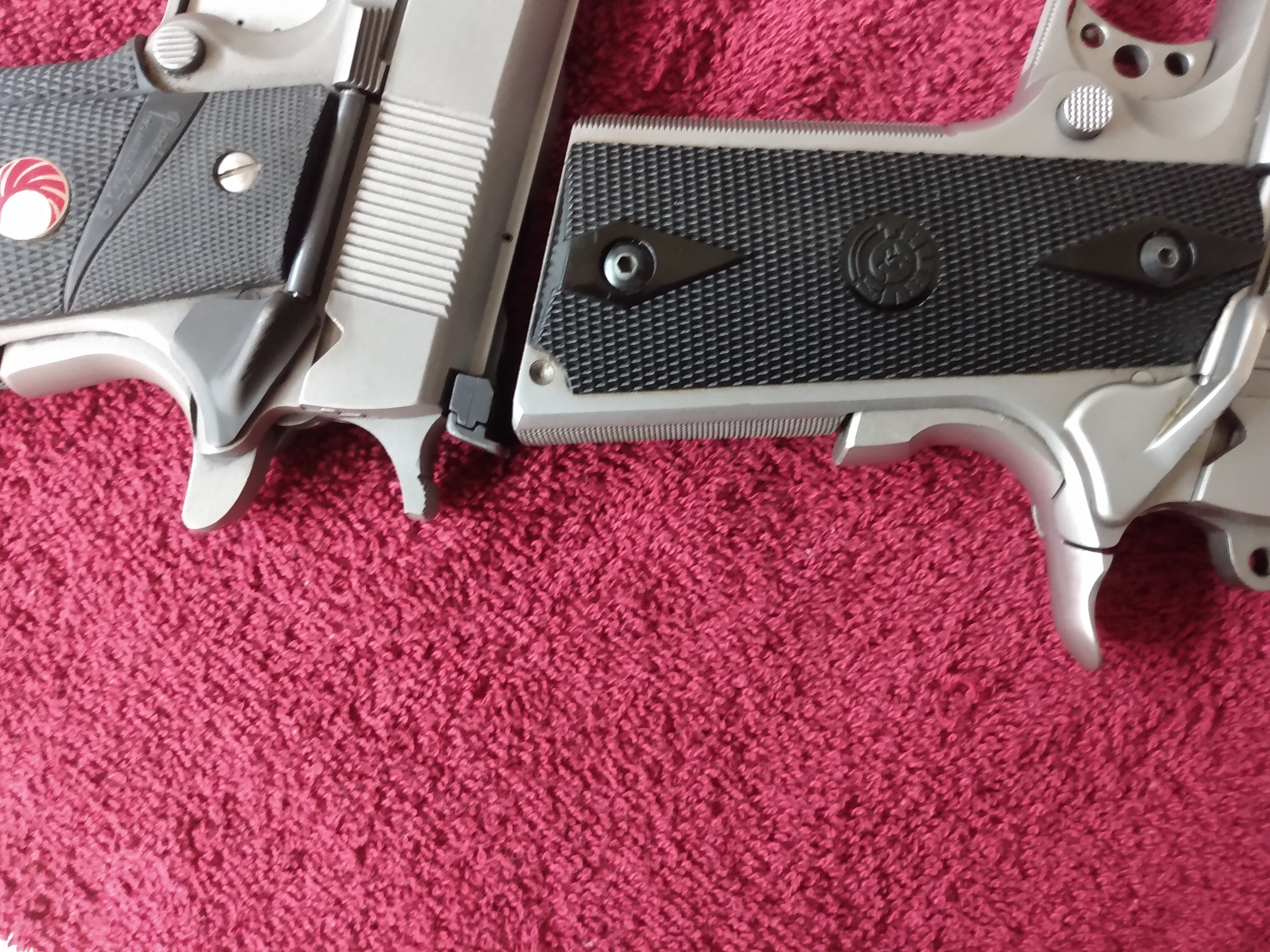

Pictures are worth a million words.

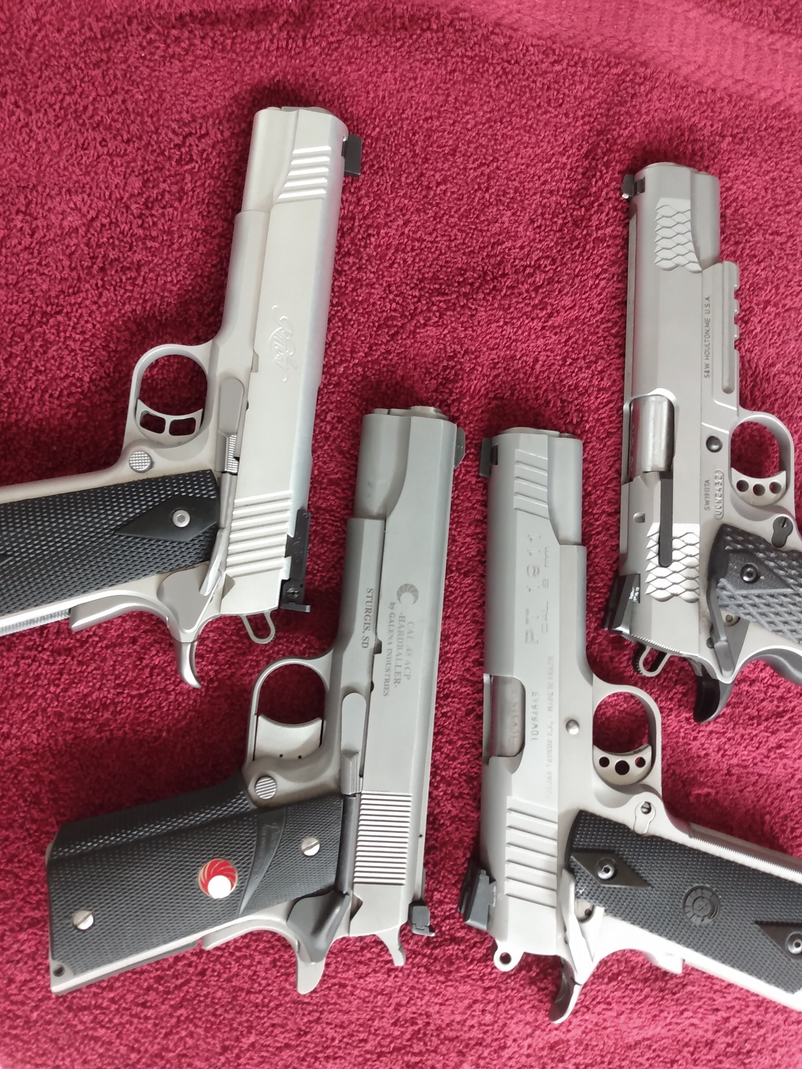

Beavertail vs 1911A1

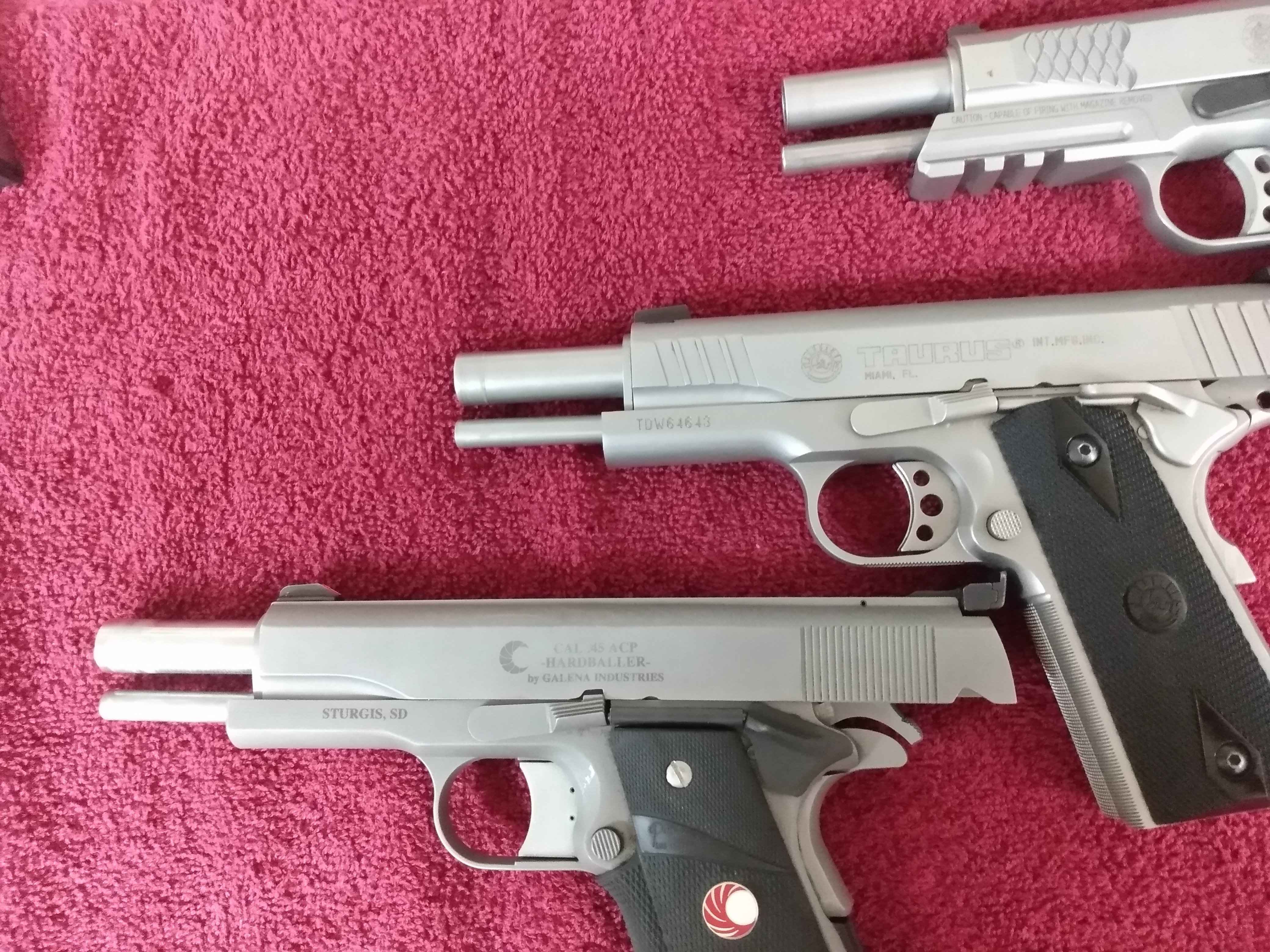

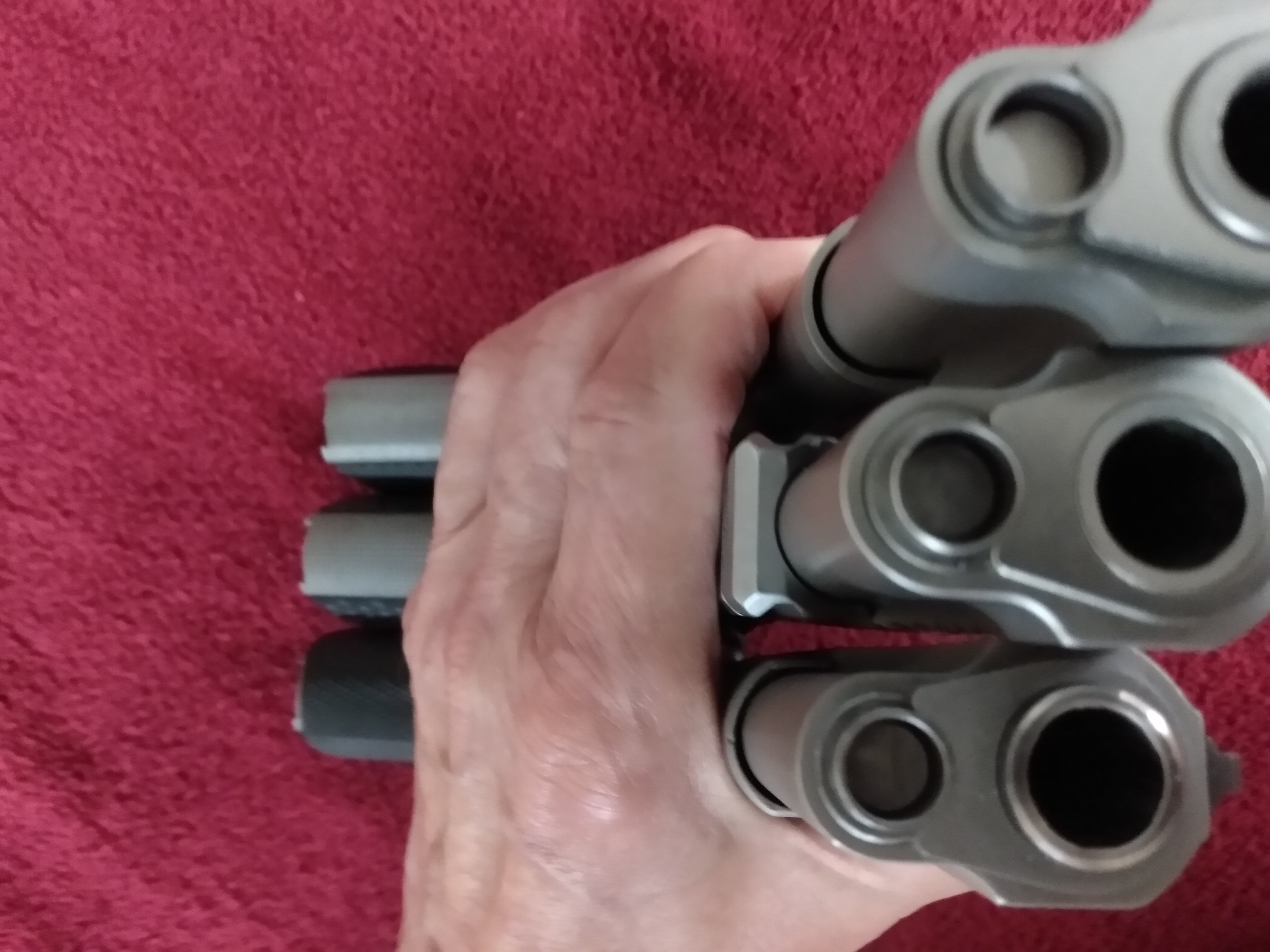

Full length guide rods.
Recoil spring plug that allows full length guide rods to travel (circular cutout)

Notice raised square on grip safety to ensure weak grip can deactivate. I've had more than one shooter fail to deactivate the flat grip safety on the 1911A1 AMT.
Different flavors, but in my opinion the S&W 1911 with external extractor is the most advanced of the group. YMMV.
The Kimber and AMT have Bomar Style adjustable sights. (Old School)
The Tarus and S&W have Novak sights.

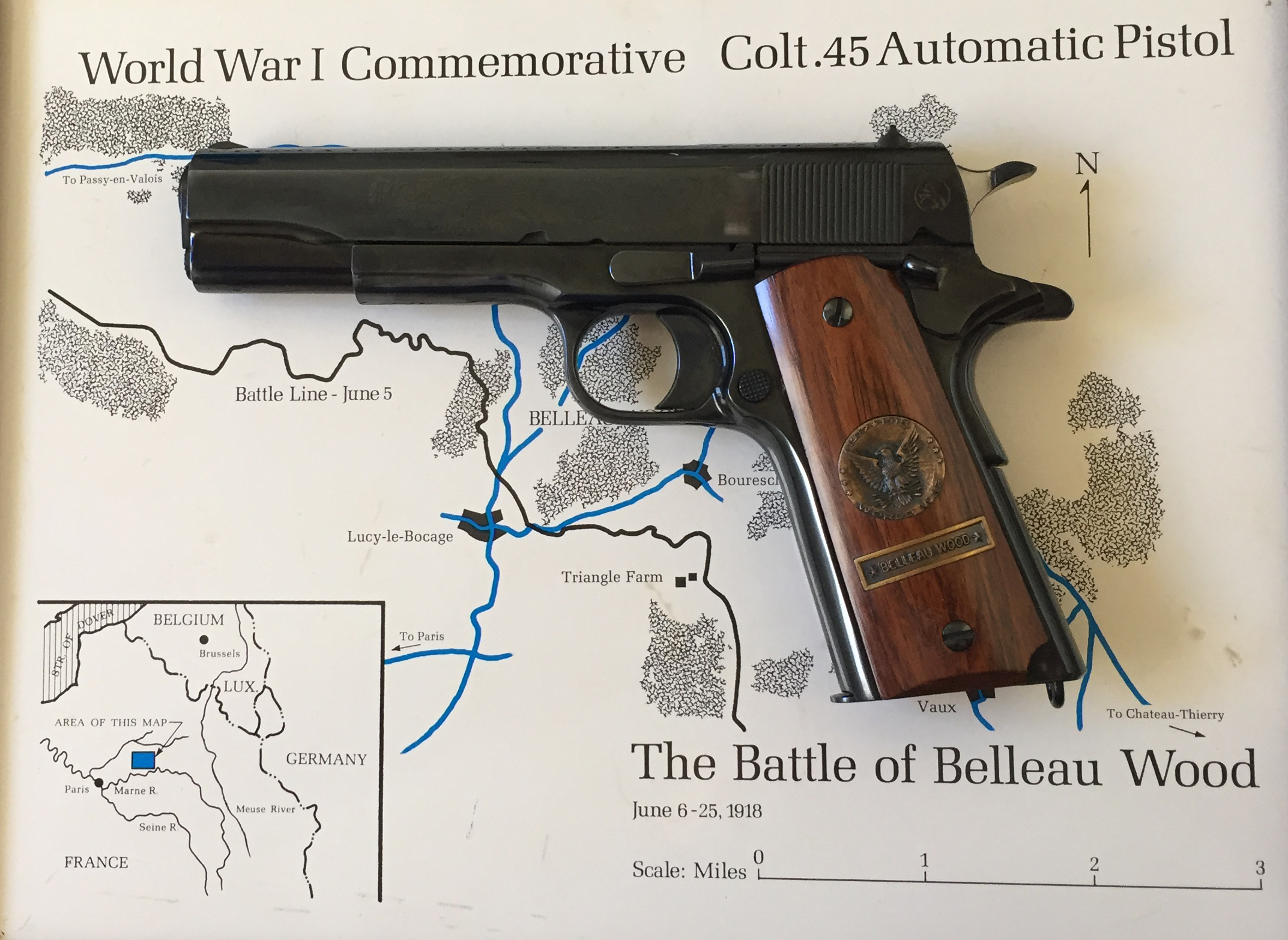

Bookends of a distinguished service.
One of the very first issued in WWI and a clone of the last 1911 issued tge M45A1
Neither has a FLGR.
Beavertail grip along with raised square on grip safety. Enlarged operational controls, Novak Sights. Seems even the USMC requested some FLUFF on their peanut butter pistol? LOL 😂
Does that make the M45A1 a Fluffernutter? 🤔
