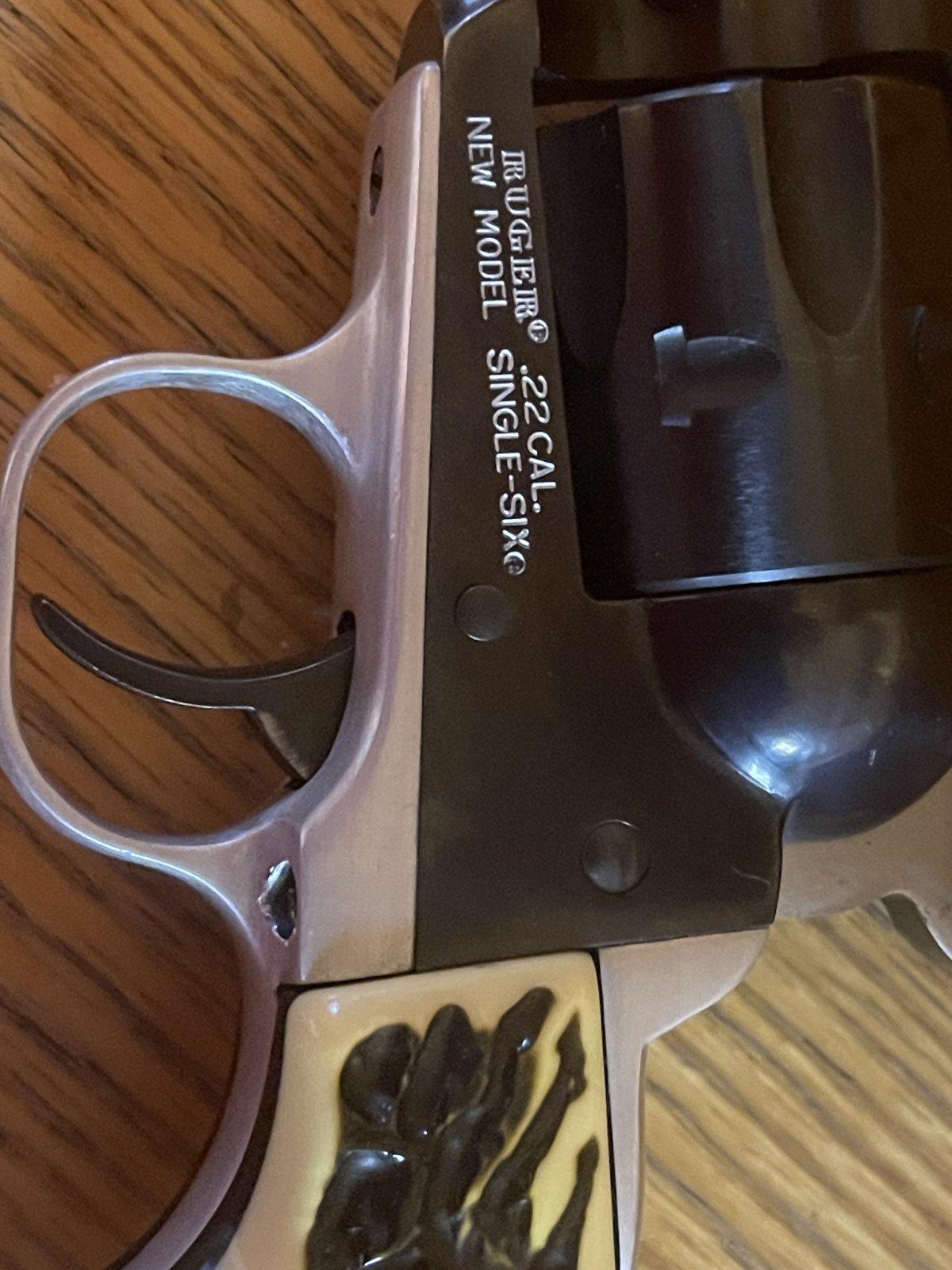

I have a 1970s Buntline single six. The lower portion is made of light weight aircraft aluminum. It also has stag pastel grips. I once found it in a gun digest and it stated that only 500 or so were ever made.Looking for any further information on the gun.

Welcome to the Forum,,,,,,depends on what the serial number may be, but to us it looks like a stripped aluminum (ALcoa) frame, on a regular steel cylinder fame, with Jay Scott plastic grips............:unsure:;)
yes, the housing is also "stripped" (same metal alloy)........
cannot get a clear zoom in of the serial number,BUT that being a "New model" and from you say the "1970s" it should have been in a red,white new model box and the LONG barreled 9 1/2 inchers were a white box...that yellow /black box is from the 1980s that you have pictured.......neat package still(y)

By "lower portion " are you referring to the grip frame?
It looks to me like someone's polished the anodizing off the grip frame and ejector rod housing in an effort to "customize" that Single Six.

1. Because Buntline is not a term ever associated with Ruger firearms.
2. Yes. Your gun is a common New Model Single Six Convertible as the letter states.
Somebody rubbed the blued finish off the frame and reduced it's value.
Excellent accurate shooter though. Should provide you with decades of fun plinking.

hittman is correct.
Your letter states it was shipped as a "NR-9" which is the common 9-1/2" Single-Six convertible.
And as noted above,, the term "buntline" has never been used by Ruger to describe any of it's longer barreled SA handguns.
Also,, the stripping of the coating/color of the grip frame has been done often. Your gun has had it done by a previous owner.

Yes, it is a common New Model Single Six, catalog number NR9, that has undergone some Bubba work to strip the black anodizing off the aluminum grip frame and ejector rod housing. Ruger used aluminum alloy for most of the blue Single Six and Blackhawk grip frames from 1953 until the present, and then started using aluminum for the ejector rod housing starting in about 1964. The grips are also not original Ruger, and has been stated, they look like Jay Scott fake stag grips. If it were unmolested, it would be a $500 gun give or take. But with the modified grip frame, ERH, and aftermarket grips, it is worth whatever someone will offer (I would think around $400). The 9.5" barrel is less common than the 5.5" or 6.5" barrels, but far more than 500 were made. The Gun Digest may have been referencing the old model XR3 grip frame Single Six with the 9.5" barrel (model RSS9). That was probably made in about that quantity. Then the XR3-RED grip frame RSS9 and RSS9X convertibles were probably made in higher quantity, and even more of the New Model NR9s (which are still being made).
