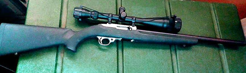

Top pic is as the gun was given to me. Ruger 10/22 with Clark 20 inch barrel and Simmons 8 X 34 scope. Trigger was stock and toughed off at 6.5 pounds as measured with my Lyman Digital Scale. Accuracy is fantastic.
It's very heavy and I wanted to lighten it up.

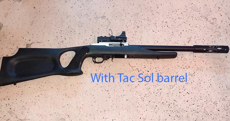

Picture 2, I think it's complete: Tactical Solutions 16 inch barre. ( 5 inches of rifling ) false silencer. C-More Railway red dot sight, BX trigger ( 2.5 - 3.3 pounds) still too knew to get an exact reading.
Build was pretty simple except taking off and reinstalling the barrels. Very tight so I used the method Volquartsen show by using a heat gun to heat up the receiver and then putting the new barrel on. Took a lot longer than I thought and a little encouragement with a rubber mallet to get the barrel in all the way.

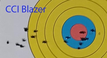

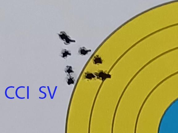

Groups are what I would expect at 25 with a red dot sight and 12 MOA dot. Just a pad in the center of the rifle, no front or back pad.
It functions well except I had a few FTFs. Normal with Bulk ammo.
I'm happy with it and can't wait until my first match in two more weeks.
Here's what I grouped today.
