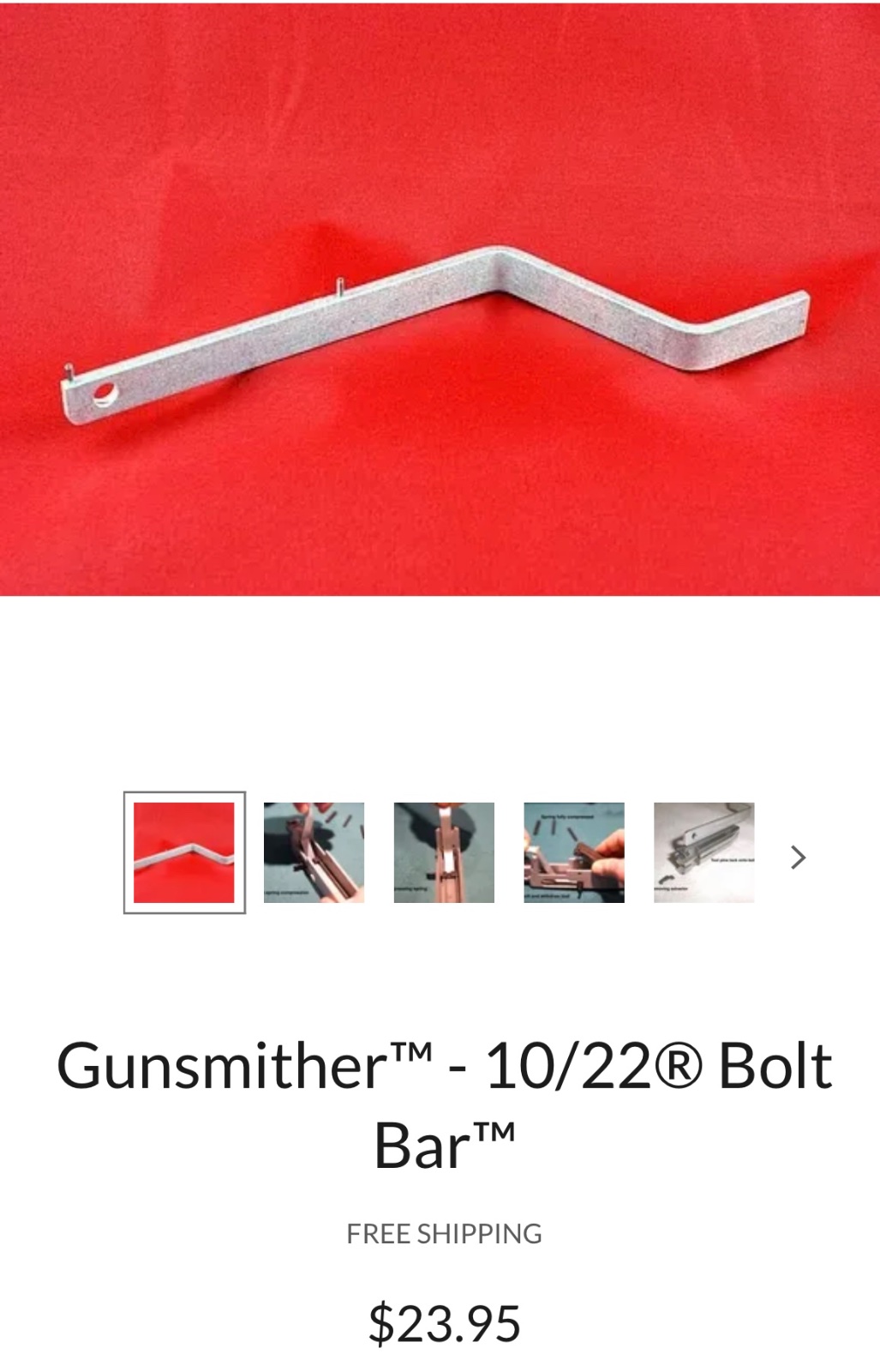

I know this is difficult to debug based on that description, but has anyone else experienced this and figured out why? I've assembled it quite a few times over the years without problem. But, in the past year I've had problems assembling a small number of times. If it makes a difference, I use the bolt insertion tool (shaped like an L) to retract the recoil spring/bolt handle in order to insert the bolt.

I have a couple of questions. Did you change any springs while you had it apart like the hammer spring or anything? Also does it have a scope mounted to it? If there is a scope did you confirm the base screws are not to long and touching the bolt causing the issue? Also I have never heard of the bolt insertion tool that you are talking about would have to look at it to see if it might cause and issue.

Is this the tool?
I have one and it is great.
https://gunsmithertools.com/shop/ols/products/xn-gunsmither-1022-bolt-bar-lcb7302vsa
